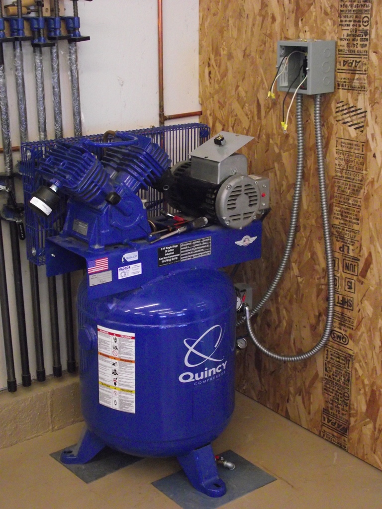

CFM is the issue. As has been said air tools require a lot of air with the exception of nailers. I have a Quincy 4 cylinder 30 gal compressor. It is rated at 21 CFM @40 PSI and 18 CFM @90 PSI. It is 50% duty cycle. It powers my bead blast cabinet continuously but runs just about at the 50% duty cycle. Pressure is set at 80 PSI. My PC random orbit sander uses almost as much air.
Doing remodeling in the house I thought about a pancake. Instead I bought two 100' air hoses and run them to the house from the compressor in the shop. They were cheaper than a pancake.
