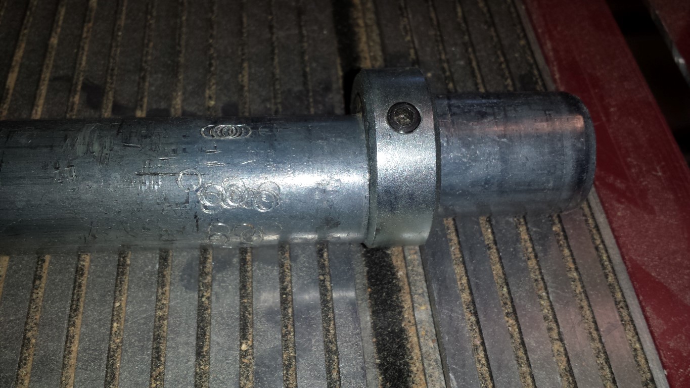

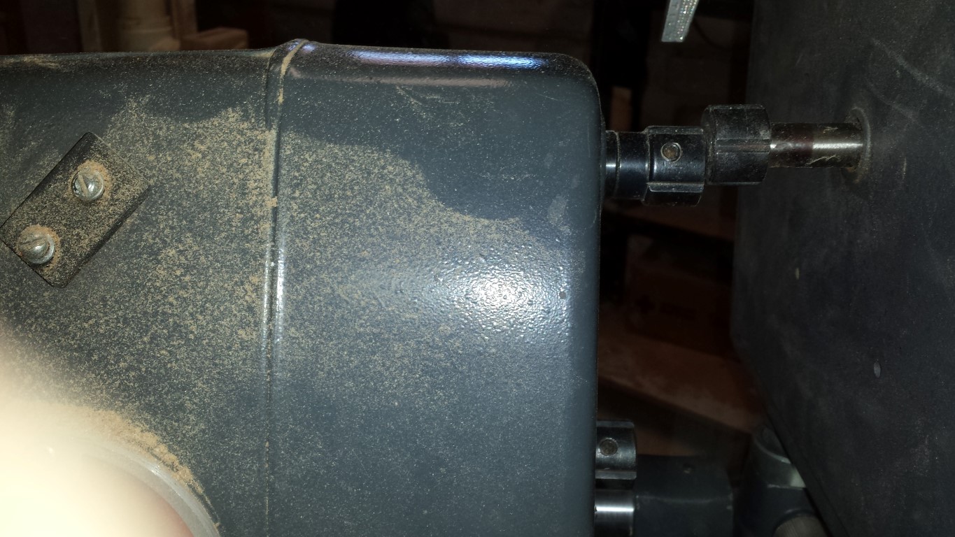

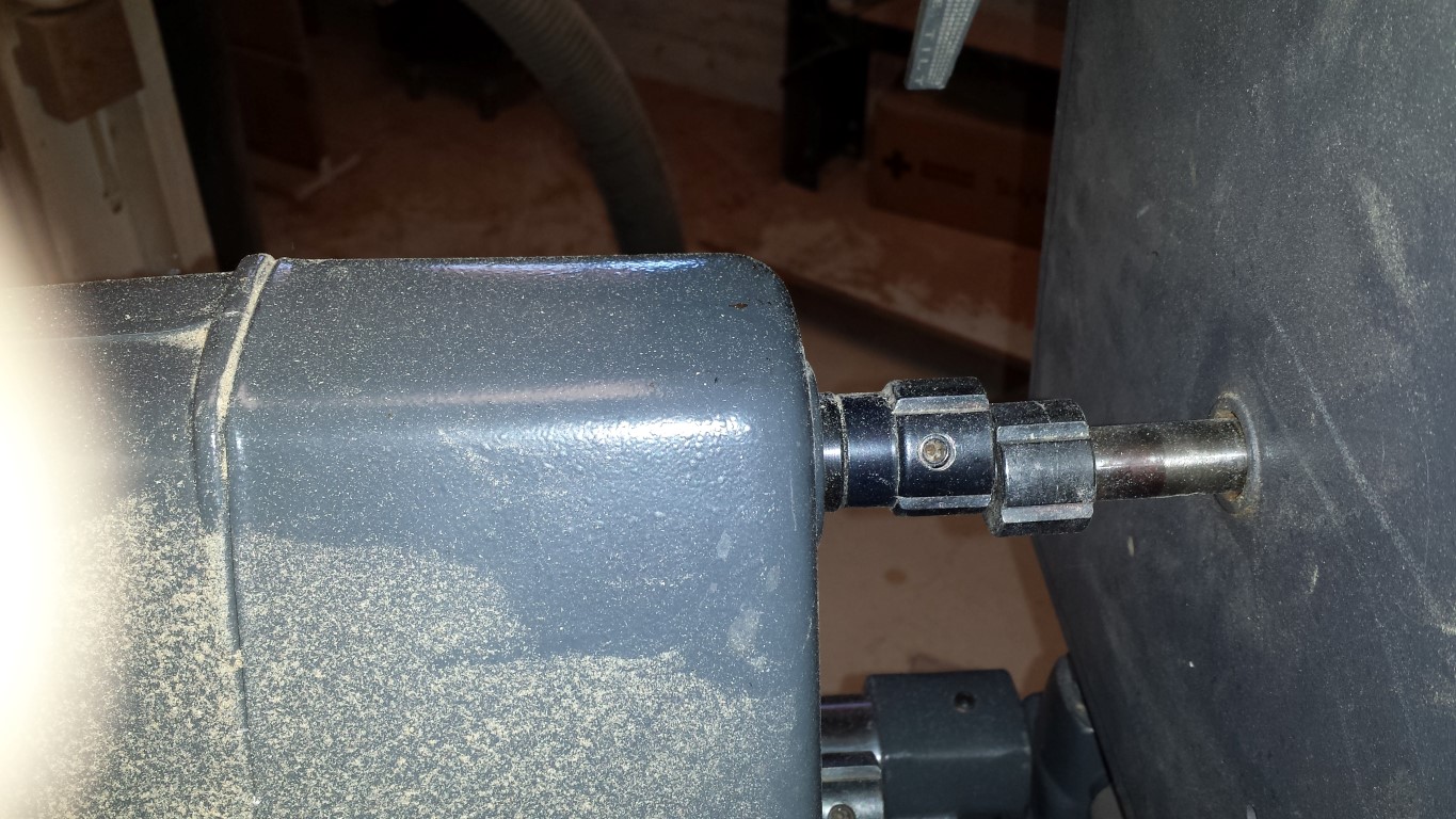

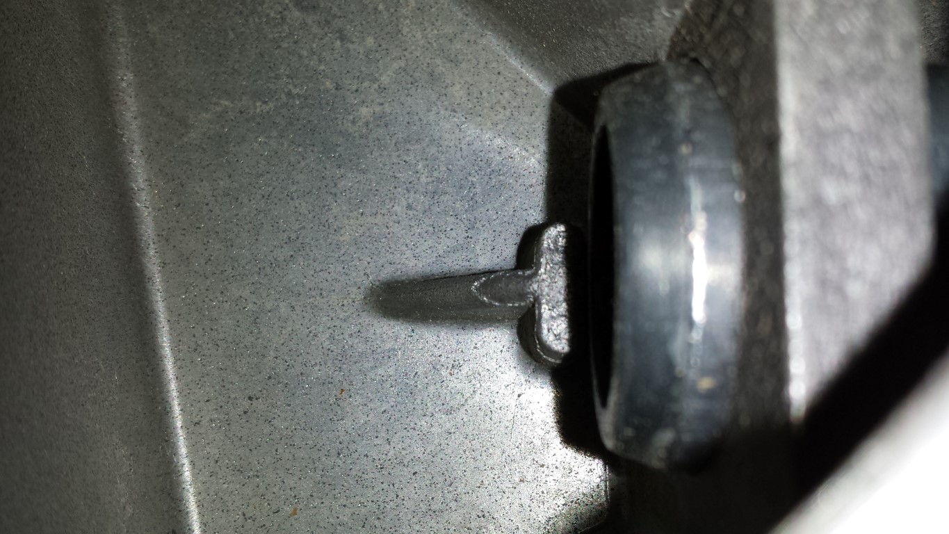

I picked up another bandsaw with tubes and spacing height adjusters.
I can't get the height right. Either it's too high using the adjusters or it's too low using nothing.
I have the tubes bottomming out inside the bandsaw.
Adjuster can't be put on any higher to reduce the height.
Bandsaw too high
Without the adjusters
Bandsaw too low.
I'm about ready to drill some wooden disk as spacers.
TIA
Bandsaw too high
Bandsaw too low.
TIA

Review pages 8-9 of the manual here. http://www.shopsmith.com/ownersite/manuals/845539.pdf
The stop collars are unnecessary and probably the source of your problem.
Re: Band Saw Height
The collars are not supposed to be on the tubes. Take them off. The tubes should sit in the SS end casting on the eccentric offset of the tubes. Adjust the height using the set screws on the band saw. Adjust the horizontal alignment by rotating the tubes.farley wrote:This doesn't make sense to me:
Bandsaw too high
Bandsaw too low.
TIA
The band saw must have been used on a power stand at some time. That requires the collars.

I use the stop collar on the other side of the eccentric tube and I don't believe my bandsaws have stop collars at all. I'll have to go look (later)..
Also, your eccentrics appear to be longer than mine.
The long leg on mine is 4 5/8" long. The short leg is 2 1/8" long. The long leg goes up into the bandsaw.

try putting the height spaces on the other end.
the short ends goes into the end mount.
Then block the band saw to match the height needed to align the couplers vertically. Then tighten the height spacers allen screws.
Then set so that the couples match horizonally. You might have to turn the tubes to have the couplers match.
Then tighten the band saw allen screws.
That was you should have to do this again until needed to be readjusted.
Re: Band Saw Height
thanks all.
I guess the biggest flaw was me thinking the tubes have to "bottom" out inside the BS.

Re: Band Saw Height
Me too! I finally decided bottoming was not necessary.farley wrote:thanks all.
The offset needs to be about 7/8" from the bottom of the casting. That places the inner end inside the bore and away from the 'stop'.
P.S. NO collars!
