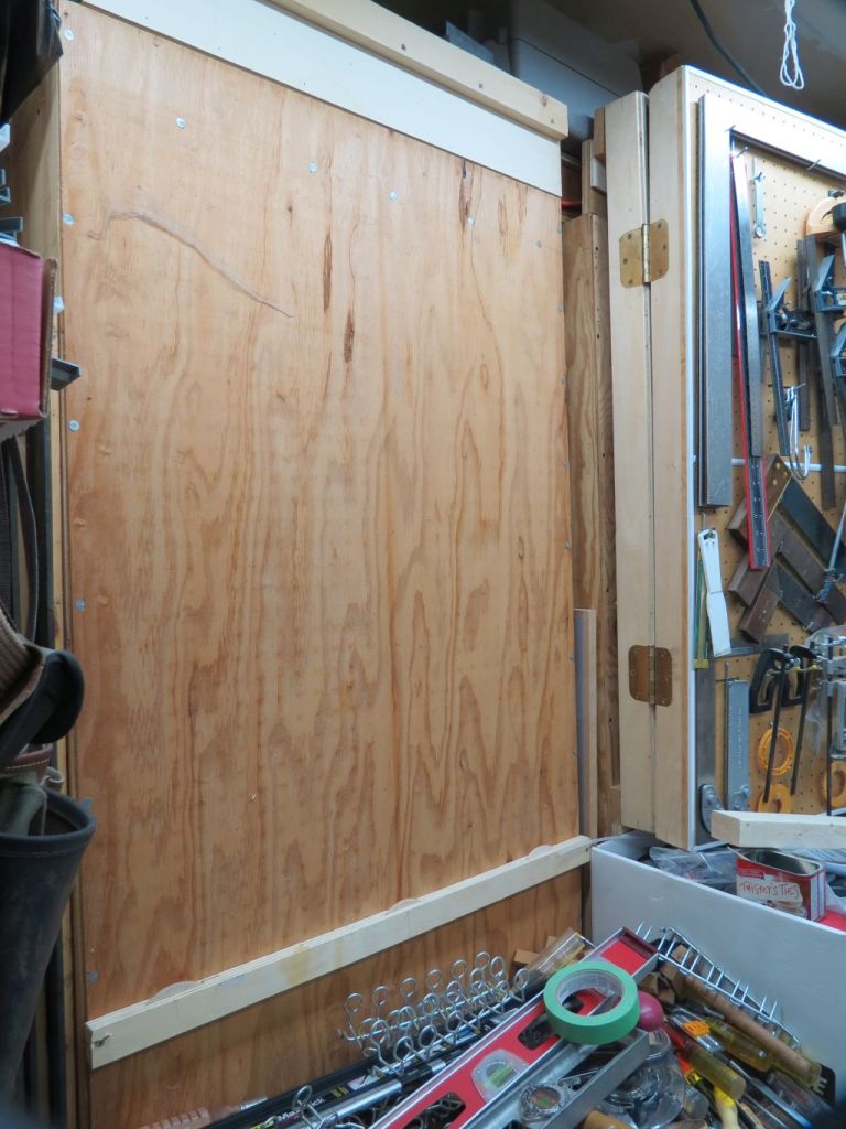

I have two of these cabinets but for this winter I'm only redoing one of them. This is a picture of where the cabinet was and some of the pile of stuff that came off the pegboard. It is mounted using a french cleat on the top and an anti pull off bottom that uses biscuits (my own design).

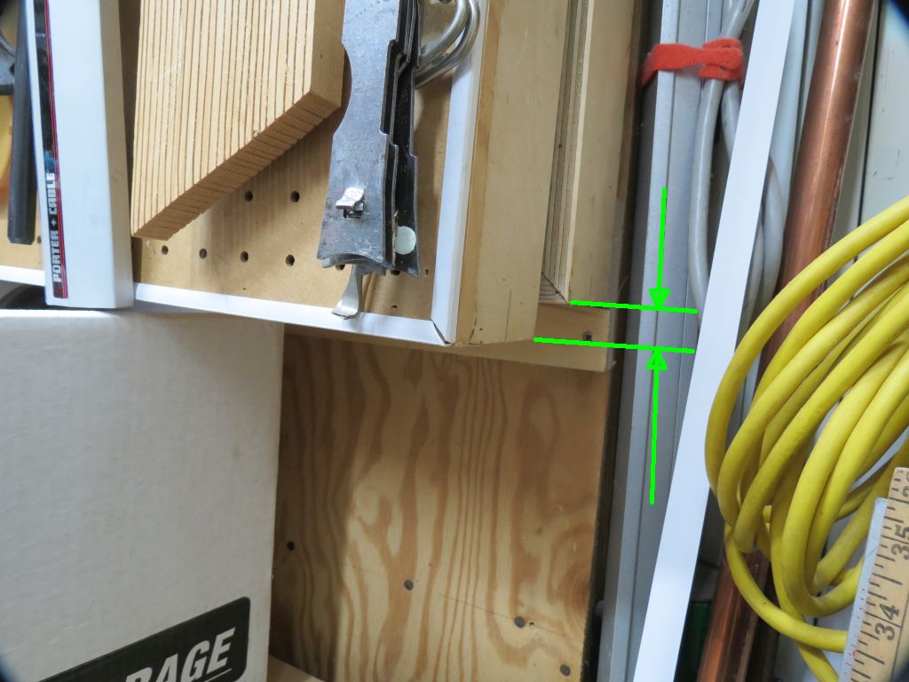

Both cabinets suffer from the same issues so while this is a picture of the remaining cabinet they both looked alike. The distance is about 3/4".

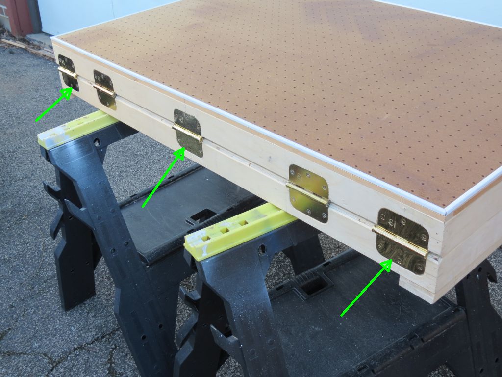

So I had to fudge together a template to use for the hinges, can't find the one I made to do the job so that wasted some of my time....... but I got it done. It was about 40 degrees so I was able to work outside and that was a big help mess wise. The hinges with the arrows are the new ones.

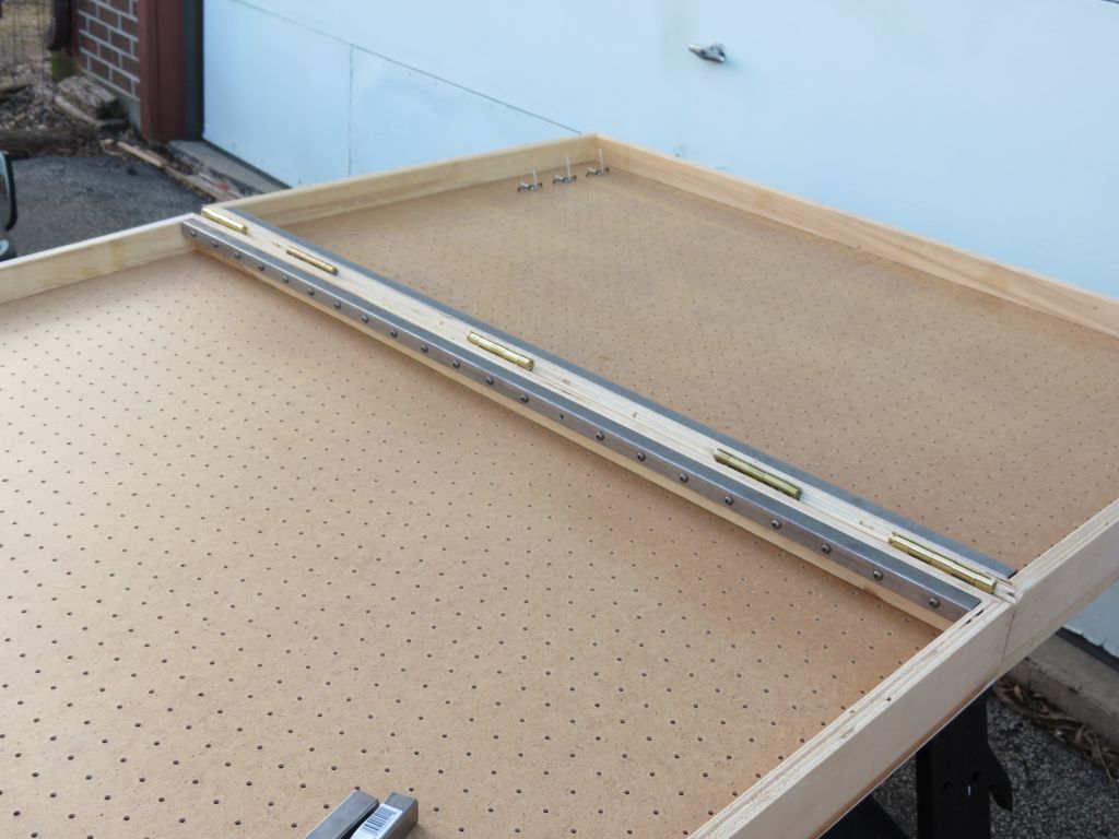

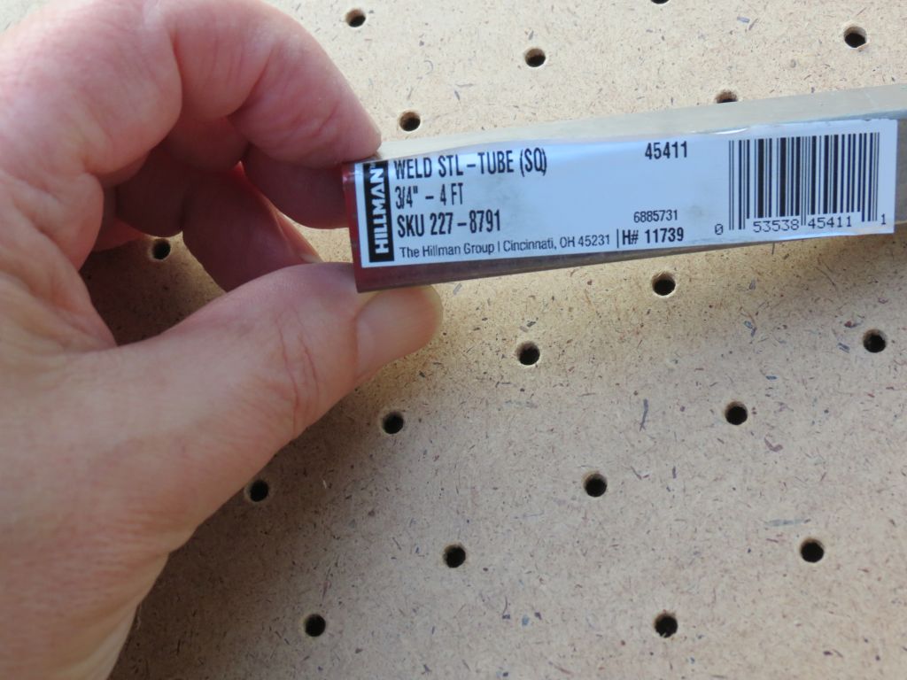

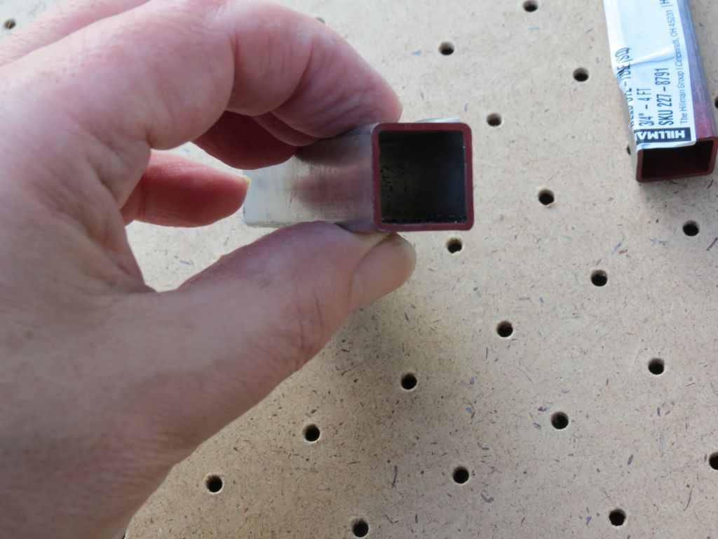

Now came the fun part. The channel I got was 4 feet long which is a couple of inches too long. Hacked sawed that off and then used the powerpro drill press and drilled through holes every 2". It was part of the job that I did inside, with the heater on since it was a good number of holes to do. Removed the burrs with the hand drill.
This is tubing:

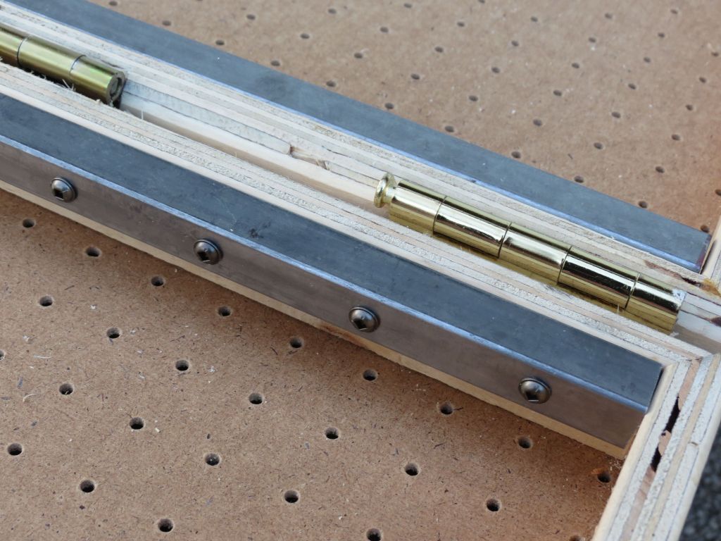

OK, here is a shot of the two tubes and how they are mounted.

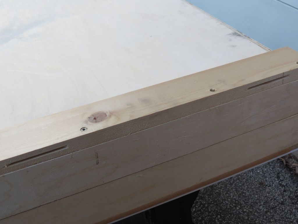

They run the full length of the hinge sides as seen here:
As I put the screws in the twist came out of the wood so I have high hopes that this will fix it for good. Since I'm only doing this one cabinet for now I can see how it is holding up after a couple of months and then decide if I want to go the same way on the other cabinet.

it should hold for you.
I think I would have used counter sunk bolts for the hinges and had them go tru the tubing.

That should hold just fine, but that one missing screw would drive me nuts! (No pun intended!)
Re: Today in the shop (my lesson in not being so cheap)
ChrisNeilan wrote:That should hold just fine, but that one missing screw would drive me nuts! (No pun intended!)
That has been corrected. I was wondering if someone would notice that. Good eye.
