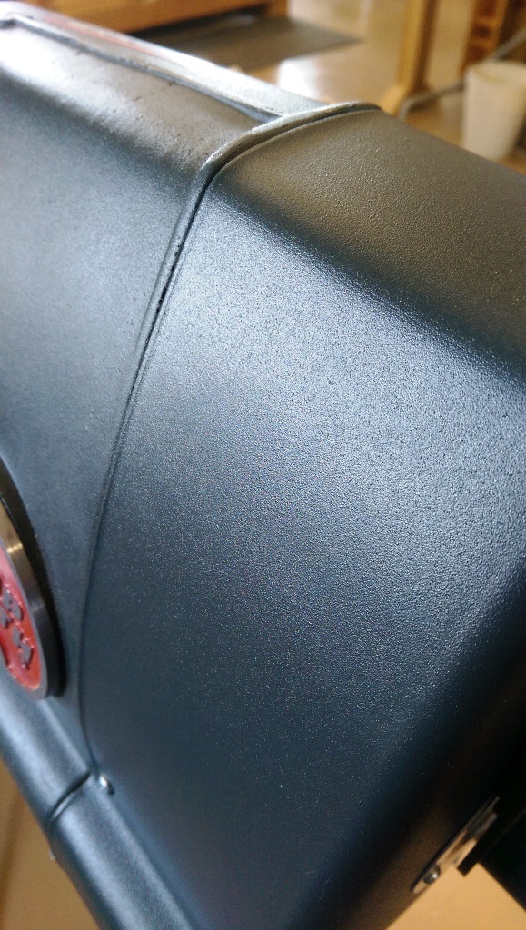

FWIW, the MK 7 is definitely satin but it is not completely smooth. It has a very fine and even texture. Look at the belt cover particularly which is smooth metal.
- IMAG0376.jpg (265.51 KiB) Viewed 2352 times

I called Customer Service today and they said the color is the same for all Shopsmiths that are Gray, your pictures show that is NOT true, I would like to use the SS Mark 7 color/Texture. Plus they only sell it in Spray Cans, backyard Auto Mechanic method. I want to paint with a real spray gun, more even coverage.jsburger wrote:FWIW, the MK 7 is definitely satin but it is not completely smooth. It has a very fine and even texture. Look at the belt cover particularly which is smooth metal.
So the Local Automotive paint store is the only answer, I just have to pick a color and go with it, he suggests Egg Shell finish , not as dull as FLAT and not as smooth and glossy as Semi Gloss. I will let you know what I come up with.

They did say COLOR. That is not the same as texture or finish gloss. My other two Shopsmiths are splatter finish and more glossy than the Power Pro. However I think the color is the same.jjbuzard wrote:I called Customer Service today and they said the color is the same for all Shopsmiths that are Gray, your pictures show that is NOT true, I would like to use the SS Mark 7 color/Texture. Plus they only sell it in Spray Cans, backyard Auto Mechanic method. I want to paint with a real spray gun, more even coverage.jsburger wrote:FWIW, the MK 7 is definitely satin but it is not completely smooth. It has a very fine and even texture. Look at the belt cover particularly which is smooth metal.

So if you have a Mark 7 and scratch it, and use the paint they supply, it will match color wise, but stand out finish gloss wisejsburger wrote:jjbuzard wrote:jsburger wrote:FWIW, the MK 7 is definitely satin

I don't know for sure since I have not done that. All I am saying is that in my opinion the color looks the same. The finish is not. I think some times the finish will make the same color look slightly different. The lighting also makes a difference.jsburger wrote:So if you have a Mark 7 and scratch it, and use the paint they supply, it will match color wise, but stand out finish gloss wisejjbuzard wrote:jsburger wrote:FWIW, the MK 7 is definitely satin
Also, if all you have is someone else's pictures all bets are off. Many times pictures don't render the color the same. I am speaking from looking at my three head stocks in person.
