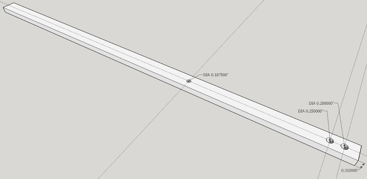

I don't believe you really want to modify Kreg the miter bar.MalcolmMor wrote:Not sure if this should be in this forum or under maintenance/repair but I received the Kreg Miter Gauge system as a birthday present and want so badly to use it with my Mark V but of course the miter bar is just slightly too big. Has anyone had good results from filing or sanding down a non-SS miter bar to work with their SS? What methods worked best? Is there anything you would definitely NOT try?
However, Incra does sell a miter bar that is compatible with the Shopsmith table. So does Shopsmith. Drilling and taping holes is all that would be required to fit your Kreg on an Incra or Shopsmith miter bar.
I have both. If you would provide a sketch of the hole arrangement (including hole size and thread, I will check to see what has to be done to make that transition.
This sketch does not include all of the detail. It shows only the hole locations that are used for something other than the width adjusters.
There is another Incra bar used on their V120. I will sketch that an add it to this post later.
I just noticed that I left off the critical dimensions. The three holes are located 1/2", 1" and 7" respectively from the end of the bar.

Now that I look at real close, I don't know what the Incra miter bar is for. It fits nicely in the Shopsmith miter track but the holes do not match either the V120 or the Shopsmith protractor.
I have been using it as a filler for one of the miter tracks on my Mark V. It is steel (magnetic), which allows me to attach items like the Wixey or iGage.
