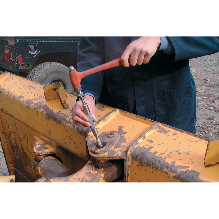

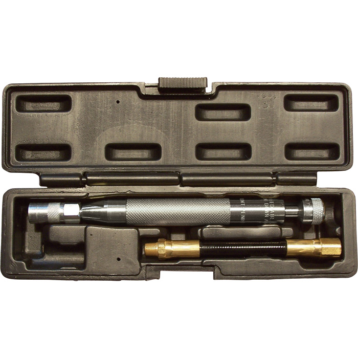

The tool is called a Grease Joint Rejuvenator and I found it at Northern Tool. The Grease Joint Rejuvenator allows a clogged grease fitting or joint to take on fresh grease by injecting light penetrating oil into the grease joint to unclog the zerk. Mine won’t be clogged so it will go right in.
Grease Joint Rejuvenator Northern Tool.jpg (126.69 KiB) Viewed 4503 times
I will use this tool to repeatedly hydraulically force ATF & Acetone mix through the new grease zerk and into the rusted shaft assembly to free up the frozen shafts on Shopsmith and other items.
So it’s out with the setscrew, in with the zerk, and inject ATF & Acetone mix.

Grease Joint Rejuvenator Northern Tool.pdf
(330.13 KiB) Downloaded 1014 times

Don't use an angled zerk if you are going to use the zerk cleaning tool. Hammering on it will break it off and make a bigger problem.
I prefer stainless steel zerks with long threads, but they will need screw in all the way and snug the base to what you are screwing it into before you start hammering on the plunger of the cleaner.
I also put the PDF of the cleaner in the post because it needs to be read. Need to know how to get air bubbles out of the tool before you use it, and a few important safety items, like not having the plunger rocket back at your face after hitting it.

I noticed today that Northern Tool here has the IPA Grease Fitting Cleaner Item# 403100 normally $39 on sale for $29 locally for anyone thinking about one of these.
Others have PM'd me about the unit and I can tell you watch so you don't confuse it with the IPA Grease Joint Rejuvenator Kit — Model# 7863 Item# 27227 which is $69 also at Northern Tool. The $29 one is just fine.
I also have used it for what it was intended on a tractor opposed to a Shopsmith, and swapped the 50/50 mix of acetone/atf I suggest for the Shopsmith for straight mineral spirits using information one of their reviewers provided on a hay bailer he was working on, and that works well for cleaning a grease zerk.
For Shopsmith I would stay with the 50/50 mix since generally we are fighting rust and adding the Zerk to get it in. JPG's suggestion to use the short thread is a very good one, just make sure you have the proper thread.
As I posted earlier in another thread, sometimes a little influence of just adding the 50/50 mix in the hole and re-threading the allen screw you took out as a packer can be an effective hydraulic ram as well if you repeat the process a few times to force the rust remover mix into the problem areas.

Just read the caution in the instructions.
Equal opposite forces.... you force it down... if liquid goes in... good... if not, the same compressive force of any air pocket you compressed will decompress the plunger back into your face, at velocity.
Start gently and increase the percussive pressure over time once you know what you're dealing with. Take..... your..... time......
Don't get in front of, or right over the tool! Wear eye protection. Squirts happen.
