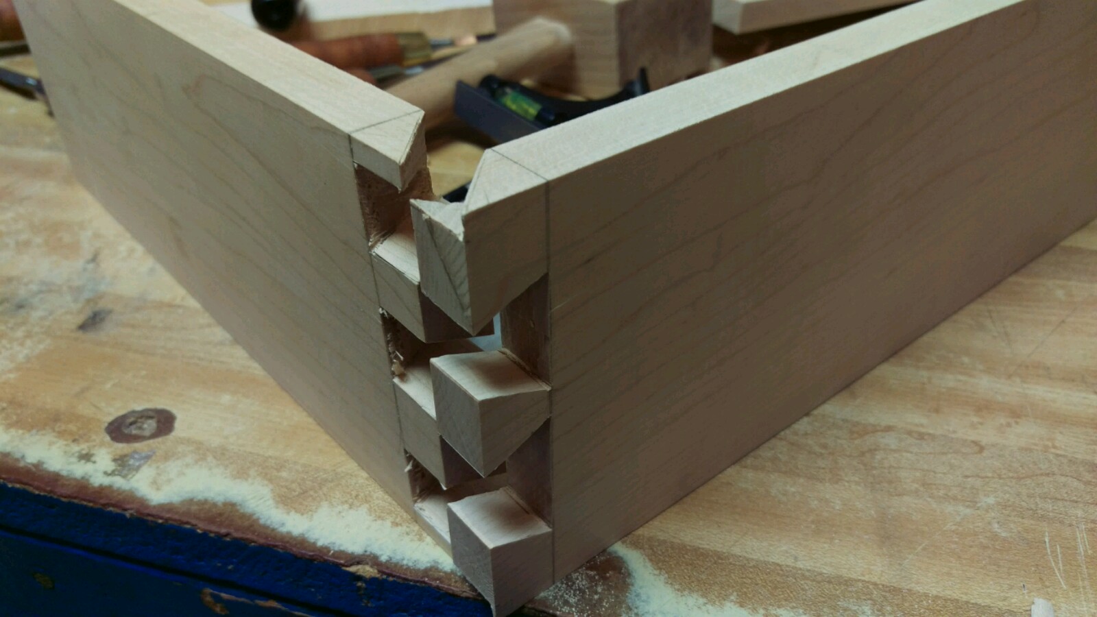

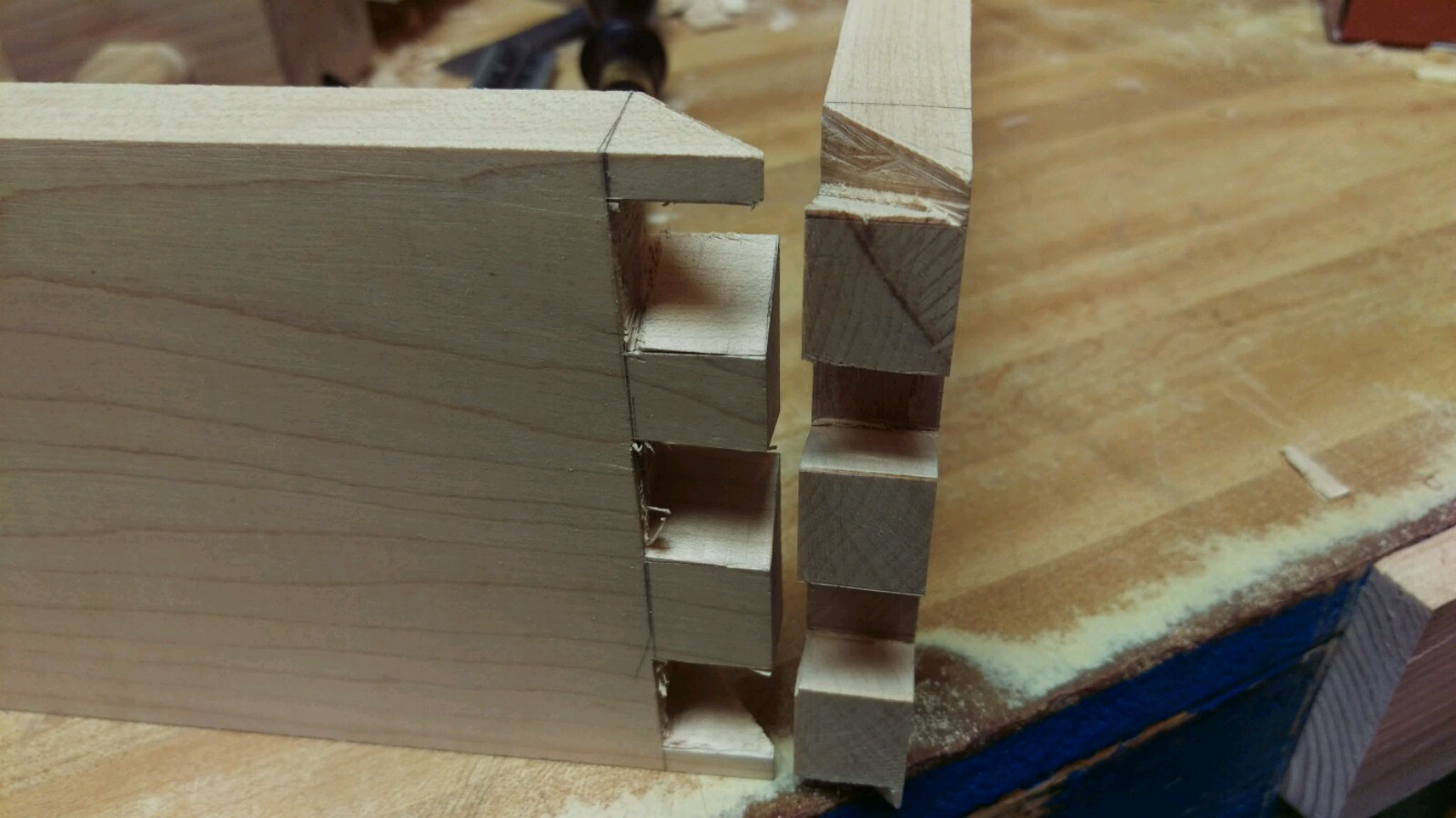

Tried out a hand cut dovetail joint with mitered corners to hide the dovetail on top. Didn't go so well, first pair I ran my miter the wrong direction so I couldn't slide the dovetail together. Second time it got too loose. Not to mention chip out on a few tails.
Only my second time doing dovetails though. First with only a dovetail saw, and chisels. Must be a sign to knock the dust off my dovetail jig. Or maybe stick with dovetails without complicated meters as well...

Well it was/is 3/4" hard maple and was certainly a process. I do need to sharpen the chisels but need to finally buckle down and but a wet stone set. They were fairly sharp to start, but I think my issue was in the mitered top and bottom. The 45 degree guide for the chisel helped get that angle right on, but following the angle of the tail while maintaining the 45 is what caused binding and eventually slop in the joint.
I'm just a glutton for difficult projects I guess. I need to try a box joint or finger joint next. All I have ever done is dovetails, miters (twice), rabbets, and a few mitered rabbets. I'm hoping box joints would be easier.
-Beave

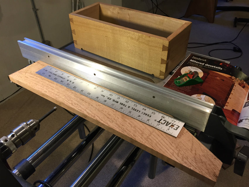

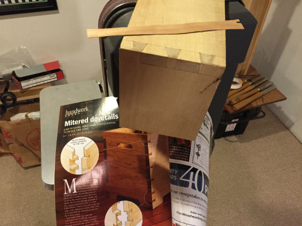

I just changed my mindset after the initial disappoint. I figured, I enjoy restoring stuff, so let me restore my own joints :) !!!
Couple of things I did...
Shimming up the gaps: I needed some shims even thinner than ordinary veneer. So I thinned-down veneer on the strip-sander:
Planing the joints by hand: This always makes them look nicer.
Re-scribing: In my case I had to do enough shimming and hand-planing that I removed my initial dovetail depth markings, which made the remaining joints look a bit random. I used a decent cutting gauge and re-scribed, which tidied up the appearance somewhat:
Other emphases: Same picture above shows details being added to the lower edges of the boards. This helped take the eye away from the vast boards and their beginner-level dovetail joints.
