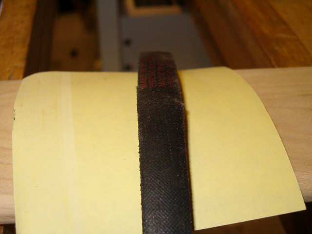

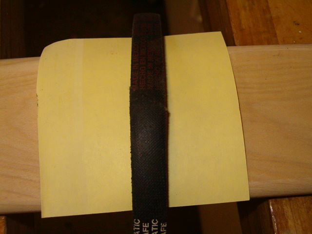

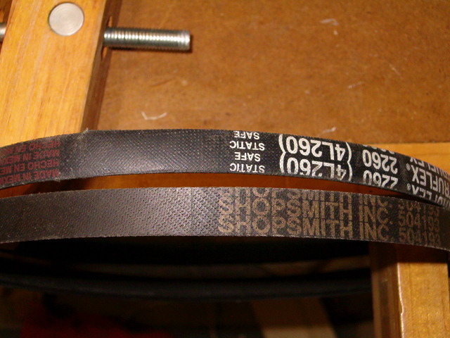

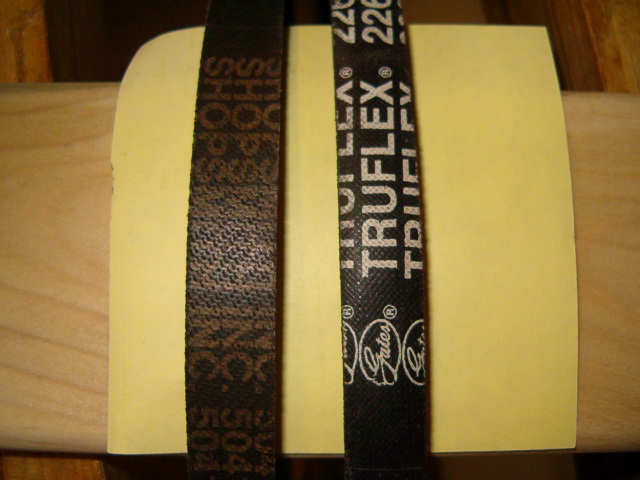

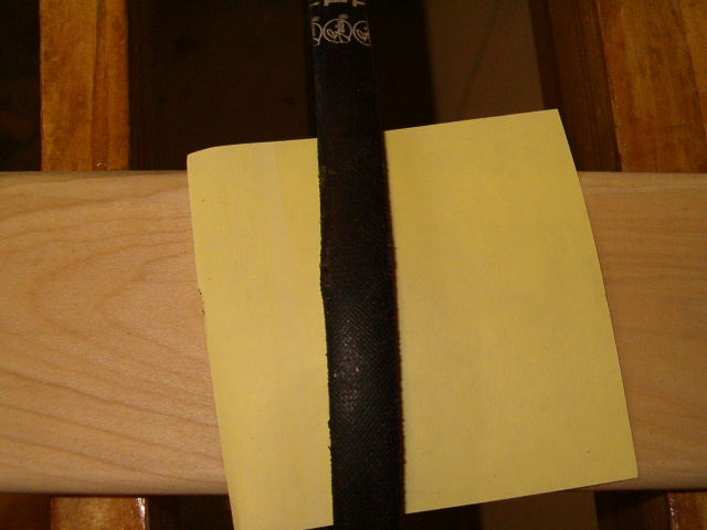

I have been so upset over this serious mistake by Shopsmith, I have waited more than two weeks for my blood to cool before issuing this thread. My biggest hope is this subject will become one of the subjects in the weekly staff meetings mentioned by Nick. My biggest concern is compromised performance of all Mark Vs.
I'll try to keep this short and sweet (as sweet as this sour subject can be). There are 5 photos attached which will replace many words. The Gates 2260 is compared to my old 1/2" worn out Shopsmith belt.
After removing my drive belt which was in place for over 5 years of many hours of use. I put on the spare belt that's been hanging in my cabinet. Then ordered a new spare belt just in case. The old belt measures exactly 1/2" in diameter, but I thought it was beginning to run a little rough. The replacement (new) belt gave me a noticeably smoother, quieter operation.
Then the newly ordered spare belt arrived. It was not the same as the proprietary Shopsmith belt I had expected. -- It was a Gates "Truflex 2260" belt. The packaging said it was 1/2" by 26". The width of that belt is only nominally 1/2" wide. In reality it is 1/32" narrower than that. Incidentally that is the same width when our instructions from The Academy" say to replace the belt.
I called Shopsmith to report they had sent the wrong belt, saying it is already too narrow. The reply was, "it is supposed to work just fine". As our conversation continued, I continued to point out the belt is not properly made to replace the old "Shopsmith Belt" - It is not firm on the back (top) - It has a different taper - and the top is crowned which will crown more with side pressure. I was asked "What do you want us to do?" My answer was to go back to the old Shopsmith belt. The reply was - "We will NOT be changing from this (Gates 2260) belt".
Believe me, I put this 2260 on the machine to try it out. IT RAN ROUGHER THAN THE OLD USED BELT I HAD REPLACED!!! I only ran it for a couple of minutes. After this I gave a serious look at the Gates 2260. It has two bulges on the sides. One at the visible seam (joint) and another 9 inches from the seam. The actual width measurements on this Gates 2260 are less than 14/32" in diameter, except for the bulges - they are both 1/2" wide.
For comparison, a new Shopsmith proprietary belt measures 9/32" wide, and is smooth.
I also did an Internet search for belts. While searching in the variable clutch belts, I did not find one a narrow as 9/32" or 5/8" or 1/2". At this time I have no idea of who made these proprietary belts for Shopsmith. Although I did not find a suitable variable clutch belt, I did find the Gates 2260 Truflex belt. It was obviously designed and made for use with fixed pulleys NOT VARIABLE CLUTCH SHEAVES. Belts for variable clutches have flat backs and strong, stiff fiber stitching near or at the back.
I am mostly concerned with the future Shopsmith users. If their machines perform like mine did with that Gates belt, they will soon be discouraged. Frankly, I am surprised we have not heard any comments on this belt before. Drive belts are listed as one of the most often replaced parts. Surely, I didn't get the first one!
This changing of belts, by Shopsmith, appears to me to have been an ill advised, financial (bean counter) decision, not an engineering one. If so, it is my hope that the costs of the proprietary belts can be accepted by the company, so we can again have smoother running machines. If the cost to us SS owners becomes a bit higher I think we can accept that. Some may go to link belts, but not me and I believe, most of the others. The other alternative of continuing with this 2260 belt is not pretty!
now the photos: They speak for themselves.

- Comparison of quality.jpg (111.39 KiB) Viewed 11599 times
- Width compared to old SS Belt.jpg (117.75 KiB) Viewed 11597 times
- SEAM.jpg (123.92 KiB) Viewed 11594 times
- BULGE AT SEAM.jpg (125.62 KiB) Viewed 11593 times
- BULGE 9 in. FROM SEAM.jpg (115.33 KiB) Viewed 11591 times

Charlese, I recently replaced the drive belt on my old Mark V with a Gates 4L260. I found the same width issue that you point out. The Gates belt I purchased was made in Mexico. I had the sales guy check all of his 4L260 belts and we found they all were at least 1/32" undersize (specs say 1/2"). I guess that is within the mfg acceptable tolerances. I did not find the other quality issues that you did, but when I installed it, I found that at high speed, the belt runs about 3/16" down inside the sheave flanges. I'm not getting the correct speeds at either end with it. I figured the 4L260 was too narrow and too short so I was about to order the correct spares from Shopsmith, but I see from your pictures that this is what is being supplied now so I'm not confident that I should do that right now. I put the old SS belt back on and it runs right at 1/8" below the flanges at high speed without making any changes. From the looks of your pictures, it seems that SS needs to review (or do) their receiving inspections to verify the quality of their drive belt stock on hand. Also it seems like they may need to verify that the new belts will actually function properly with the variable speed sheaves. I hope there is some response from SS on this. John McCrossen
