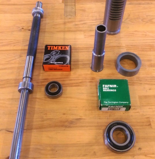

A couple of years back I was looking for this information when I was doing the 10ER that I gave my brother. I copied this from the yahoo site, sorry no date on it.
-- Spindle/Quill Bearings:
Sizes are .6299 ID (16 MM)
1.378 OD (35MM)
.5669 W (14.4 MM)
Original felt shielded Fafnir 202KLL3 =
BCA 88016
FAG 501675, 532742, 8016KK, 88016
SKF 88016, G88016
NEW DEP 88016, C88016
Fafnir 202KDD6 - a 5/8" id x 3/32" thick bushing is needed with this bearing to position the front bearing collar correctly.
-- Pulley / Drive Sleeve bearings:
Sizes are .9843 ID (25 MM)
2.0472 OD (52 MM)
.5906 W (15 MM)
Original felt shielded Fafnir 205KLL2
good substitute double sheided Fafnir 205KDD
SKF 6205ZZ, 6205-2Z
and many other bearing manufacturers with same # as this is a standard bearing
A good source is www.ebatmus.com, they carry both and the quill ones are particularly harder to find. I think the quill ones are about $10 per and the drive sleeve ones are about $15-$18 per bearing. So if you want/have to replace all four it can add up. Plus shipping's about $10.
It turned out it didn't need new bearings so I did not follow through getting any for the quill.

Re: Where to buy 10e Bearings
Skip is the source. I called him when I started my 10ER restore 6 or 8 months ago. He told me he doesn't stock them any more because it is cheaper for someone to just order them themselves.
Quill is Fafnir 202KLL3 and drive sleeve is Fafnir 205KLL2. Skip buys them from A & W Bearing in Dallas. They sell the genuine Fafnir bearing. BTW, Timken bought Fafnir a number of years ago so you may get Fafnir bearings in a Timken box.
I ordered mine from A & W and the sales lady Lana was very nice. She even knew Skip. The 202KLL3 were $21.44 and the 205KLL2 were $27.09.
As some have said they can be found cheaper but they are not genuine Fafnir. For my money I will put the originals in knowing I will never have to replace them.
