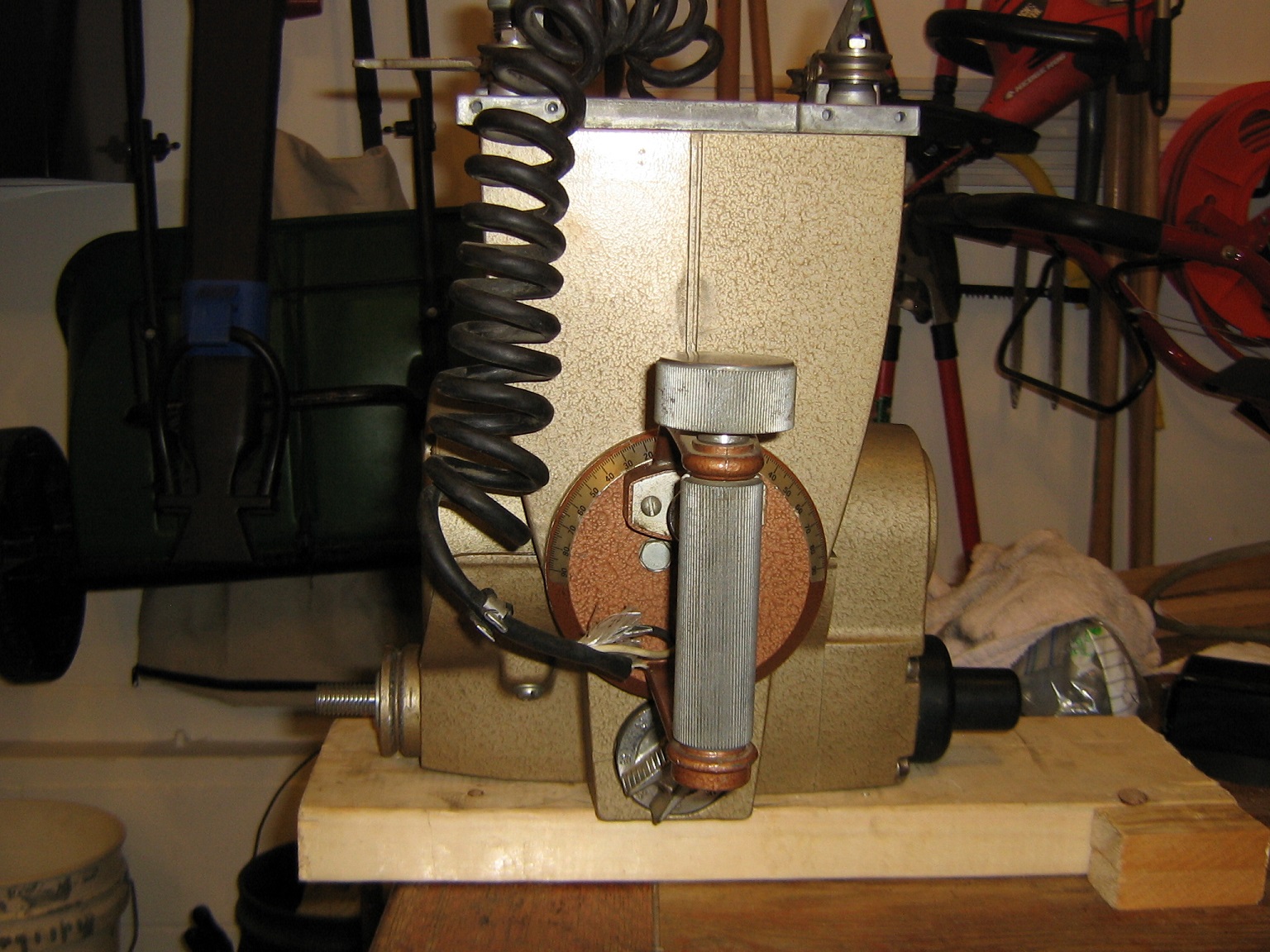

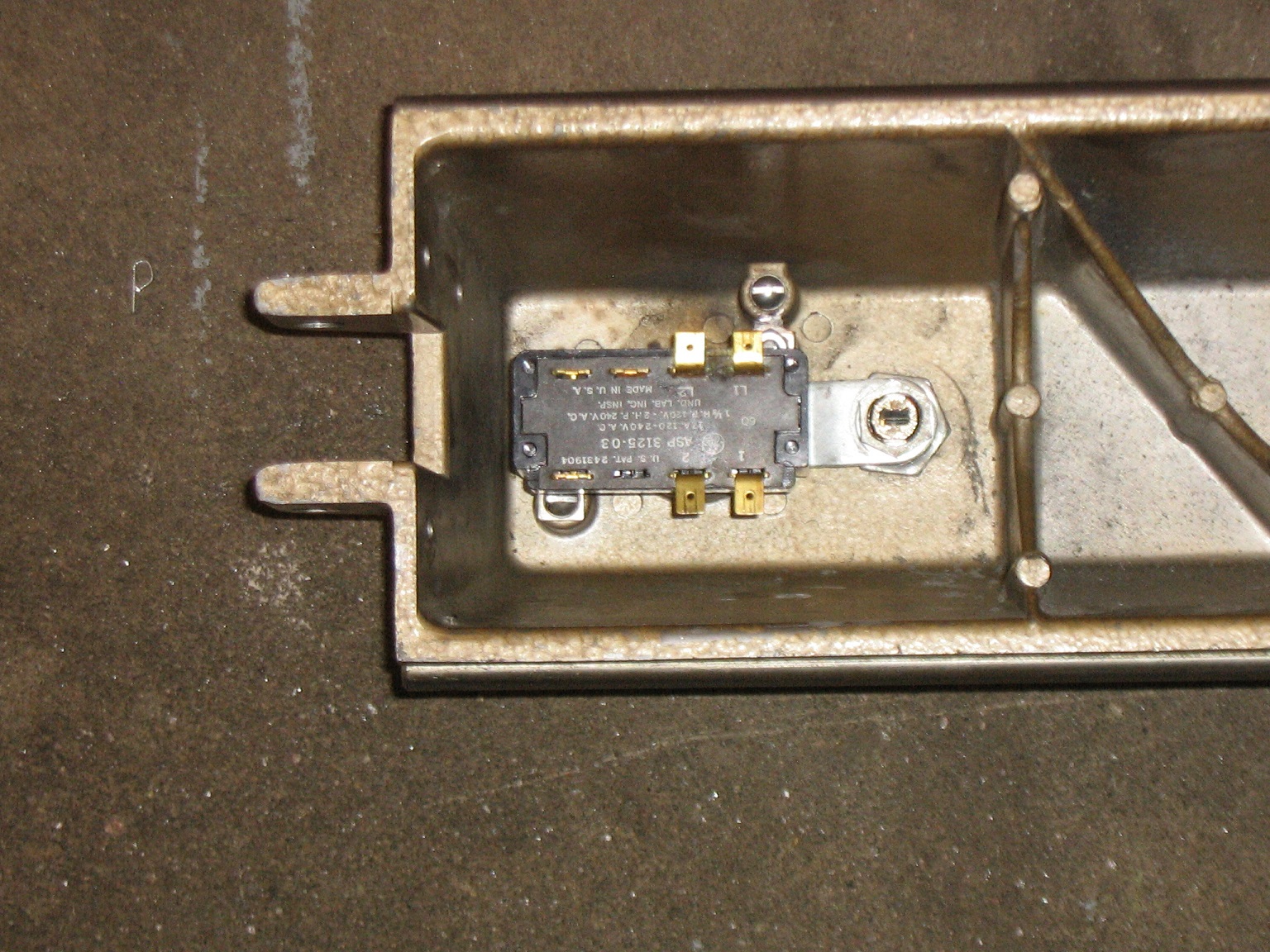

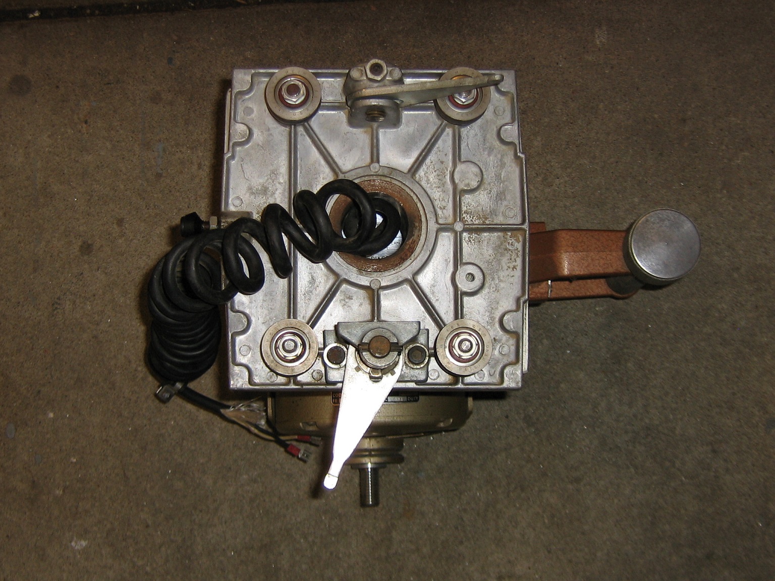

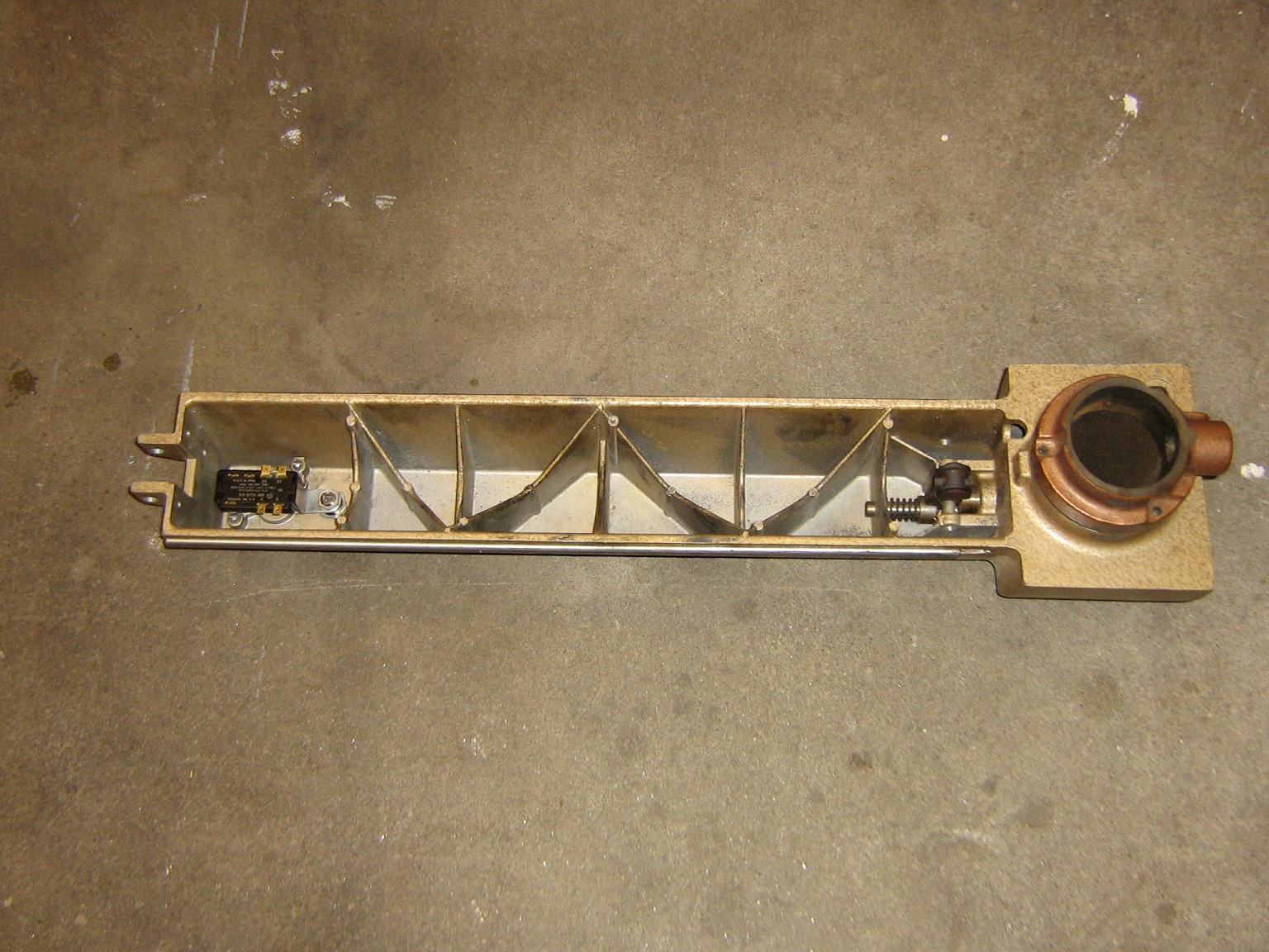

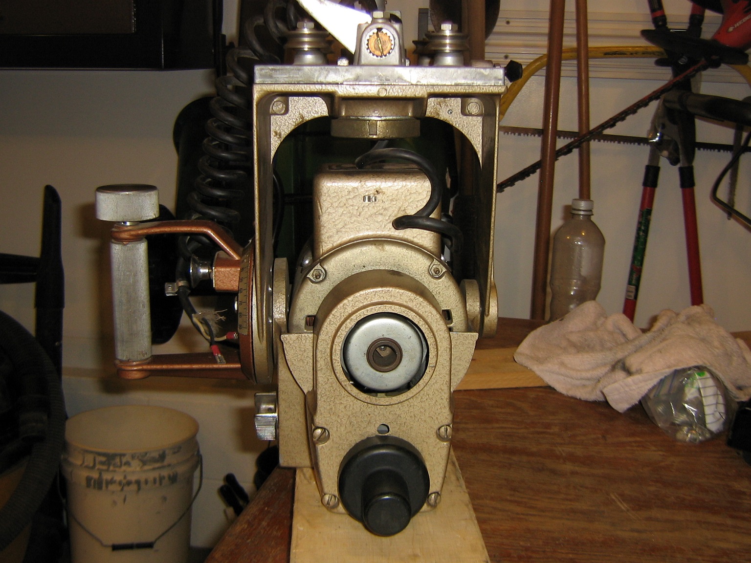

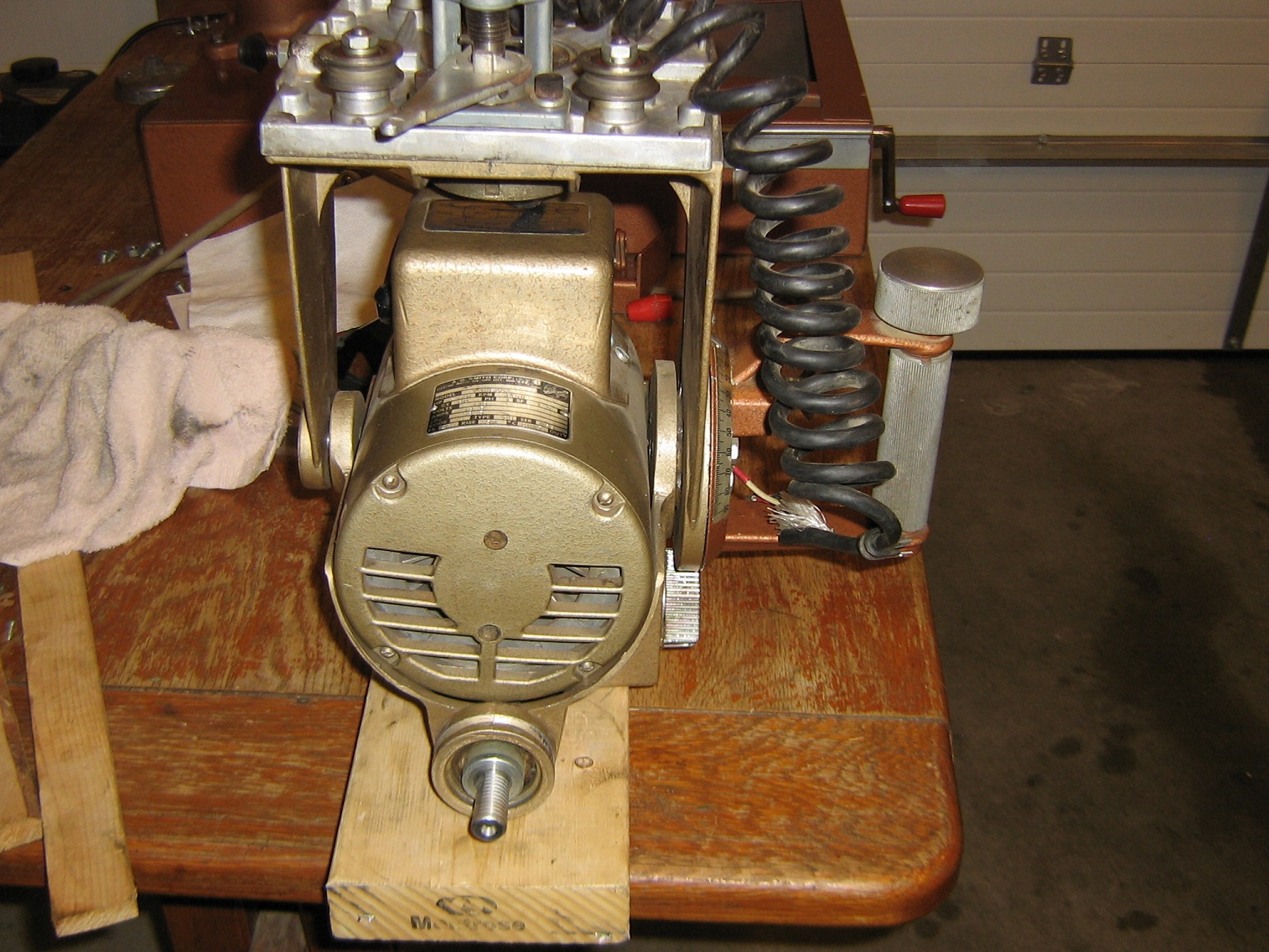

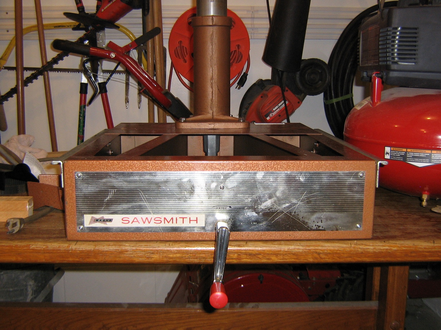

Sawsmith Refurbishment

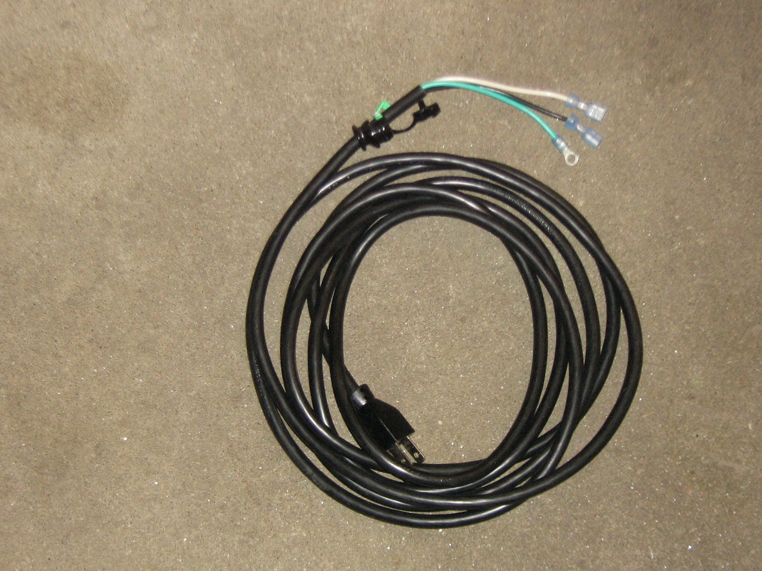

I recently ordered a replacement power cord for my Sawsmith. I ordered the part numbers using the Sawsmith Spare Parts List. It shows up on the Shopsmith site as 503099 Wire-Main with plug and 503101 Strain Relief. Both parts have been replaced by 515652 Cord Power Station which comes with the strain relief already on the cord. I received it today and it is an exact replacement cord and strain relief for the Sawsmith. It even has the connections on the wires so you can just plug them into the Sawsmith On/off switch! Price is $22.41 plus shipping.
I am in the process of restoring a Sawsmith to new condition. I am just starting the re-assembly process and will provide pictures as I go. I am just waiting for the base cabinet parts to come back from the paint shop. They are sandblasting the six base cabinet pieces to bare metal and then powder coating everything in a color close to the original Magna American gray color. I had a locksmith shop make me keys for the lock on top of the radial arm and the lock on the cabinet. I am replacing all hardware with stainless steel hardware if available.
Some of the parts are soaking in potatoe water for two weeks to remove rust.
Also finding 2" replacement casters that have a swivel radius of only 1.25" is proving to be impossible.

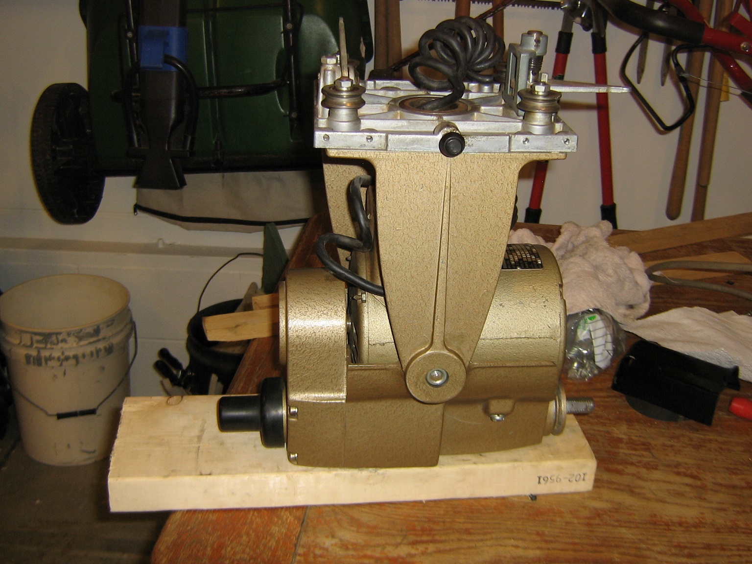

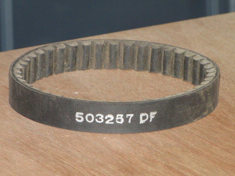

I cleaned and oiled the motor shaft and sheaves as well as replacing the belt. It purrs just great and moves through all the speeds smoothly. The original belt was still on it and it was a Yuba belt. I used a Shopsmith belt which was a much better design with many more ribs on it than the original Yuba Belt. I still have one more genuine Shopsmith belt left in case this new one ever needs replacement. I found my belts from other Sawsmith owners. They cannot be found any other way.
- Genuine Sawsmith OEM Replacement belt
- Sawsmith Belt.jpg (65.87 KiB) Viewed 20774 times
Last edited by stephen_a._draper on Fri May 20, 2016 9:43 pm, edited 2 times in total.
