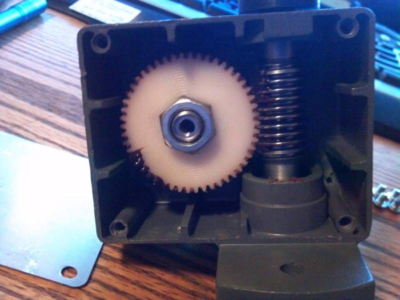

Received my ODS today.
Gearbox Assembly.jpg (59.27 KiB) Viewed 9154 times
Went straight for the gearbox
Gearbox Assembly 2.jpg (43.95 KiB) Viewed 9154 times
Nothing surprising here, just a steel worm drive gear and a plastic driven gear.
No names, trade marks, made in China, or Kilroy was here!
I'll be adding a little more lube in here before using. :cool:

Thanks for trying! Here's what I read:
Now, you might be asking yourself "What's with the Shopsmith Oscillating Drum Sander pic?" Good question, and one of these days remind me to tell you about Shopsmith's ingenious use of the automotive water pump bearing assembly, but for those of you who own the Shopsmith Oscillating Drum Sander rig shown at right, take a minute and remove the four short screws that hold the aluminum name plate on. Now, remove it and flip it over... SURPRISE! Very clever guys in the SS Model Shop!
See here. http://shopsmith-tool-hunter.blogspot.c ... nders.html

I would worry about the nylon gear arrangement, this is the part that makes/lets the quill go up and down but is not driving the sander. Like any other sander you let the sandpaper do the work. If you push too hard it will just stop going up and down as the return is just the quill spring doing the returning, to much press and that stops happening.

I wouldn't worry about the plastic gear, it is listed in the online order form as a Delrin gear. A google search shows that Delrin is a very high quality durable plastic designed for harsh high friction applications.
A replacement would run around $25 after tax and shipping.
There is a parts breakdown (30 separate items) and part #'s for every item in the 4 page manual.
