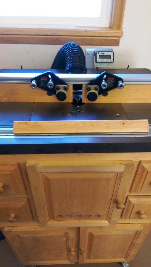

I have an early Bench Dog cast iron top on my shop built router table. it is 20" X 27". As Ed said large is not necessarily better or needed. I have never thought I needed a bigger one.
- IMAG0371.jpg (172.4 KiB) Viewed 4913 times
