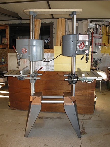

Since I built the Push-me Pull-me double drill press (picture below) several years ago I have not lifted any of my SS's to vertical mode at all. Why would I?

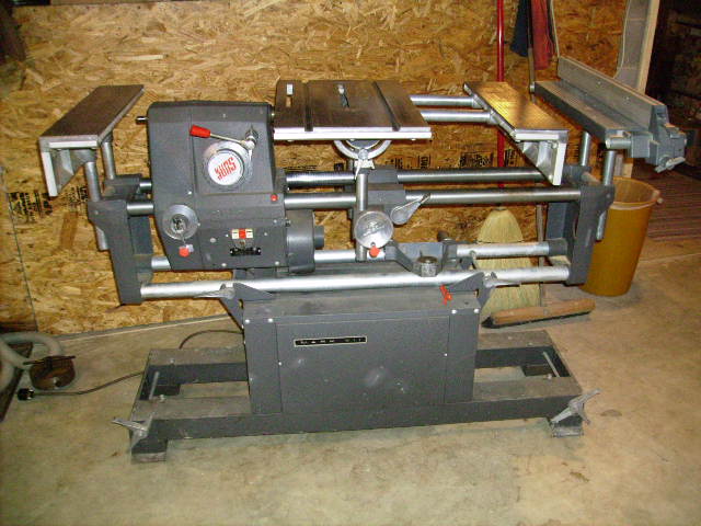

OK, I did lift my old Mark VII one time but that was just to lube the little speed control bearing. I have to think back... I guess that was lifting it to the left? On a side note the old Mark VII's are easier to lift to vertical since the pivot points are much closer to the center of the machine (picture below).

I need to get back to some additions to the double drill press.It is now on a regular SS caster set. I want to add either some shelves or a small cabinet to the base just above the caster area and another above the bench tubes.
