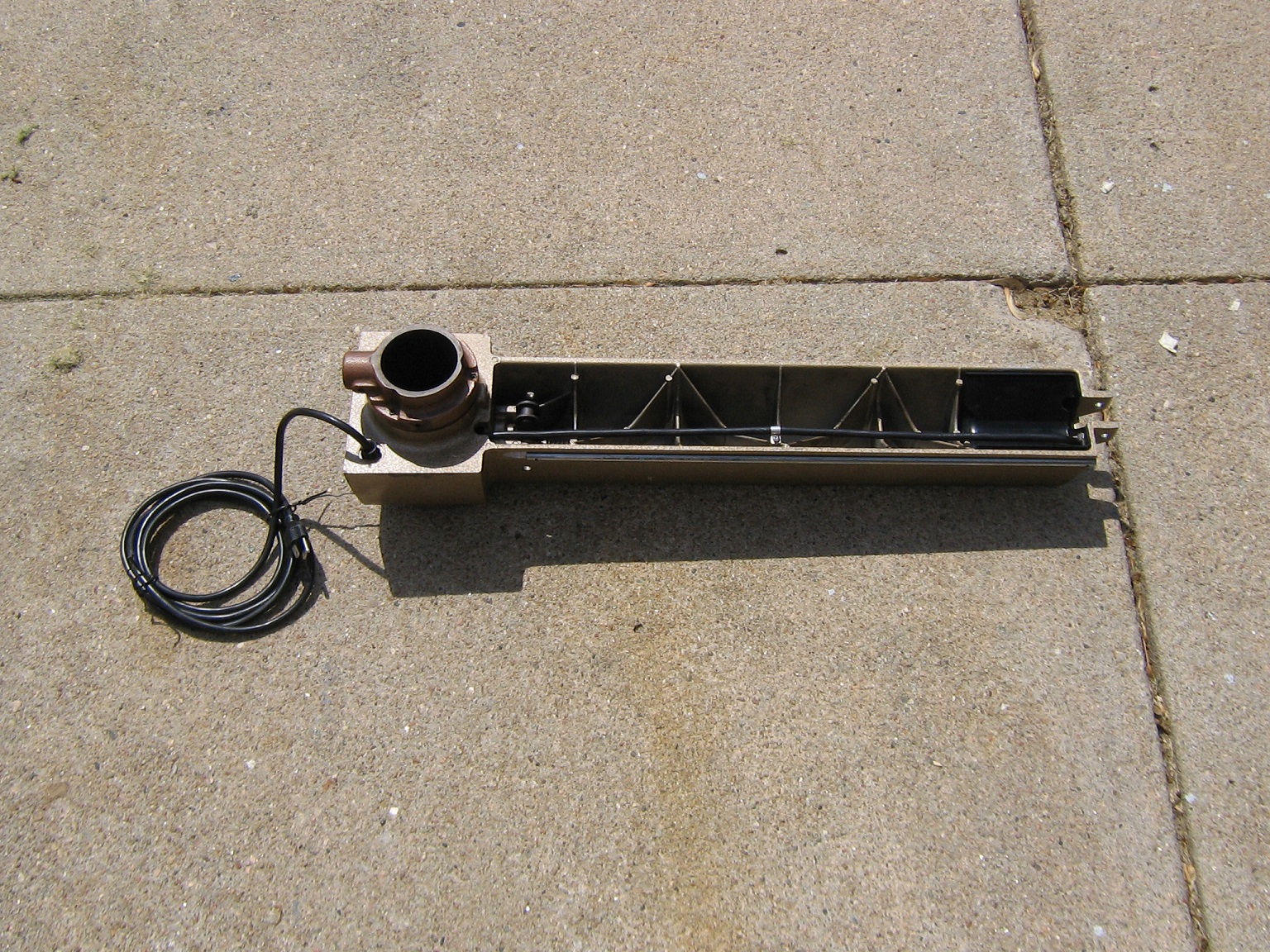

Installing New Power Cord on Sawsmith
Post by stephen_a._draper »

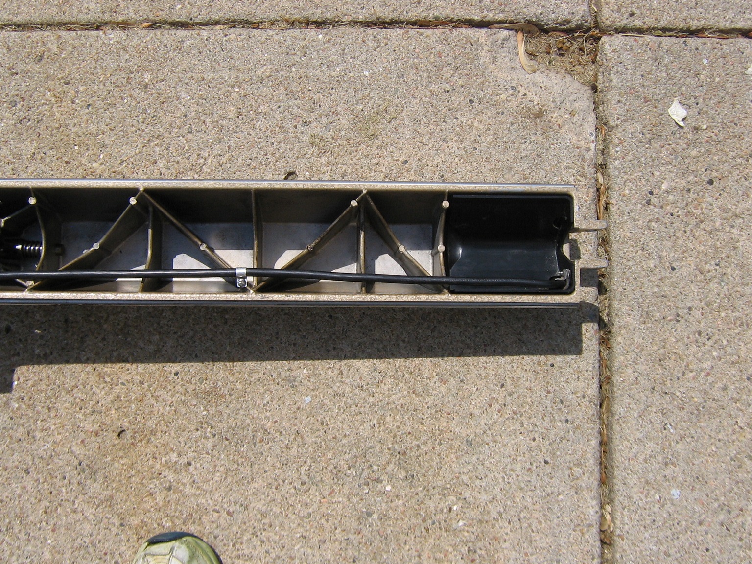

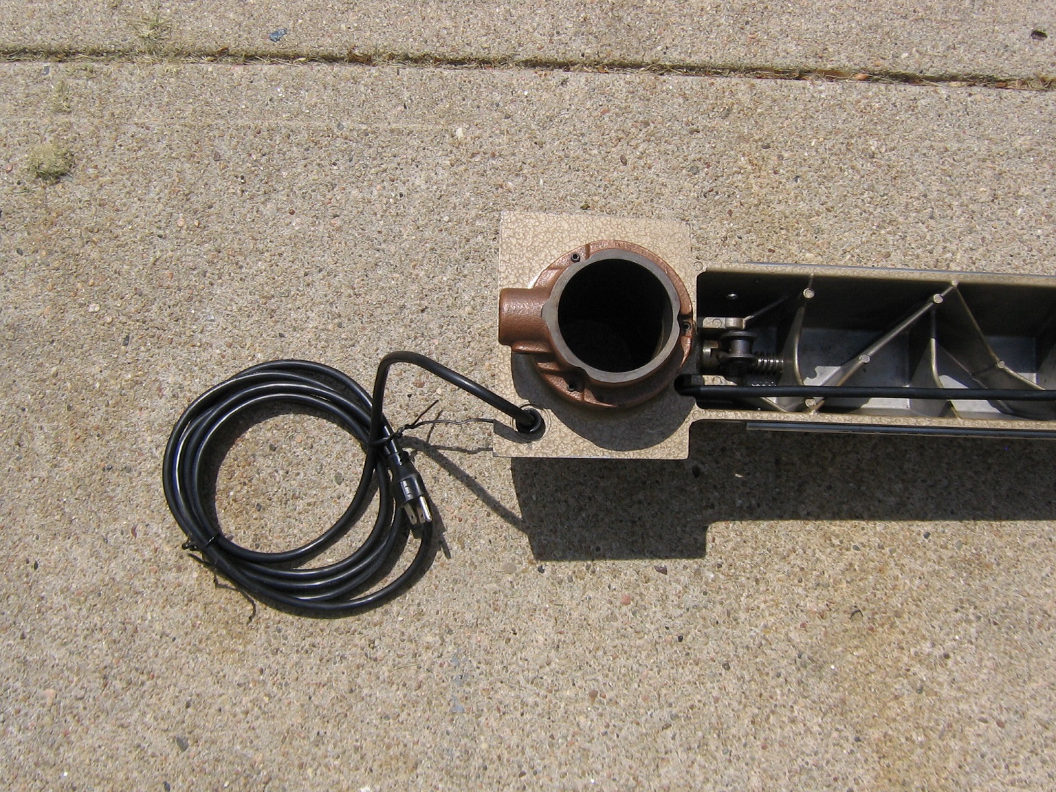

Here are pictures of the power cord installation I did today on the arm of my Sawsmith refurbishment.
New Shopsmith cord installed on Sawsmith Arm
Cord is held to arm with bracket & screw
strain relief holds cord in place

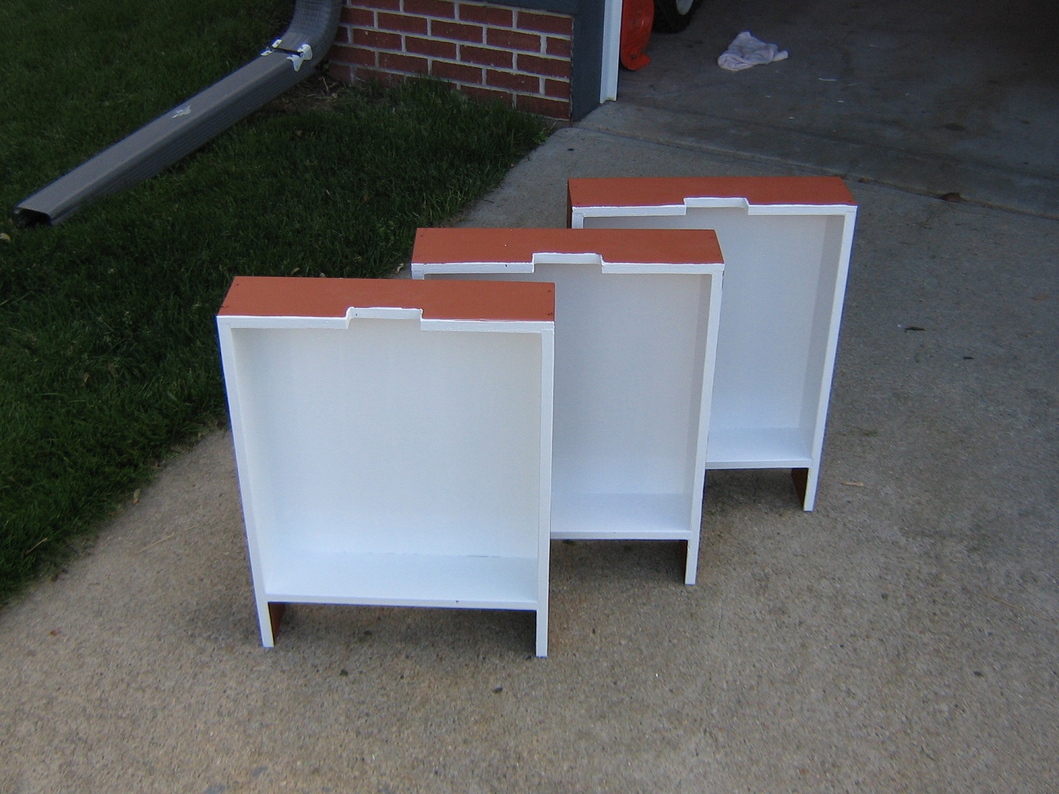

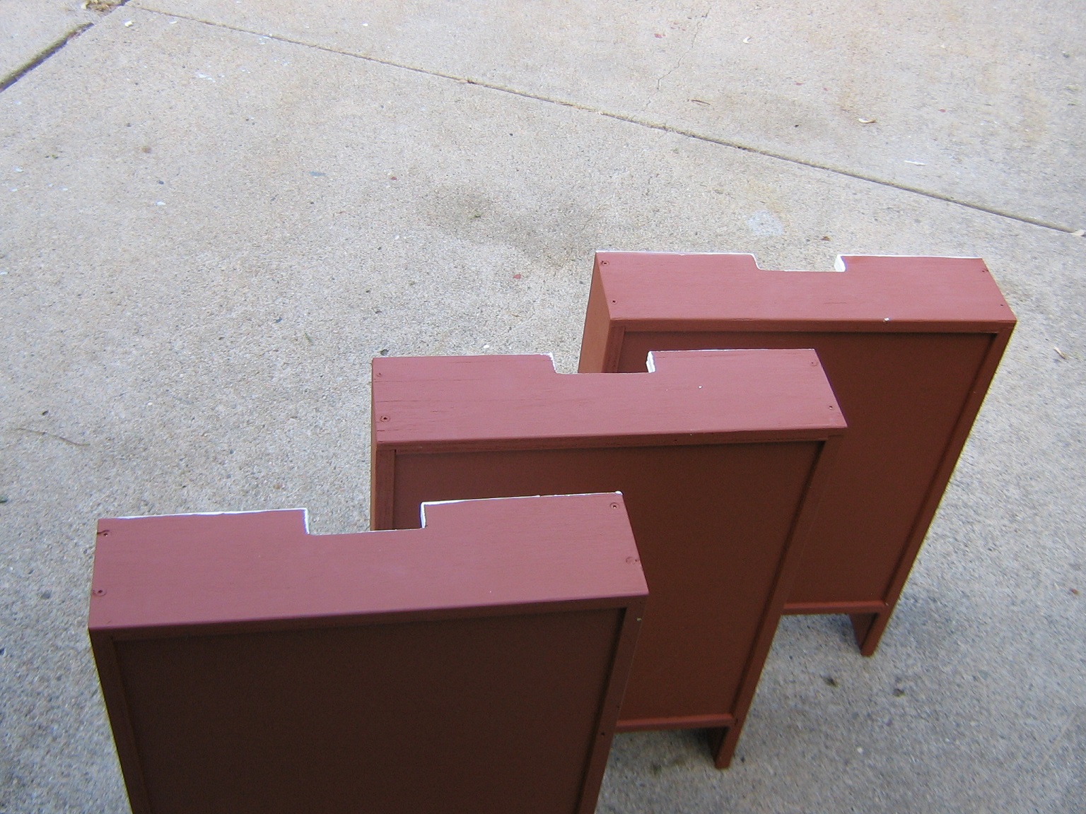

Sawsmith Base Cabinet Drawers

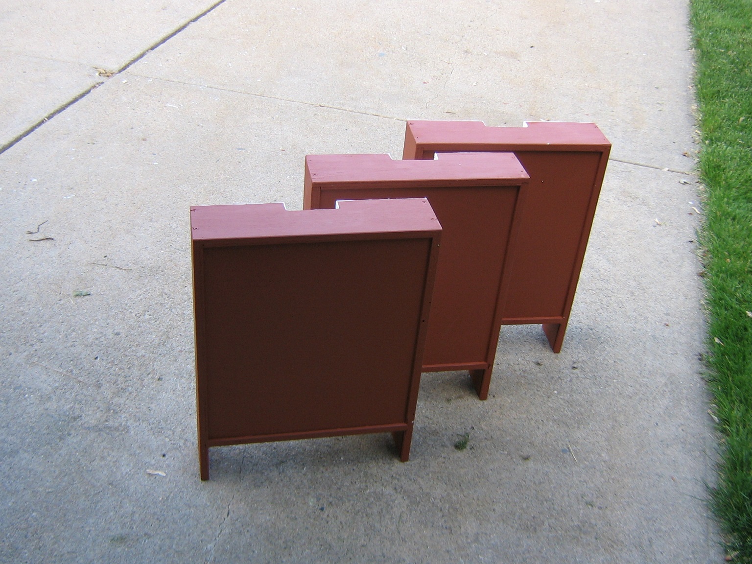

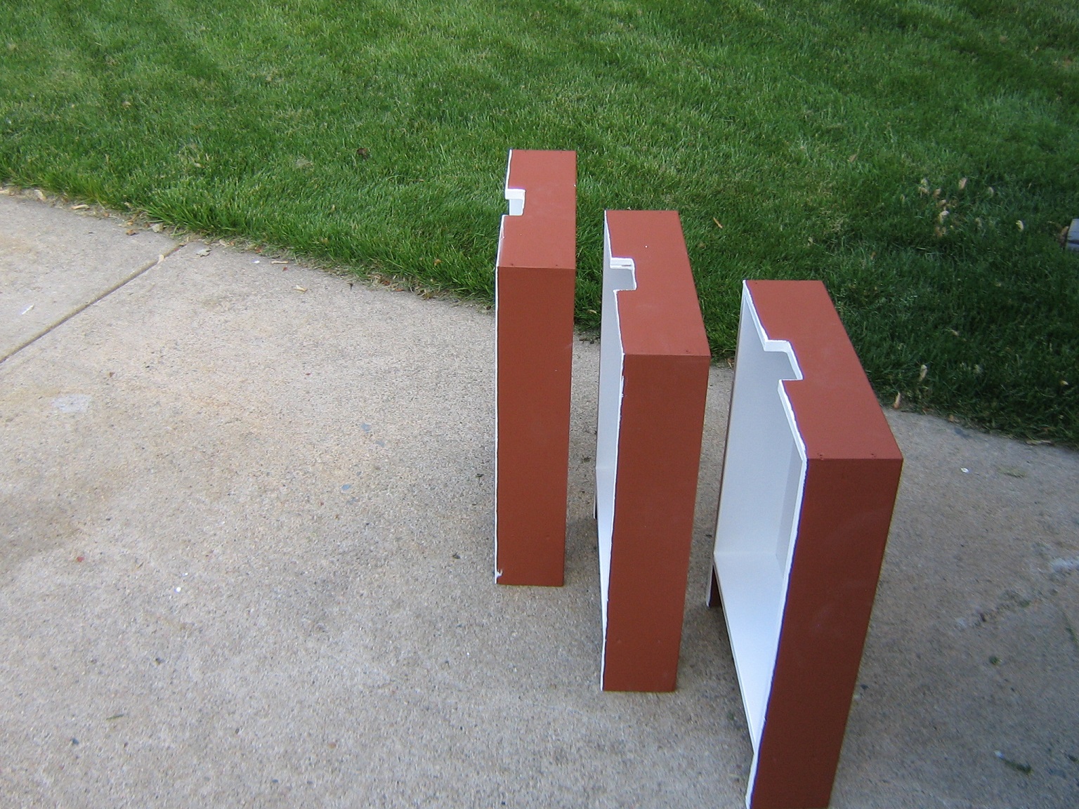

I finished the drawers this morning. The exterior is finished with Pittsburgh Ultra exterior wood stain. The interior is finished with Pittsburgh exterior semi-gloss paint.

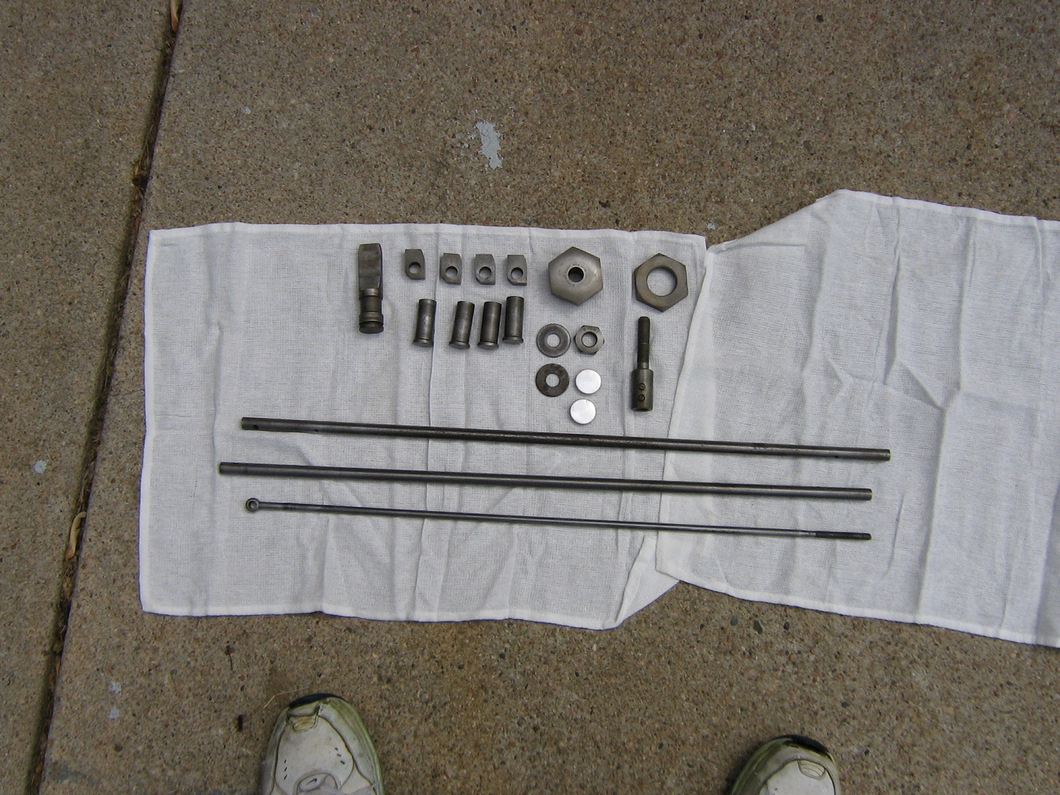

Sawsmith Refurbishment Rust Removal Done
It has been almost two weeks that I had the rusted parts sitting in the potato water. Today I opened the containers, removed the parts and just rinsed them off with the results shown. Absolutely amazing results with no elbow grease involved! Next time I will wear plastic gloves; the stench of raw sewage permeates my hands and I can't get the smell out even after using lemon juice. However, after 24 hours it is gone.
Sawsmith Parts after rust removal

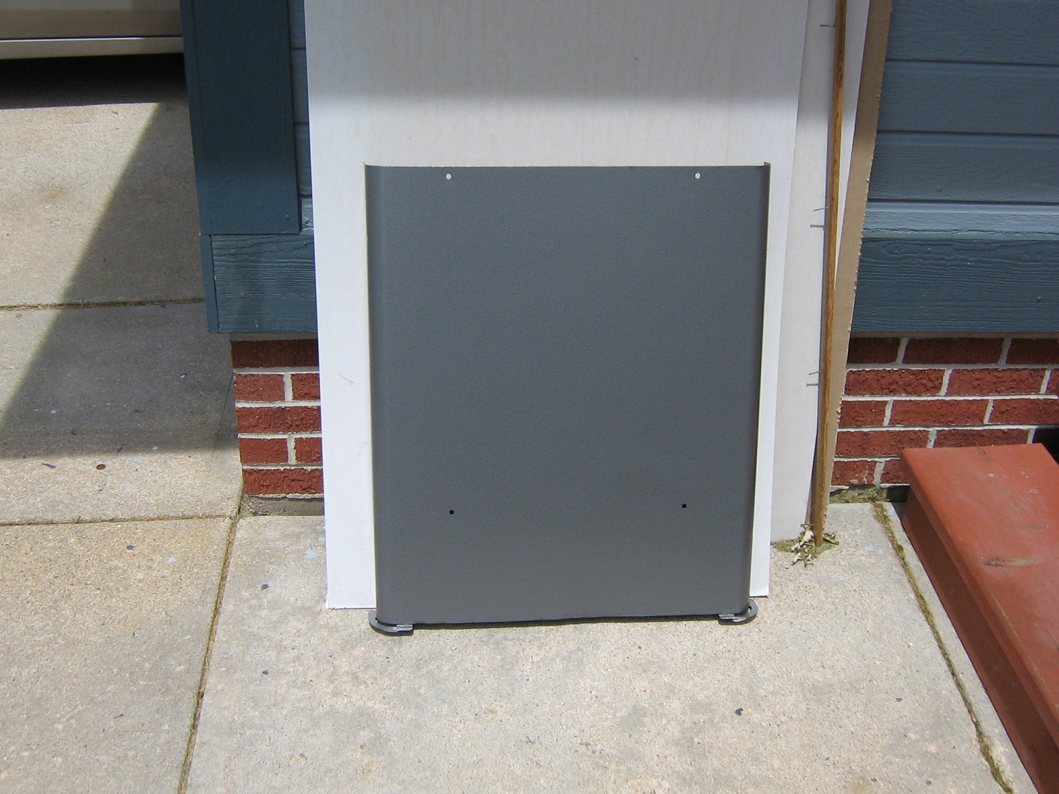

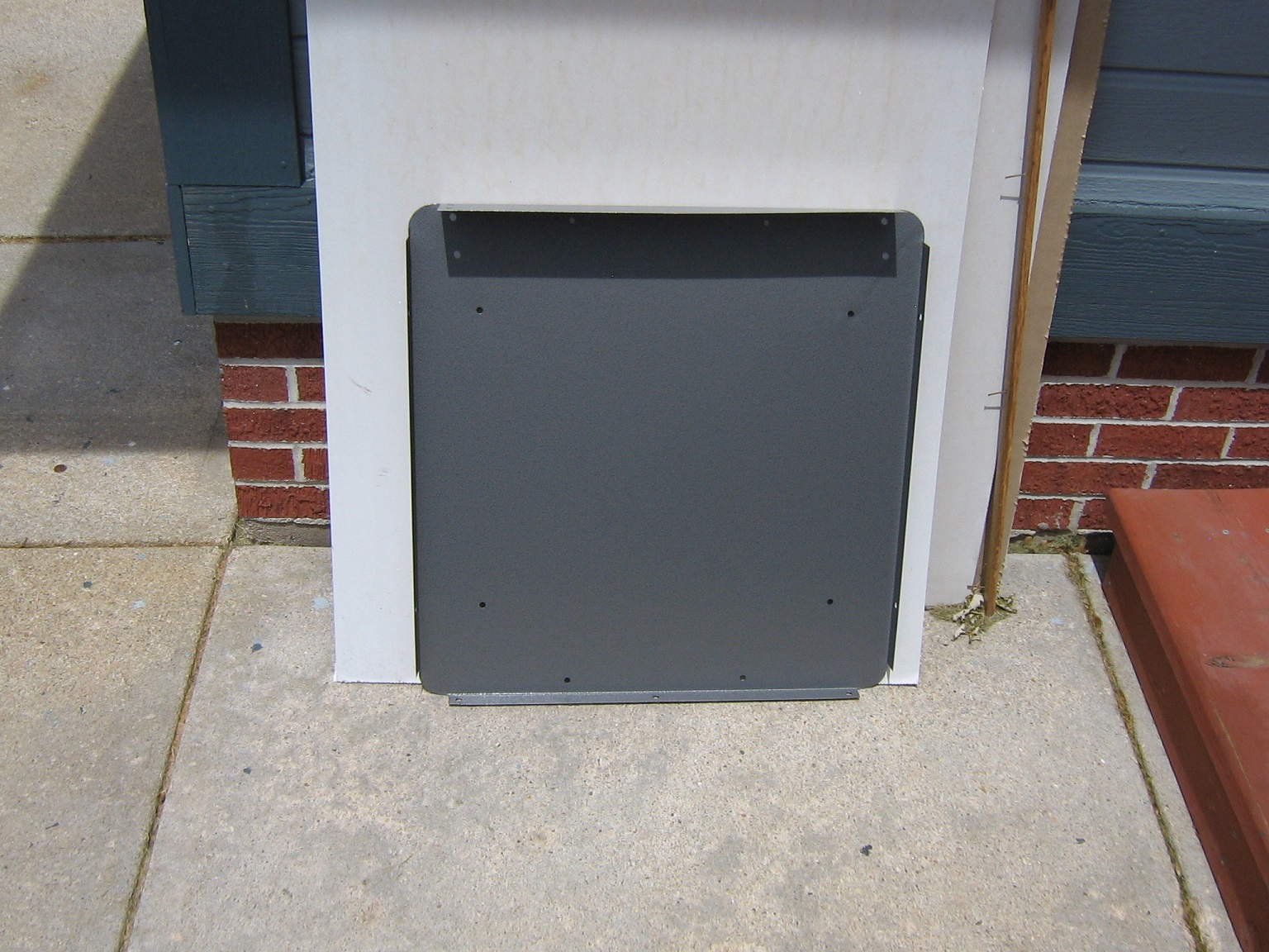

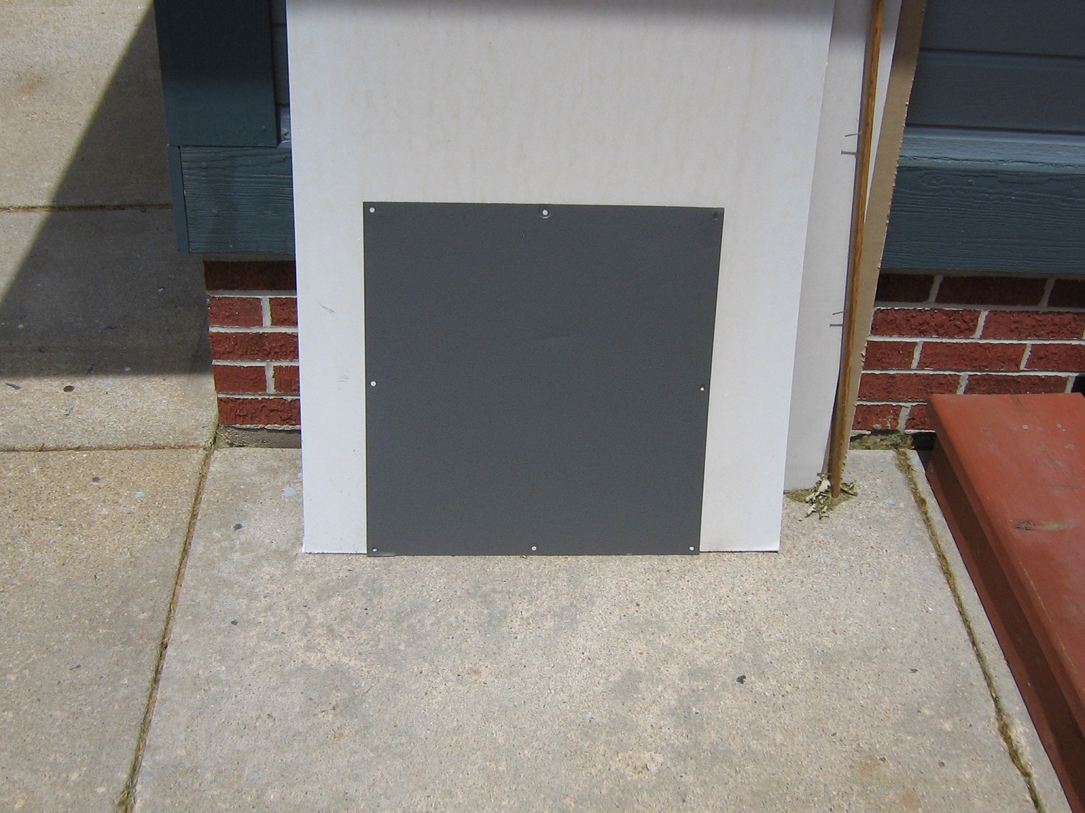

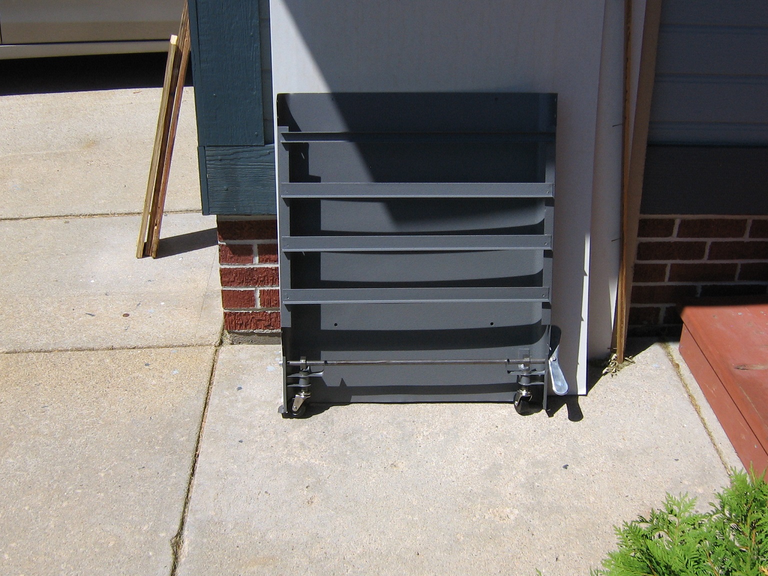

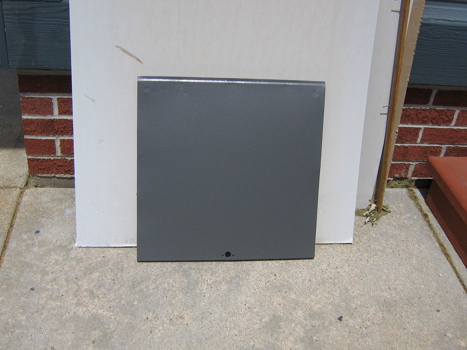

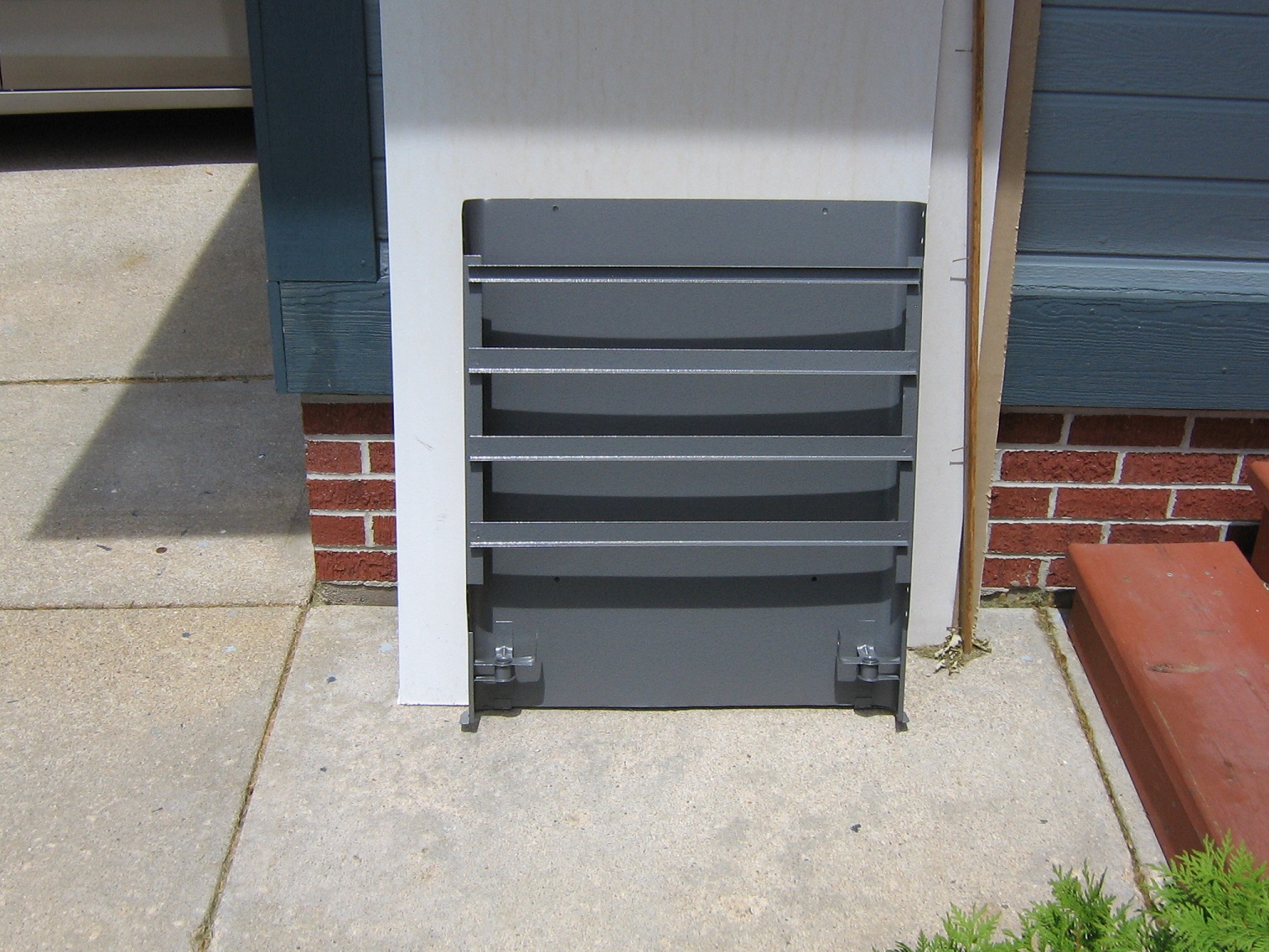

Sawsmith Refurbishment Base Cabinet Powder Coated

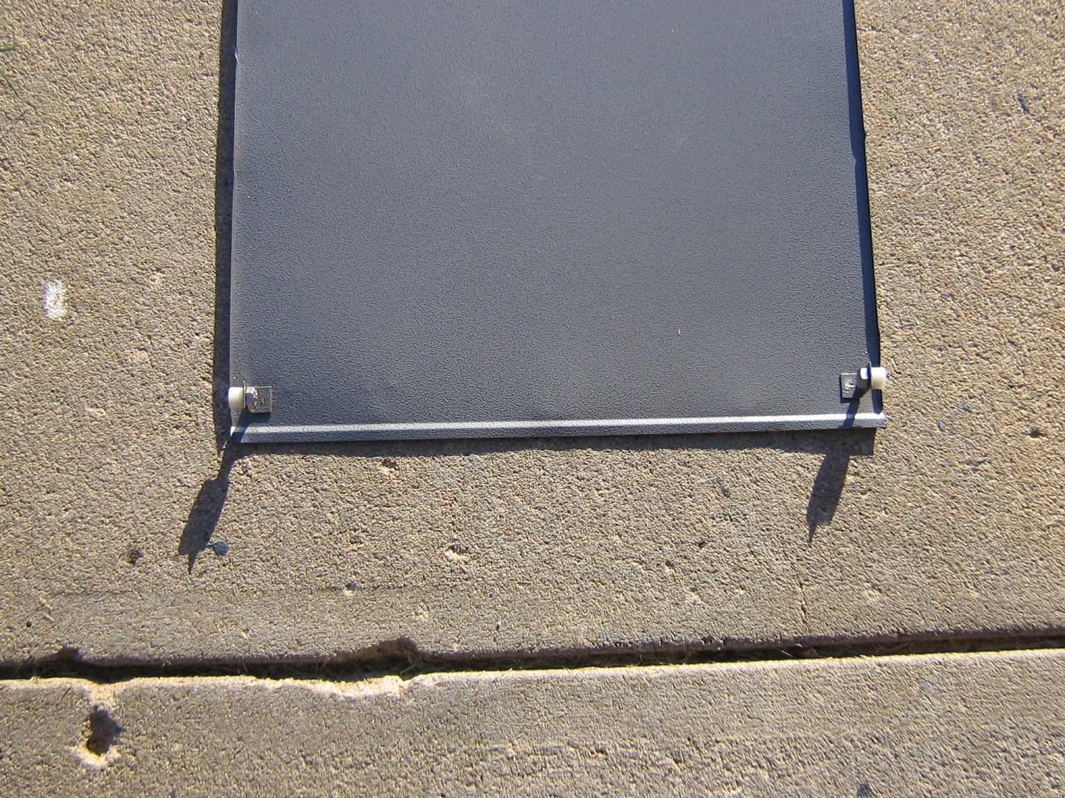

I picked up the six pieces to the base cabinet today from the powder coat shop. They sandblasted everything down to bare metal and then did the powder coat paint. It turned out just beautiful but pricey, just under $300. Here is the inside of one of the sides.
Here is the outside of one of the sides.
Here is the top.
Here is the front door.
Here is the back.
Here is the side with the all the caster mechanism installed. Handle was polished and waxed. Installed with stainless steel hex bolt and locknut. New casters work just fine. They are better than the original. These have ball bearings on the swivel.
Here is the front door with the glides installed. I used a stainless steel hex bolt 3/8-24 fine thread 1/2 inch long with a nylon spacer 5/8" OD, 1/4" ID, 3/8" long. I drilled the ID with a Q size drill bit and then tapped the threads but only 3/4 of the way through so it would not come unscrewed after installation. Adjusted it to turn freely, lubricated with light machine oil same as the caster mechanism.
