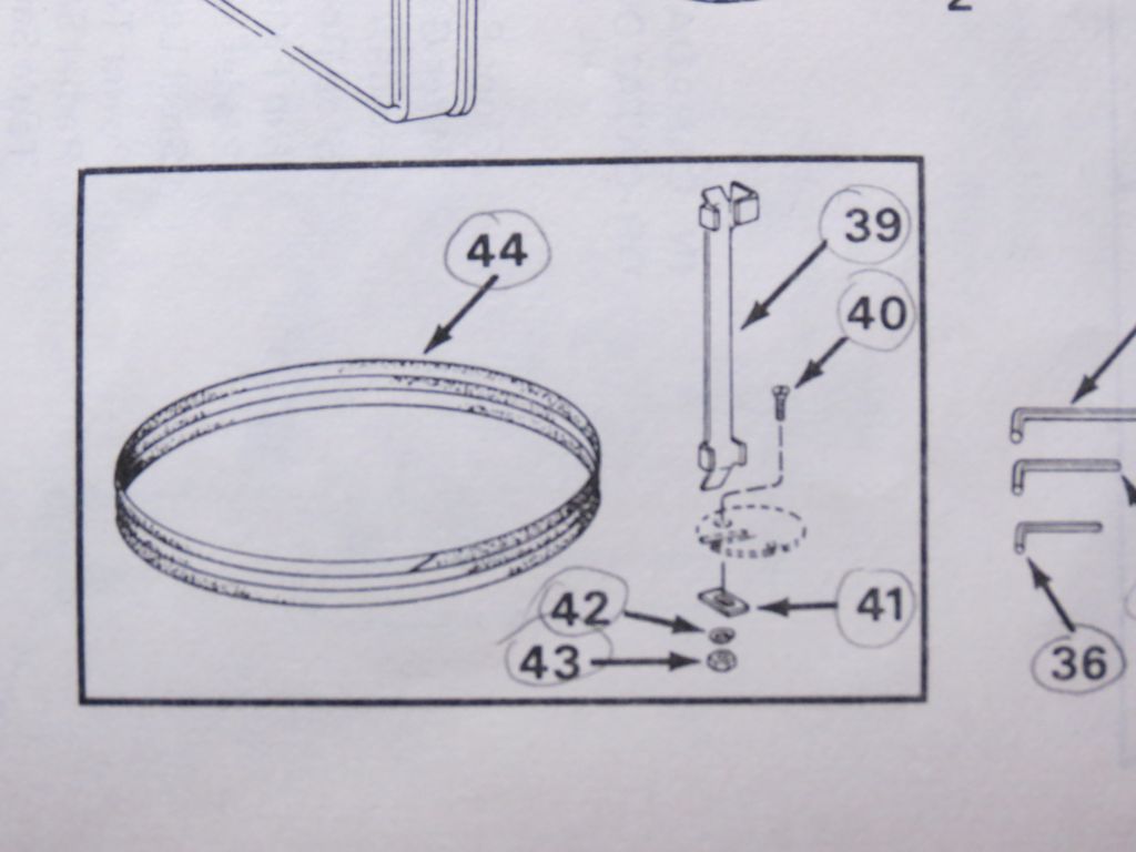

Re: Hammer Drop...?
These are the parts to do the conversion for my saw. Not much to it.

Re: Hammer Drop...?
Y'all need to determine how the leather belt will like the two guide bearings. I doubt the leather is 'stiff' enough to survive for long.
Re: Hammer Drop...?
JPG wrote:Y'all need to determine how the leather belt will like the two guide bearings. I doubt the leather is 'stiff' enough to survive for long.
Well this was a sanding belt thread but if you change the leather to sanding belt JPG has pretty much killed this idea. On my other bandsaw you have control of the tilt of the upper wheel and thus you control where the blade or sanding belt sits on the wheel and this dictates where the blade/belt is running. On the shopsmith there is no such adjustment and that function is taken care of by riding on bearings. The sanding belt will not be controlled by the bearings without major wear.
If you have another bandsaw then the shopsmith then you should be able to get it to work.
Posts: 6584
Re: Hammer Drop...?
I forgot about the uniqueness of the SS band saw. You and Ed are perfectly correct. The issue is tracking and because the SS band saw has a different tracking system it will not work.

Post by thedovetailjoint »
You beat me to it! Yes, the problem with using the SS BS as a strip sander is the Auto-Tracking that would cause the belt to drive toward the back of the saw from and into the back-up bearings, distroying the belt and eventually the bearings. If you haven't used one the SS strip sander is quite bullet proof and effective. Scott
