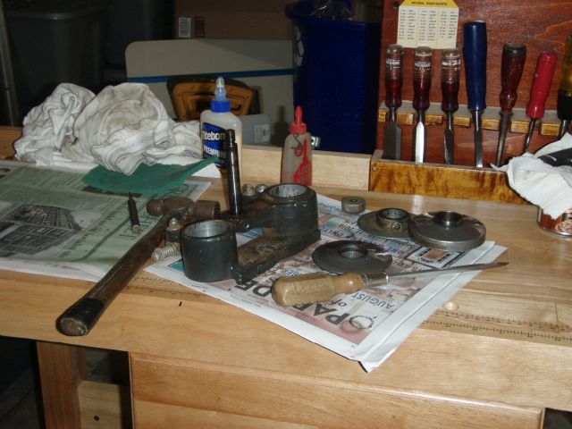

I have a Speed Changer from the last purchase on the work bench apart, the Sheaves are all nicely polished from 60 some years of use. I put my straight edge on all of them, they have, all equally about 1/64 of day light in the middle of them from the inner edge to the outer circumference. Do you think this by design or wear?

I would guess wear.

Mine too since his son said he used it as a lathe mostly. I did not have anything to compare it to since the other SC are in service.JPG wrote:I would guess wear.
Re: Just for giggles and curiocity!
My 'reasoning' was the center almost always has the belt rubbing, whereas the inside and outside will only rub at the relevant speed setting.ERLover wrote:Mine too since his son said he used it as a lathe mostly. I did not have anything to compare it to since the other SC are in service.JPG wrote:I would guess wear.

Does not depend on where he belt is at the most? Also I am thinking of ruffingJPG wrote:My 'reasoning' was the center almost always has the belt rubbing, whereas the inside and outside will only rub at the relevant speed setting.ERLover wrote:Mine too since his son said he used it as a lathe mostly. I did not have anything to compare it to since the other SC are in service.JPG wrote:I would guess wear.
up all of the Sheaves, on the rebuilt one since using a Cog belt that runs on it sides for a touch better grip on the Sheaves?? They are supper polished,smooth, maybe so 220/320 wet and dry?
JPG here is how they look, soooo smooooth.
- P6230274.jpg (71.31 KiB) Viewed 1755 times

I think smoother would be better. The belts slide into the pulley as they rotate. Tension and wedging provides the drive motion.
I have not put a straight edge on the two I have refurbed but they are definitely not straight/flat. I just attributed it to ware. It does not seem to effect anything. I polished all the sheaves and they work just fine. I have 3 more to refurb which I have not looked at critically but I expect to see the same unevenness.ERLover wrote:I have a Speed Changer from the last purchase on the work bench apart, the Sheaves are all nicely polished from 60 some years of use. I put my straight edge on all of them, they have, all equally about 1/64 of day light in the middle of them from the inner edge to the outer circumference. Do you think this by design or wear?

JS, do you think I should ruff them up a bit, 220/ 320?
I don't think so. I bead blasted mine with 80 grit glass. Then I chucked them up on the Power Pro and used 400 then 600 wet/dry paper. Then 0000 steel wool.ERLover wrote:JS, do you think I should ruff them up a bit, 220/ 320?
If you use the raw edge FHP belts that Tom and Skip sell there is no problem. Besides the belts are going to polish the sheaves during use so your 220/320 grit is not going to do anything after a few hours of use.
