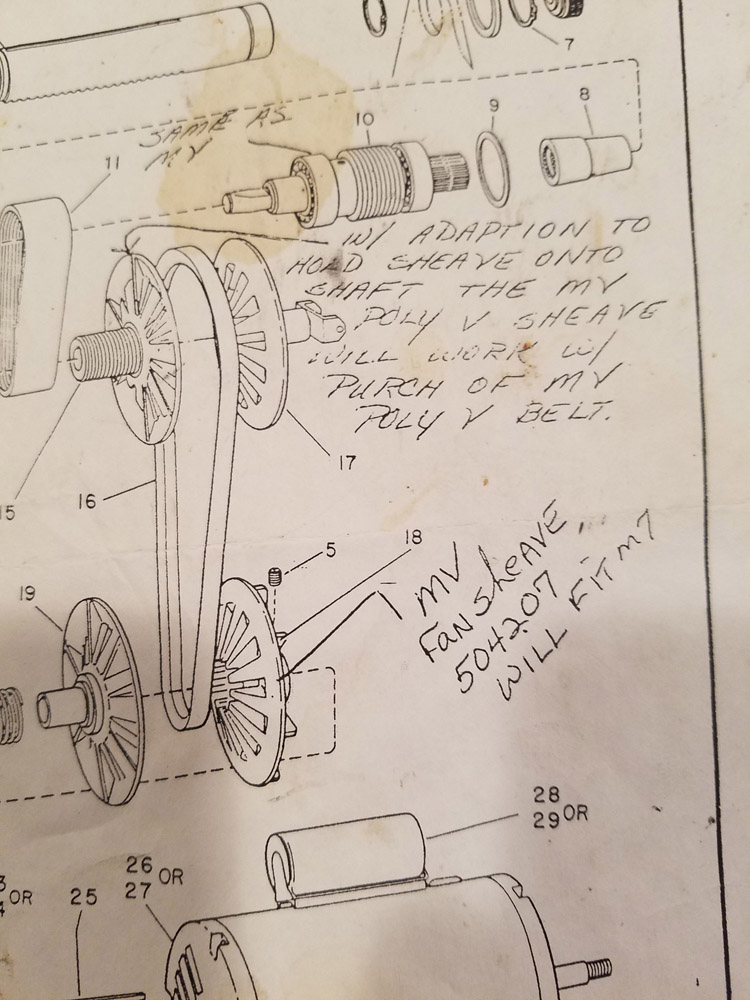

Ok, here are a few pictures. The original owner made some annotations on the parts manual that seem to be relevant to this, so I took a picture of that too in case it has meaning to you guys. Let me know if you need more/different pictures.
Re: Shopsmith Mark VII with Mark V speed control
Interesting! How about a pix of the 'operator' side.
Not perfect alignment, but appears functional.
I am curious why the fan sheave note. They essentially last forever.
