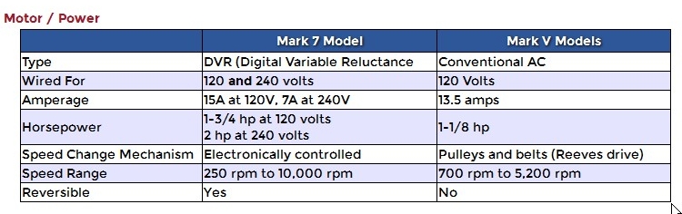

MOTOR DATA.jpg (102.27 KiB) Viewed 7945 times
Consider the numbers.
I assume all the current numbers are 'maximum'.
The power is greater.
The upper speed range is higher.
The 120v current is higher.
More HP(55 % greater) Faster speed(92% faster) at only a 11% current increase.
Yes I would say it is much more efficient 'overall'.
Allow for the power supply heat loss and the motor is even more efficient.
I simply do not understand WHY the 120v/240v current ratio is near 2:1 considering the power supply design(of which I assume a lot).
I dare say the 'average' motor power consumption is much less than the maximum listed with slow speeds and lower mechanical power output.

A modern motor drive is basically a switching power supply, and it behaves a lot like a continuously-variable transmission. It's much easier to think about it in terms of power flow, rather than current & voltage. The output power is simply the input power multiplied by the efficiency of the drive. Within limits, if the input voltage drops, the drive will adjust its duty factor to draw more input current, thereby maintaining the desired output power. The drive efficiency will generally be reduced somewhat at lower input voltages, but not hugely.
Here's a calculation of the combined motor/drive efficiency at rated output power for each of the two input voltages. (I've assumed that the power supply has power-factor correction circuitry on it's input, and thus draws a sinusoidal input current). Those calculated efficiencies both look reasonable in comparison with similar technologies, and 89% is very good indeed.
Shopsmith didn't included the rated speed specification (which is generally the speed at which a motor can generate the maximum continuous power), but you can be sure that there is one. If you get too far above or below the rated speed, the continuous power capability of any electric motor falls off, eventually going down to zero at both ends.
