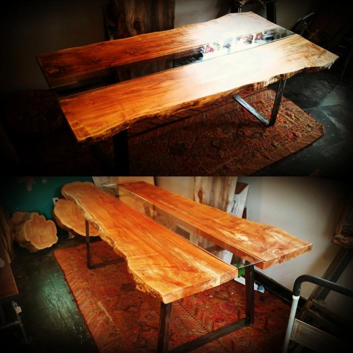

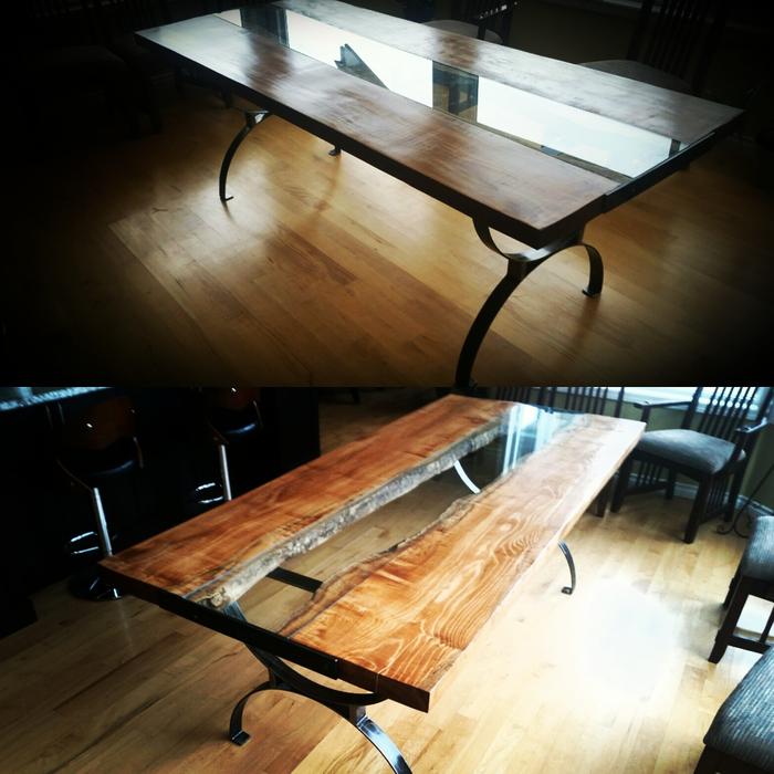

Fill the middle in some contrast always looks good, but modern. Glass even more so. Even cut somewhere in the middle, preferably at an angle, and just space the pieces apart. Saw a dude cut and space, then fill with epoxy and LED's, very Tron.

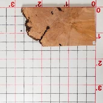

Thanks to all, for lots of good ideas, but I did not make myself clear. Here is an image of the slab, which is amazingly close to a map of Montana, where I spend part of the year:
I do not want to cut or otherwise change the perimeter or dimensions of the slab, so splitting/cutting the slab and the breadboard ideas will not work for me. The 2 1/2' dimension is the one I would like to extend somehow to make it more usable as a coffee table.

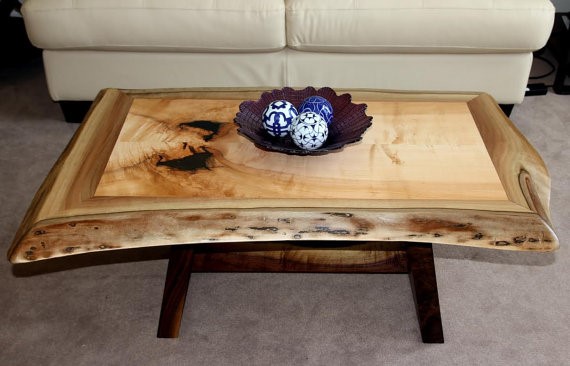

Here is a slab with a live edge surround (that would increase the outside dimensions), but I do not know how to deal with the irregular 4th side of my slab (the western border of Montana side of the slab):
Any other thoughts on how to use my slab as a coffee table?

I still think the glass would work. If you cut it at about the 1' mark on the 2 1/2' side and put an inset of glass or a contrasting type of wood. This would allow the odd shaped end to be the actual edge of the table.

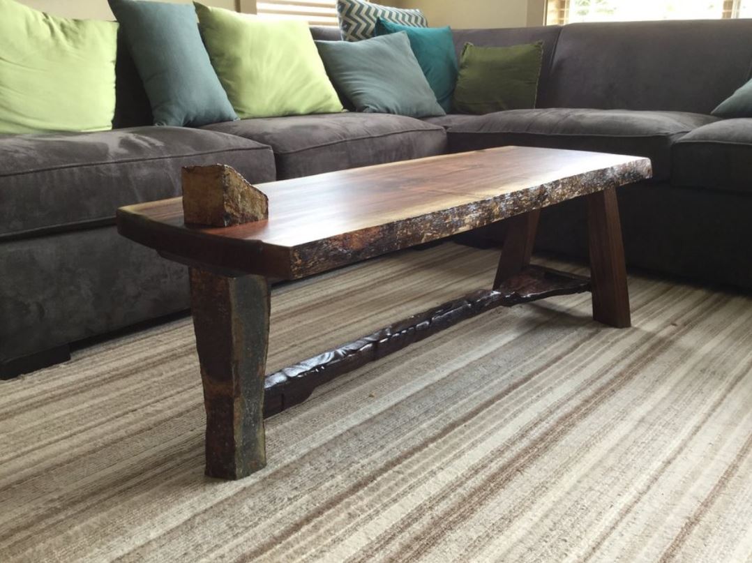

How about going with an intentionally asymmetric look? You could join another slab to the square-cut end (in a contrasting wood, if you like), to extend the length however much you wish. I just wouldn't make it half-and half. Maybe try the "golden ratio". I'm thinking some massive dovetails or box joints for the joinery ... that would add a lot of visual interest. Or a butt joint with butterflies top and bottom .. you can do those with a router. But first, I'd recut that end at a slight angle, or better yet a curve.
If you want it wider as well, add full-length strips to each side. But since we're doing asymmetric, I'd probably make those different widths. They would make the fancy slab joinery unnecessary, structurally at least.
Then finish it off with an asymmetric understructure. The pic below might give you some ideas on that.
