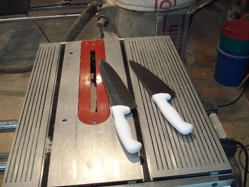

The knives:
shopsmith forum knife block pics 01.jpg (443.85 KiB) Viewed 5509 times

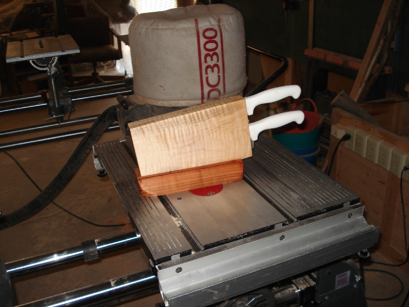

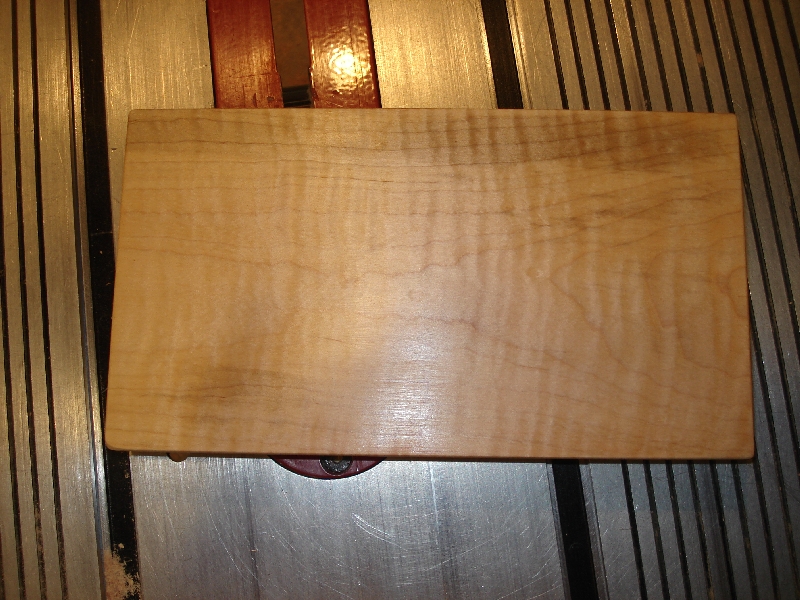

Take a block of Maple (thank you Dennis) :D
shopsmith forum knife block pics 02.jpg (407.05 KiB) Viewed 5509 times

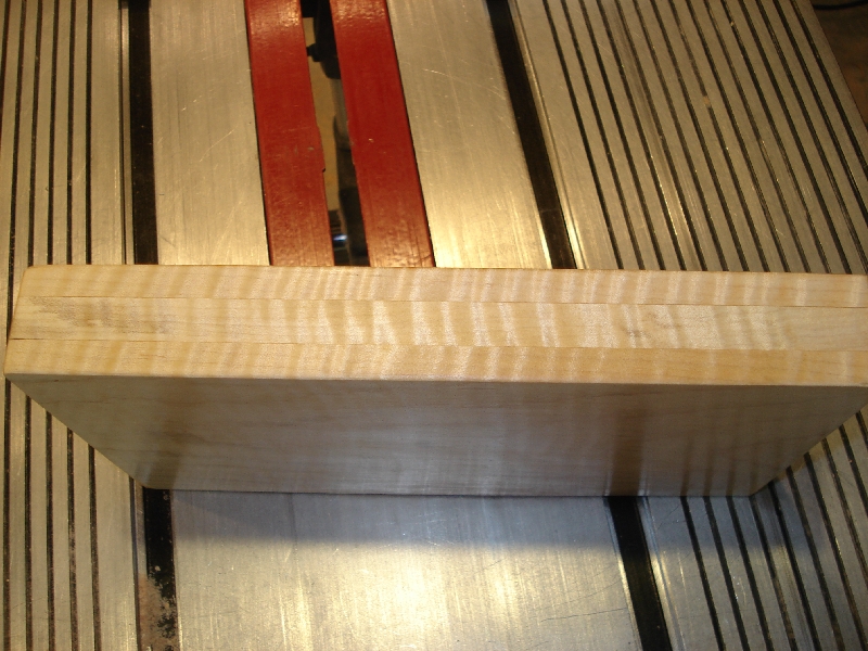

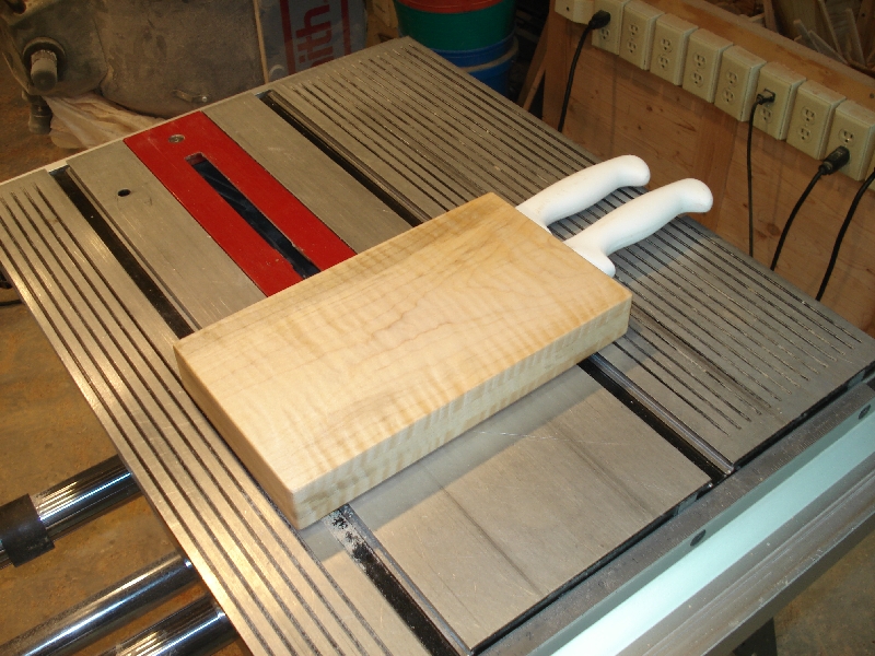

Resaw into three pieces and route the knife shape into the center panel.
shopsmith forum knife block pics 03.jpg (393.04 KiB) Viewed 5509 times
Looks kinda silly just laying there ...
shopsmith forum knife block pics 04.jpg (419.24 KiB) Viewed 5509 times

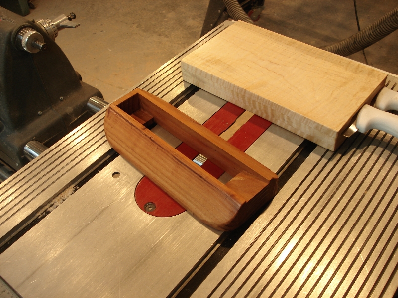

So make a base for it ...
shopsmith forum knife block pics 05.jpg (432.94 KiB) Viewed 5509 times
Insert block in base ...
shopsmith forum knife block pics 06.jpg (372.49 KiB) Viewed 5509 times
TADA! Wife is happy .... :cool:

Nice job, and nice wood. How did you get the slots in the board? I missed it. Thanks for the explanation.
Steve, the old swampgator
rjent
Posts: 2121
Re: A tale of two knives
Post by rjent »
swampgator wrote:Nice job, and nice wood. How did you get the slots in the board? I missed it. Thanks for the explanation.
I just traced the knife blade(s) on each side of the center part. then routed an eighth inch inside the trace and then glued it back together. It may collect too much moisture inside, but we will see ...

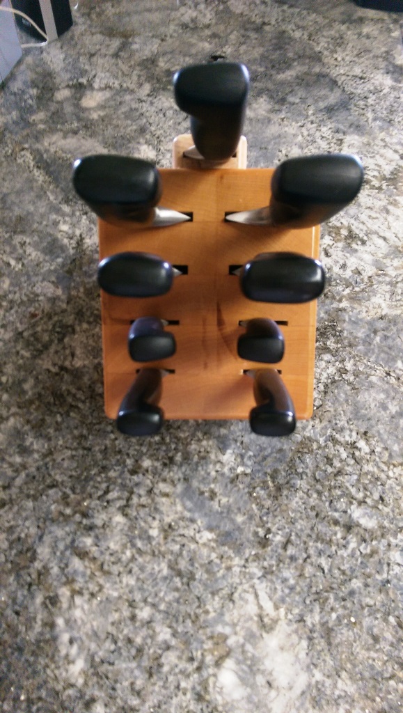

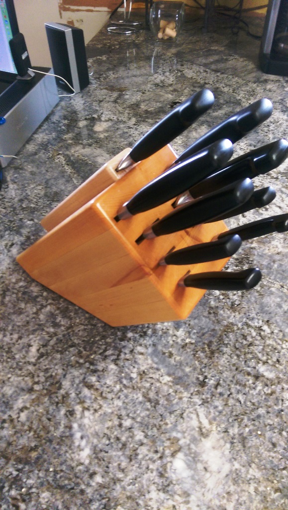

I had to do the same thing. I am the cook in the house. Not because my wife can't cook but because I love to cook and she loves the fact that I do it and when we have soul food she cooks.
I have a set of 8 J A Hinkles Twin 4 Star knives. All I thought I would ever need/want. I had a VERY old (my mothers I think) bread knife that I used all the time and worked very well. Then one day the Hinkles Twin 4 Star bread knife came on sale. Time for a new bread knife.
Arhg! I had made a Maple block to hold the 8 knives I thought I would ever need. Now I have one more. So I added a small block to the back of the big block to hold the bread knife. The color of the wood does not match but that is OK. It works just fine.
I also have a Chefs electric sharpener with 3 positions. I use it once a year and use the Hinkles manual honer almost every time i use one of the knives. Works very well.
