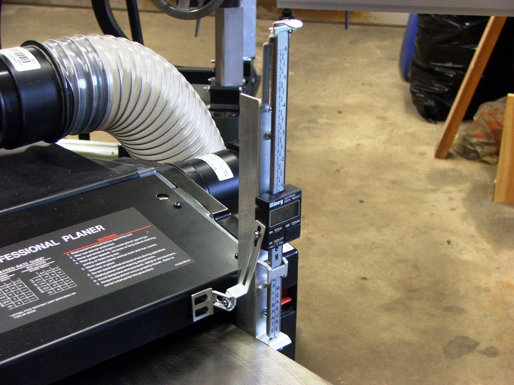

My question is why do both of you prefer the round wheel over the crank? Is it because of the scale on the wheel? I have the newer Pro Planer with the crank that I bought new from the MS in about 2006. I have not used or even seen the other one with the wheel.
I added a Wixey digital readout in 2007. At that time the Wixey was designed for Lunch Box planers. Now Wixey has the remote planer whatever readout. That probably would have been easier to adapt to the SS.
Anyhow, the Wixey is dead on when the board is measured with a dial caliper. The Wixey reads simultaneously in decimals and fractions.
But the point is that if I plane a piece of stock to an even fraction on the Wixey (or any other dimension) and measure with my calipers they are pretty much dead on. Then if I turn the SS crank to take off a certain amount (1/32",ie.) Wixey, the stock and the dial caliper agree. So when the SS Pro Planer is tuned up the crank rotations on the Pro Planer with the crank not the wheel are dead on. I see no reason to have a gauge on the Wheel/crank.
So the question again is why do you prefer the wheel over the crank?

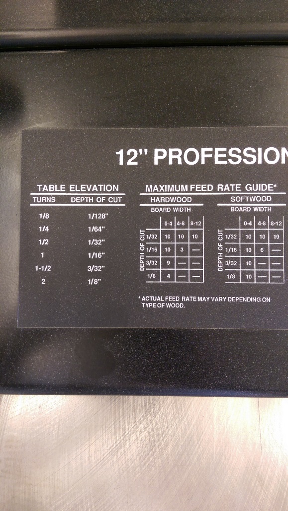

I just spent some time this evening checking the operation of my recently aquired planer and it works like a charm, even after I dropped it on the way to my basement in the stairwell (concrete steps, and on my foot) (why I need the crank).
I do have a caliper that I use to check thickness and gauge blocks and the like. You have a very nice setup there with the wixey thingy. My planer does not have the sticker telling me about max. feed rates, that's a nice touch.

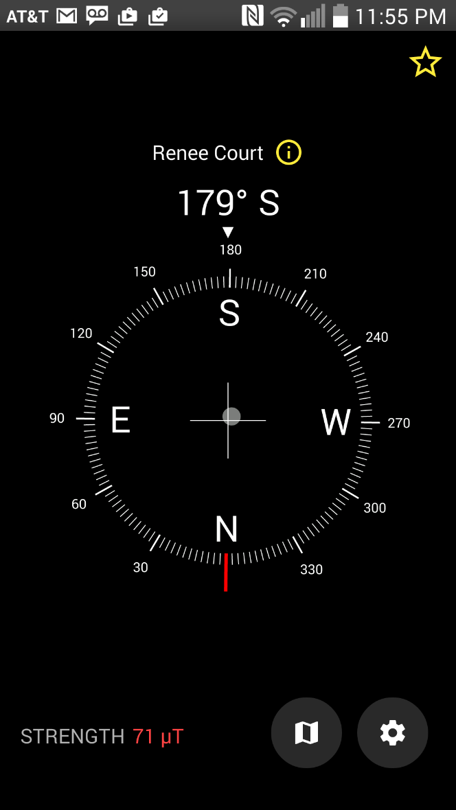

Well shucks, I was perfectly happy with the crank handle on my pro planer. Until now.
But I think I have a solution that would make Red Green proud. I can just stick an old smartphone to the crank handle with double-sided tape, and fire up the compass app!
Or course, Red Green would have used duct tape.
