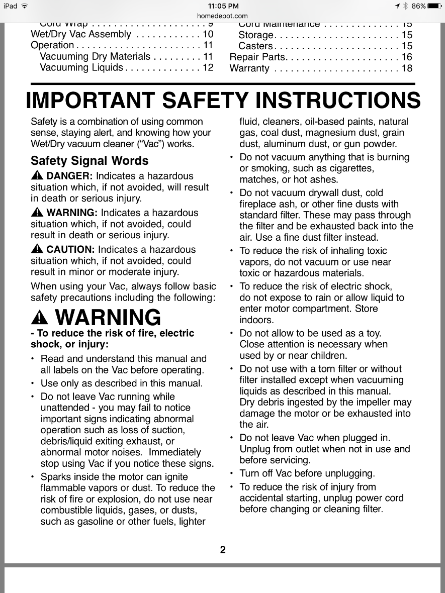

A large shop vac is planned to be exhausting fumes from the room, for both types of finish. If anyone has reason to believe that exhausting shellac/alcohol fumes through a shop vac is an explosion hazard, speak up now, lest I forever rest in peace!

Hmmm. Looks like using my Ridgid vac as an exhaust fan/duct might not be such a good idea ...

Any unsealed motor can cause an explosion IF the air to volital ratio is in its explosive range.BuckeyeDennis wrote:Thanks, ERL, that was most timely.
