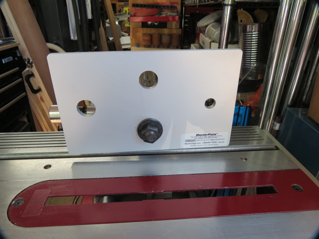

The following photos are a simulation but should give you an idea of how this works.
Located table with the left miter slot set so the master plate will slide in the miter slot. It will something like this:

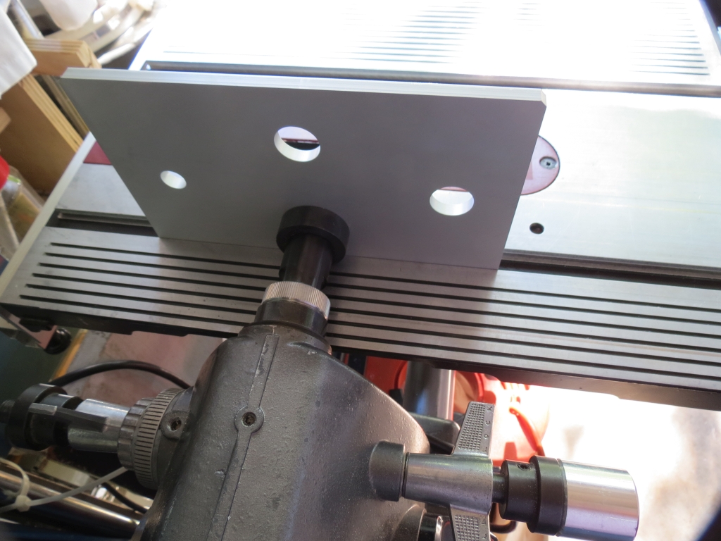

You then can raise the table as shown here:

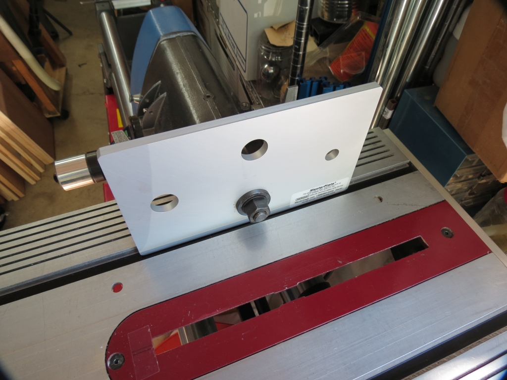

The table and carriage can then be moved to the right so the master plate is contacting the left edge of the left miter slot. At this point you will have to decide if you are happy with that location or have to work out how to center the blade in the table like Dusty likes. I personally have not addressed this but might in the future.
As you can see on this adjusted table the plate and slot are tight to each other. If the table is loose it will not likely be so.

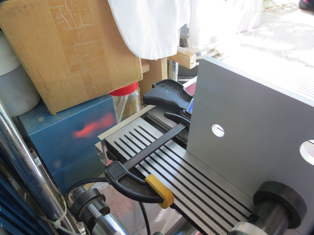

I use clamps from the table to the master plate to force the ends to the miter slot like shown here:
At this point you have to very carefully tighten the mounting screws as it is still possible to twist things. What ever method you have had success with in the past will work.
When you take off the clamps you can use a feeler gauge to check keeping in mind the plate tolerance and slot tolerance could show up as a few thousands.

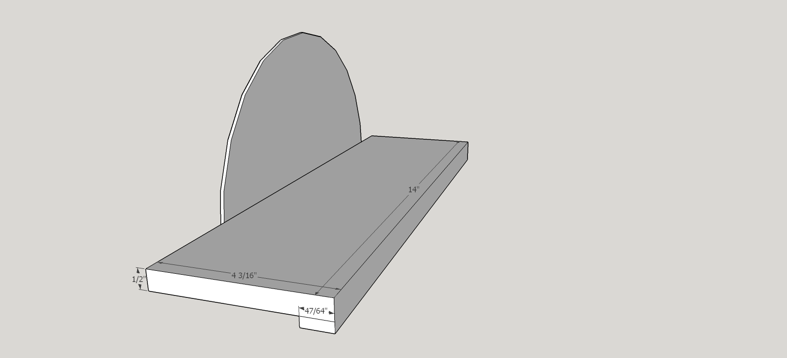

Based on other comments from the other current thread discussing this subject and my most recent experimentation with my setup plate, I drew up the following Sketchup to show where I am going with this. I aligned two tables in about 10 minutes using this approach.
Table Setup witha Thin Kerf.png (22.31 KiB) Viewed 4603 times
The dimensions given here will center a 3/32" thin kerf blade in the Mark V Main Table cutout. The quill most be fully retracted and locked and of course all other locks secured. Mount the thin kerf blade and arbor, loosen all four trunnion bolts and then push the table so that the jig (installed in the right hand miter slot) snugly contacts the blade. Tighten the trunnion bolts without allowing the Main Table to change positions. Check visually to ascertain the desired snug fit and you are done. Less than 10 minutes.
The overall width of the jig (4 3/16") is critical. The best way to achieve it, I believe is by attaching the runner (it is really not a runner but rather a stop) to the birch plywood. With the runner in the right hand miter slot, cut the jig to a little over the 4 3/16" dimension and then using the conical disk sander, sneak up on the 4 3/16" by utilizing the quill.

Alignment is no more or less accurate than any of the many other proposed methods but is certainly much quicker and I believe easier. This will be my method for awhile with the sole exception that I will use the setup plate and a jig with a slightly different dimension (4 11/64") to facilitate the 1/8" plate.
