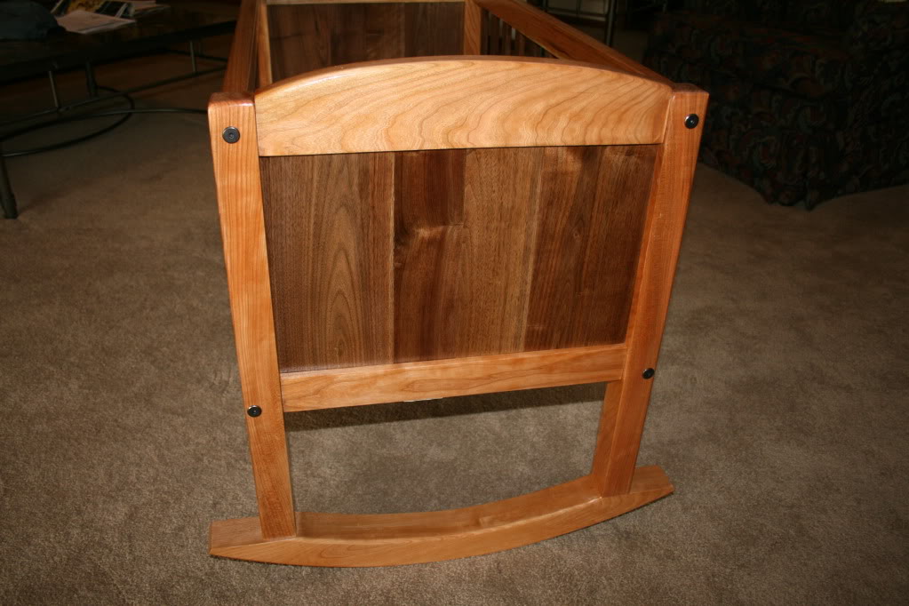

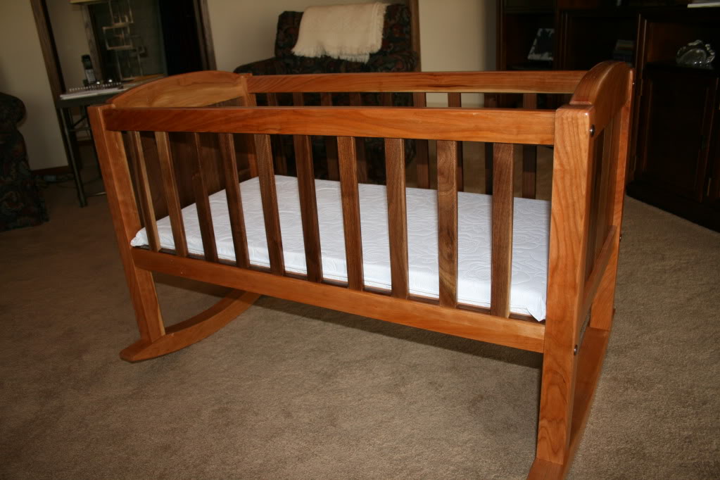

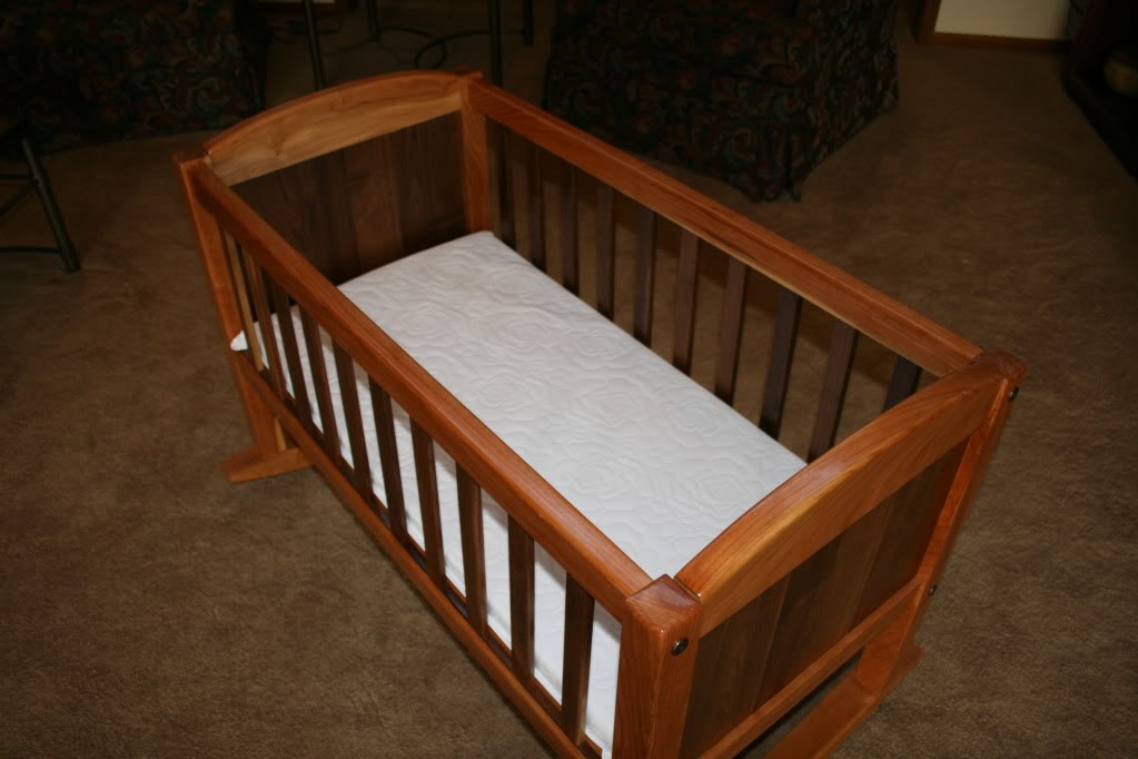

Walnut and Cheery I made for a grand child of a Great Man with MS I was his care giver for.
I have made many a crib, if Walnut not good for horses though!!!
- IMG_4847.jpg (102.84 KiB) Viewed 7278 times
- IMG_4850.jpg (75.63 KiB) Viewed 7278 times
- IMG_4852.jpg (106.8 KiB) Viewed 7278 times
ERLover

Ed/reible, that crib I made has furniture fasteners on the side, so when one is done the sides come off from front and back "rails", and the 1/2" Baltic Birch base for the mattress just lays flat in about a 20x 34"x 6" package.
I have been told that it is on its 3rd child.
