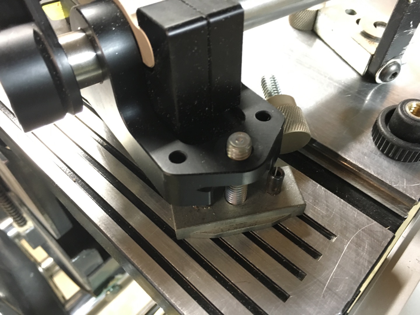

Since first seeing them, I knew I wanted a set of the Jessem table saw stock guides. I pulled the trigger over the weekend and they arrived today. I had suspected that they could be installed on the 520 fence using either Shopsmith T-nuts or Shopsmith T-bolts and I'm happy to report that they can be installed that way.
Below is a photo of the stock guides installed using Shopsmith T-nuts. The T-nuts are riding in the left slot on the 520 rip fence.
The Jessem miter slot extrusion comes pre-drilled to accept several different kinds of fasteners that come included. Among these are some 1/2 x 1/4-20 cap head screws. These are just about 1/32 too long. Grind em down just a bit and you can screw right through Jessem extrusion and into the Shopsmith T-nut to secure everything. Here you can see a close up showing the T-nut just showing under the Jessem extrusion.

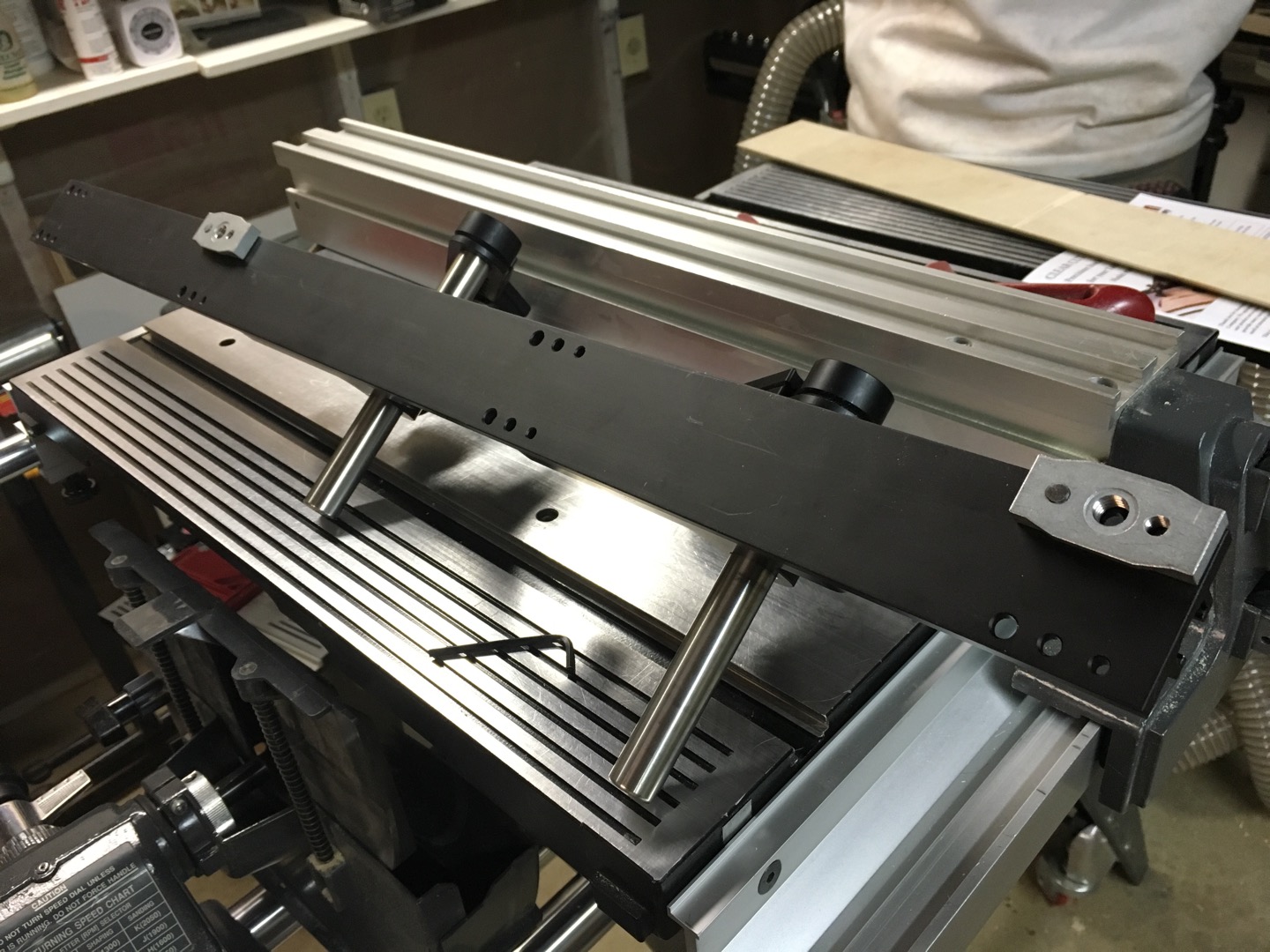

Here's a photo of the bottom of the Jessem extrusion showing the Shopsmith T-nut.

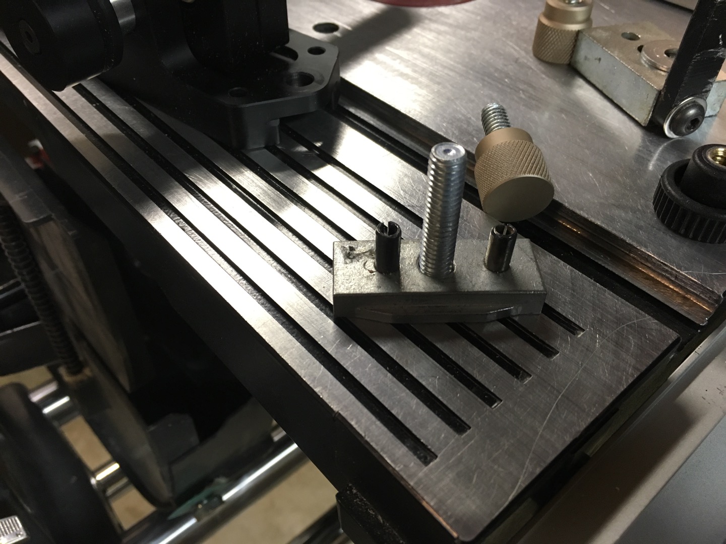

One could also dispense with the Jessem extrusion entirely and mount the hold downs directly to the 520 fence using the Shopsmith T-bolts, which have a central 5/16 threaded stud. I have the Shopsmith flip stops, which mount with T-bolts but also have roll pins, so I could only test the fit, but it seems perfect, as shown in the photos below (imagine no roll pins).
I may order some T-bolts but for the time being I will use the first method with the Jessem extrusion.

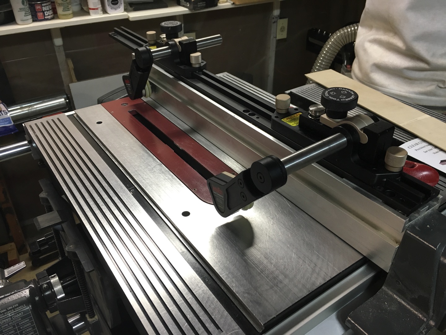

I've been using the Jessem table saw stock guides for a while now and feel comfortable writing a little review of them now.
I've used them when ripping sheet goods and boards of many different sizes. Today I used them to rip some 1 inch x 3/4 strips out of a walnut board about 5 inches wide by 3 feet long. Then I cut some 1/2 x 1/4 rabbets in the strips. The Jessem stock guides gave me an incredible sense of control when doing these operations.
For those unfamiliar with them, the spring loaded, angled wheels of the stock guides simultaneously apply a downward force on the top of the stock while drawing the stock toward the rip fence as the stock is advanced. The guides can be adjusted so the set of wheels on the infeed side are outside of the cut line while the outfeed set of wheels is inside the cut line. This helps reduce the possibility of kickback as the piece between the fence and the blade is controlled. Kickback is also reduced or eliminated because the wheels only rotate in one direction and cannot raise more than a small amount off the table. Thus, the work piece cannot be lifted and thrown back at the operator.
Once mounted to the fence, the stock guides are easily adjusted. Two brass thumbscrews on each guide adjust the front-to-back position of each guide. The height of each guide, as well as lateral adjustment is set using the large top knob.
Setting the height is absolutely critical but not difficult. Do NOT make the mistake of adjusting the height by placing the stock under the wheels! Per the instructions, slide the stock (or something of the same thickness) under the black bracket ONLY. Then tighten the top knob. The wheels hang lower than the bracket and thus using the bracket to set the height ensures the proper amount of spring-loaded force is applied to the stock once it is fed under the wheels.
I've annotated one of my previous photos to show where you put the stock to set the height of the guides.
