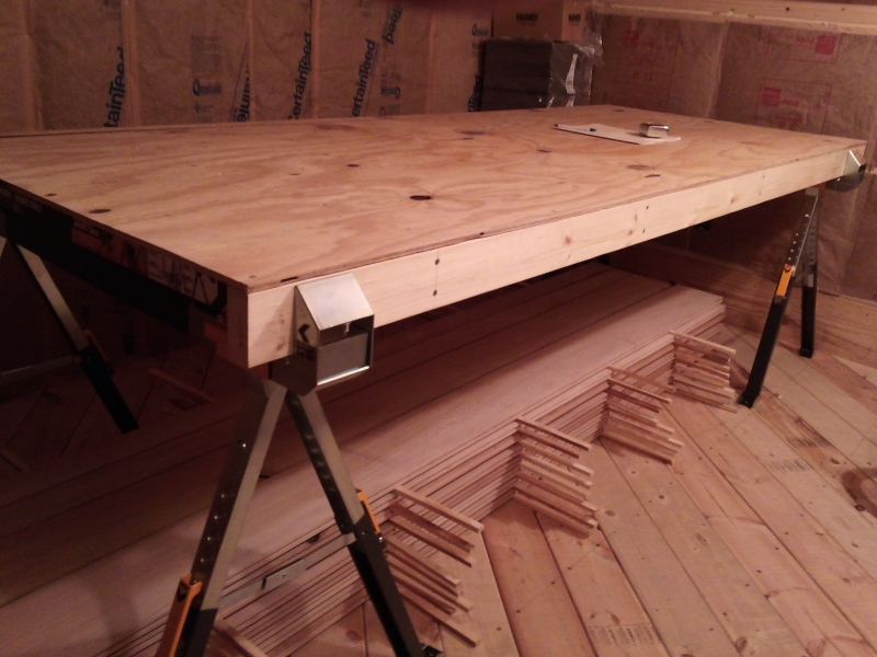

I really like how he can use the dog holes to set up 90 degree crosscuts. I made the portable worktable below a couple of weeks ago for my secret-room project, and I may yet steal that idea. My table is intended both for trimming the T&G paneling boards (stacked beneath the table) with a Makita track saw, and for supporting them while sanding & sealing.
The cool fold-up sawhorses are from HD. Total out-of pocket costs was about $110 for the sawhorses and 2x4's, and I used some 1/2" ply that I already had on hand. You normally wouldn't have to, but I screwed the plywood to the 2x4 frame because it had been stored in my garage for many years, and needed to be drawn flat. I can unscrew it easily enough when I need to.

Now this is what I call versatile. I will have a near duplicate of this soon. The main difference is that mine will reside on either the rear patio (under cover) or right outside my shop (garage) door. I will have to paint mine because it will be exposed to the weather. This will be an ideal extension to my shop.BuckeyeDennis wrote:I really like how he can use the dog holes to set up 90 degree crosscuts. I made the portable worktable below a couple of weeks ago for my secret-room project, and I may yet steal that idea. My table is intended both for trimming the T&G paneling boards (stacked beneath the table) with a Makita track saw, and for supporting them while sanding & sealing.
