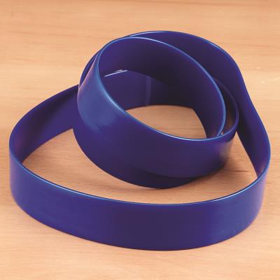

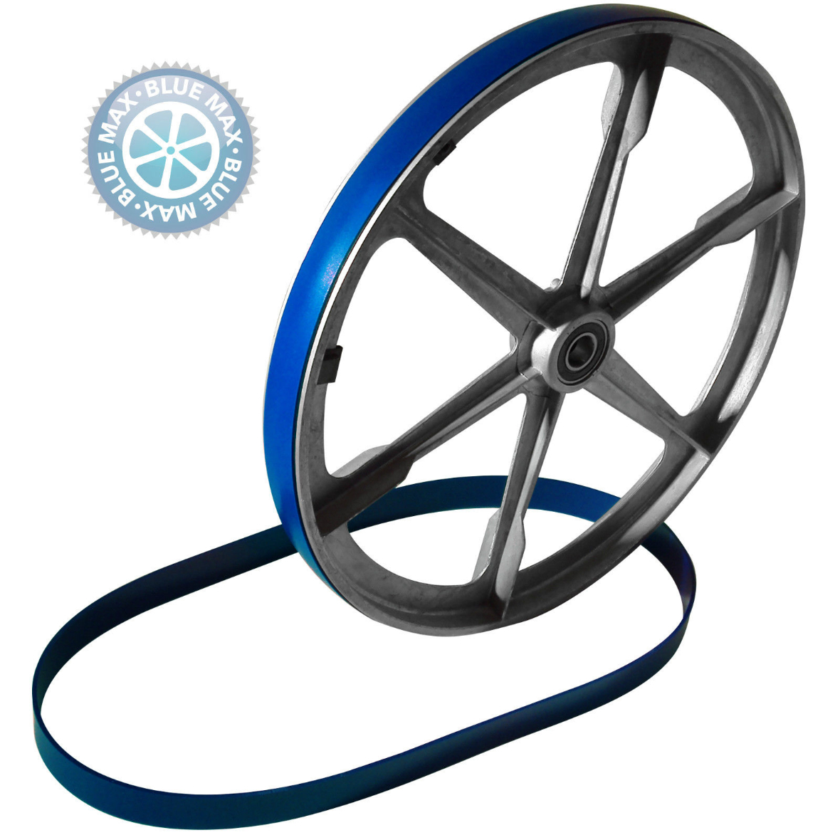

Does anyone other than Blue Max sell blue bandsaw tires?ChrisNeilan wrote:JPG, correct as usual! That is where I order my tires from based upon recomendations here. If i recall correctly, Shopsmith at that time was having as issue with their tires. Mine have only slipped once - when i forgot to dial the speed down and ran it at full throttle! My bad, and the tire wrestled back on with no damage.
Yes, in fact they do. Carter!
- BlueMax Urethane Bandsaw Tires..jpg (505.63 KiB) Viewed 7151 times
- Carter Bandsaw Tires..jpg (15.95 KiB) Viewed 7147 times
