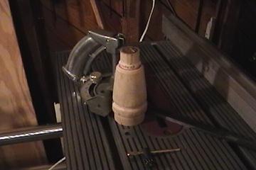

Day 4 of my Shopsmith ownership and I made this ?thing? Take a look.
[ATTACH]2092[/ATTACH]
It is 6 inches tall.
[ATTACH]2093[/ATTACH]
It is 1 1/4" diameter at the top with a raised lip.

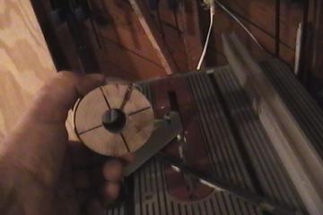

[ATTACH]2094[/ATTACH]
It is 2 1/4" diameter at the bottom. And it has a 3/4" hole through the middle.
I used the lathe for the second attempt. Thanks to this forum. I used the fence and miter gauge with two clamps to horizontally boar the hole from both ends due to its length.
More pictures to follow. Make your best guess.

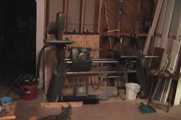

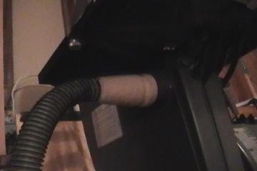

[ATTACH]2102[/ATTACH]
[ATTACH]2103[/ATTACH]
An adapter from a 1 1/4" shop vac hose to the port on the bandsaw or table saw etc.
Only 3/4" hole since that is the biggest brad point I have but I don't think it could be drilled bigger anyway. I am getting a real adapter from Shop-Vac and will taper the inside so as not to have a flat area for sawdust to get stuck in. Small stuff should'nt have a problem anyway. Don't have the space for a real vac system yet so this will work for now.

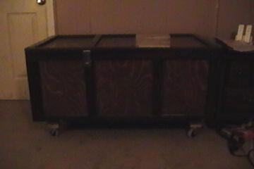

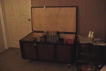

[ATTACH]2100[/ATTACH]
[ATTACH]2101[/ATTACH]
Very hard wood and tough to turn.
