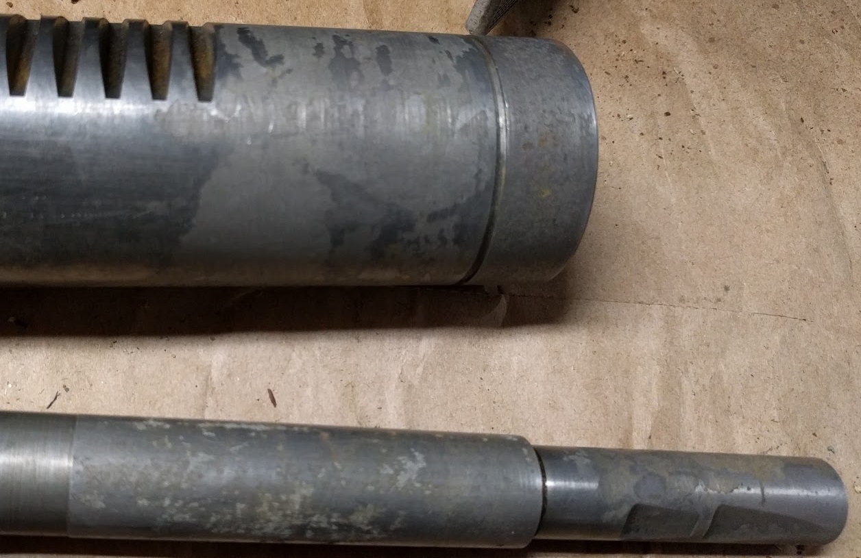

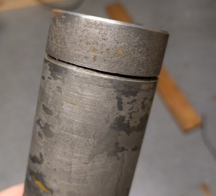

Welp, I screwed up! I soaked these guys in a 50/50 water/vinegar solution for too long and well...it looks like the finish has been eaten off (if not more than that).
Will these still be operationally useful if I clean the rust off and give them a good coat of paste wax to stop more rust?
The damage:

I dont see why not. May I asked why you soaked them in that to begin with?

Buff it smooth and wax it. It will work just fine. I accidently buffed the finish off my brand new PowerPro a few years ago. No problems...

Hey ERLover, Chris! Thanks for the quick replies!
I made the erroneous assumption that the parts were stainless steel or some other solid hunk of ferrous metal instead of having a protective plating. I figured a soak in vinegar could help get some of the pitted rust that was already there out, along with maybe getting some of the dried grease loosened up for the manual cleaning I'd have to do after.
Lesson learned...
Good to know I can buff 'em smooth and move on!

Grease cutter, then Evapo Rust would have been the way to go, live and learn. No damage done.

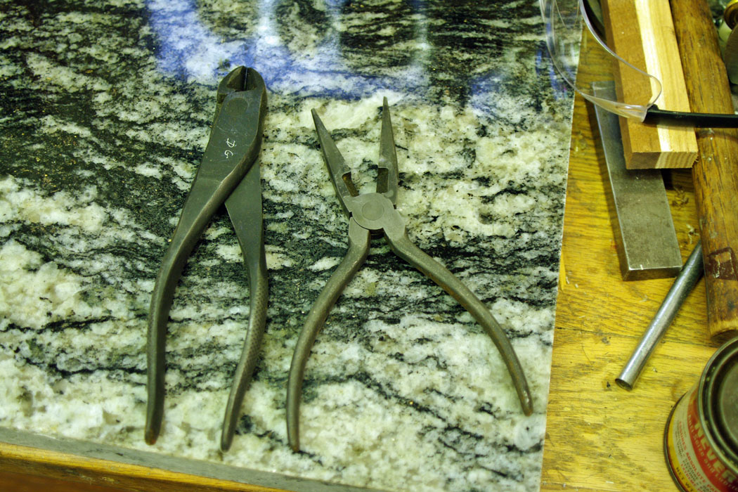

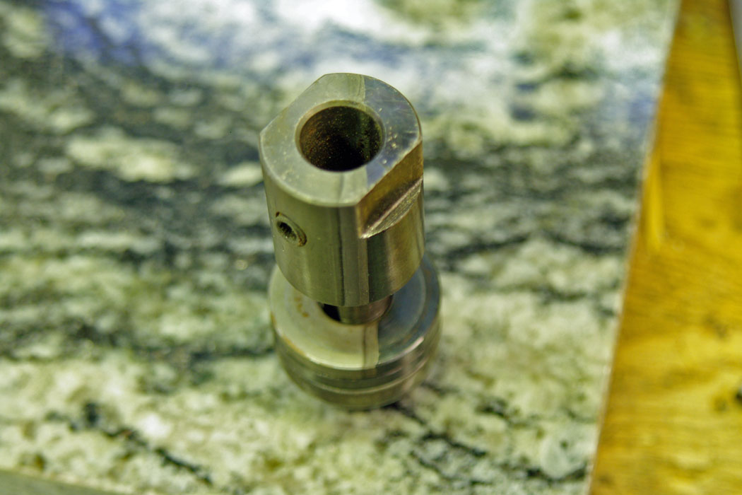

These hand tools were rusty. They were soaked over night in Evap-o-Rust. As you can see they now have a black finish. The arbor was in the same pan with the hand tools, half in and half out, as you can see the original 'black oxide' finish which by the way is a "Rust Blue" process has been removed and now has a bluish Gray finish. I need to resoak it completely so it will not be half and half.
I don't know what kind of finish the rusty hand tools had before the soaking so don't have a clue why they came out with a black finish after soaking.

Re: Ruined finish on headstock quill
OK, Even out the color.
I have noticed that if the evaporust is allowed to evaporate, a dark finish will result.
A far cry from black oxide however.
