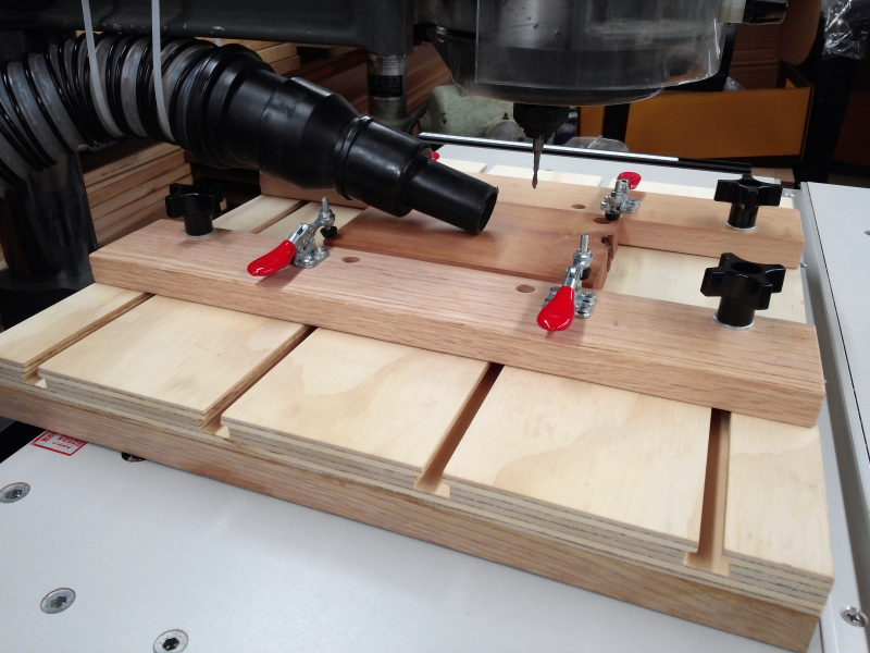

To get to the point where I could do that, I first had to design and build a guide jig, shown below.
Jig with blank.JPG (643.72 KiB) Viewed 40499 times
I cut the T-slots in the jig base with a T-slot router bit, and bought the miniature toggle clamps from Amazon. The combination works great. The "fence" boards capture the workpiece side to side, and the toggle clamps lock it down tight. I like the fence boards for most work. But if you have different workholding requirements, you can use most any type of hold-down.

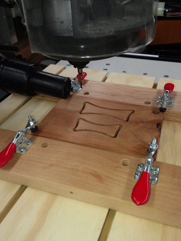

In the photo below, I'm using Rockler mini hold-down clamps to fix the workpiece on a diagonal.
Jig with Rockler clamps.JPG (701.22 KiB) Viewed 40499 times
On the underside of the base board, hidden by the bottom perimeter frame, is a large recess for mounting patterns and templates. I had designed provisions for fastening those in place with screws, but wound up just sticking them in place with double-sided tape. Which worked just fine. For those who aren't familiar with overarm routers, there's a pin sticking up from the router table, beneath the jig, and directly on axis with the overarm router bit. It rides against the perimeter of the template or pattern affixed to the underside of the jig, and the overarm router then mills a precise copy of the pattern into the workpiece atop the jig.
I also found the standard SS OPR dust port to be almost impossible to use, in practice. So I temporarily rigged the hose and adapter as shown in the photos. That worked much better, but I still had to be careful not to snag the adapter snout on the clamps and such. I have some ideas for a better design, but that's future project.
