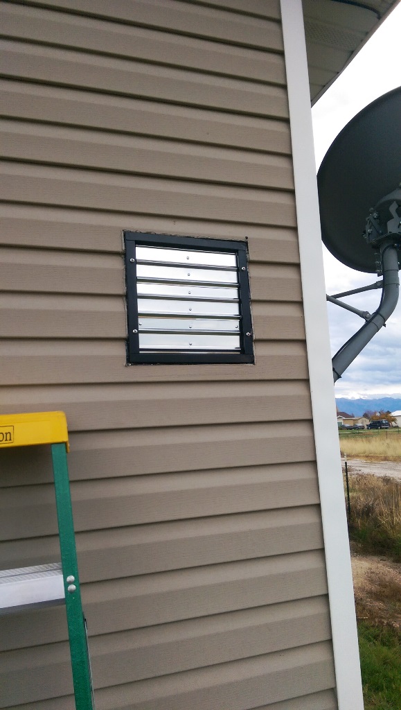

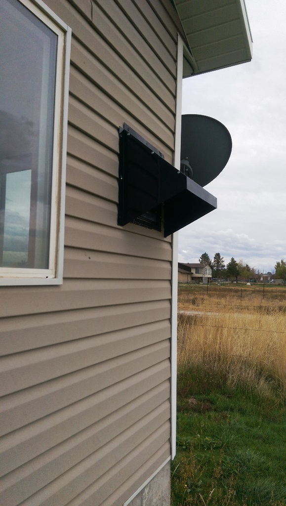

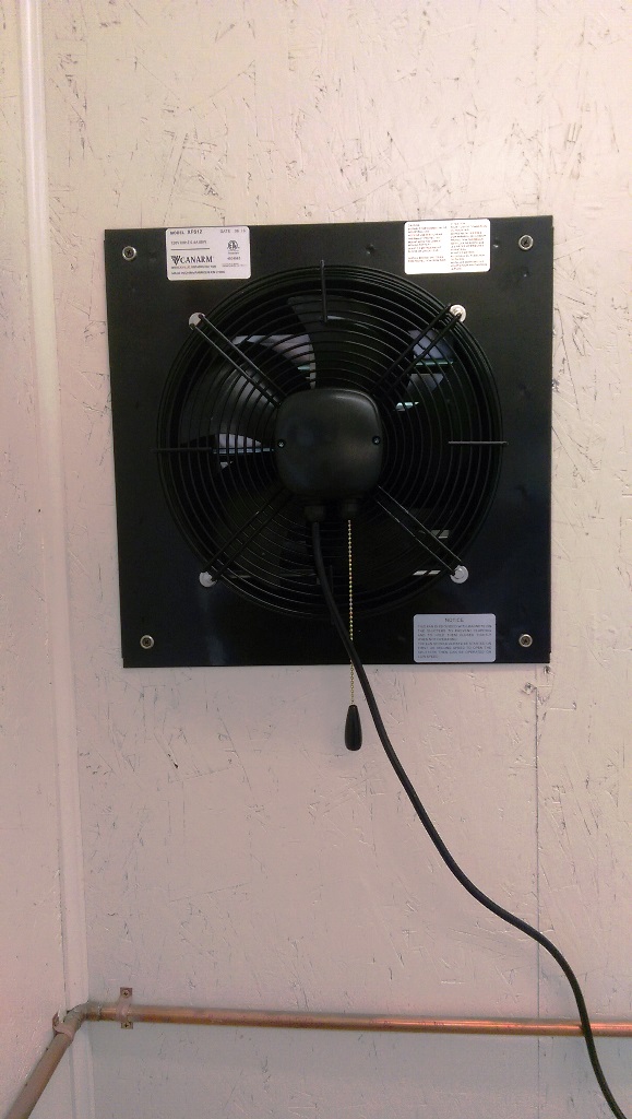

OK, here is another example. I just bought an 1100CFM exhaust fan (12
" fan) for my clean/finishing room. It is through the wall with a hood on the outside. The finishing room is 10'X12'. With the door closed the room is so tight that the fan louvers only open about half way. If I open the door to the rest of the shop (30'X40') the louvers only open a little bit more. If I open the window in the clean room then no problem. Obviously I need some make up air that I will get from the attic.
My point is that if you restrict the input you will not get the output the fan is capable of.

Very true John it can only suck as much as it can have air flow for intake.

Hope the fan is a certified explosion proof. Finishing vapor is very explosive. Also check any switch that will be used in the room.

While what you say is true about finishing vapors you need to have a very high concentration of said vapors to have a problem. This is not a production shop with finishing/spraying going on continuously 8 hours a day.Ed in Tampa wrote:jsburger wrote:But as soon as the chips get in the larger hose there is not enough CFM to move them efficiently to the container.ERLover wrote:

I have a JDS 1000CFM air filter mounted on the ceiling of the same room. It has been there for 6 years. I am sure it is not explosion proof and I am still alive.
