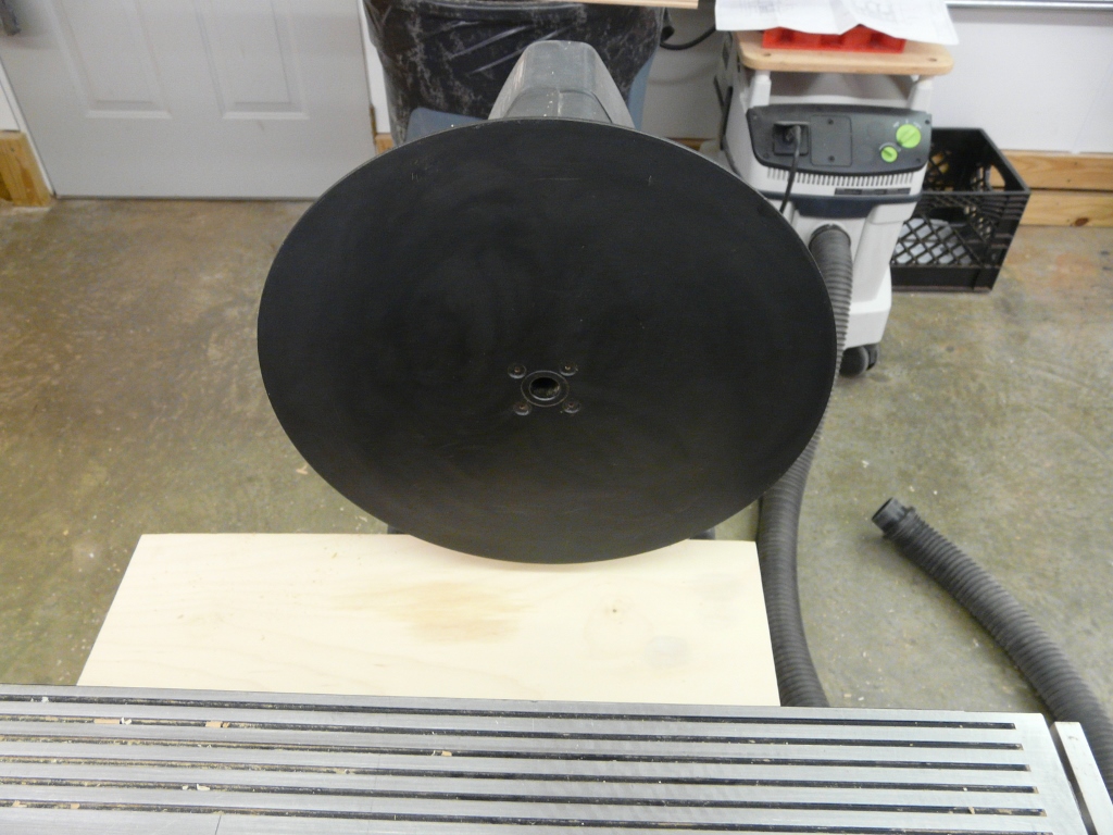

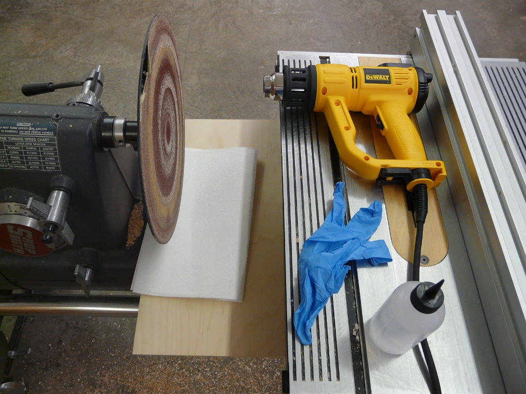

I needed to change my sanding disc today and still remember the last time I fought the beast. :rolleyes: I decided to try an old trick that is commonly used in shops to peel laminate from a substrate. Usually when you screw up! :eek:
P1100980 (1024x768).jpg (464.97 KiB) Viewed 1694 times

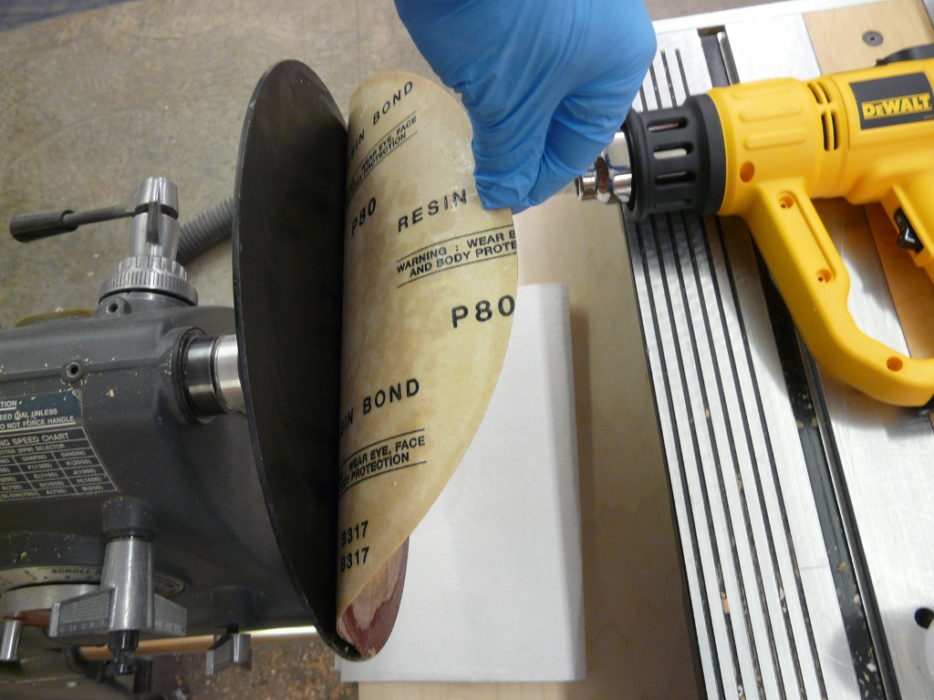

I started with my heat gun to get it started. Now to be perfectly clear I did not use the heat gun after starting with the thinner. Lacquer thinner is highly flammable and you could ignite it easily with a heat gun.
P1100981 (1024x768).jpg (395.55 KiB) Viewed 1694 times

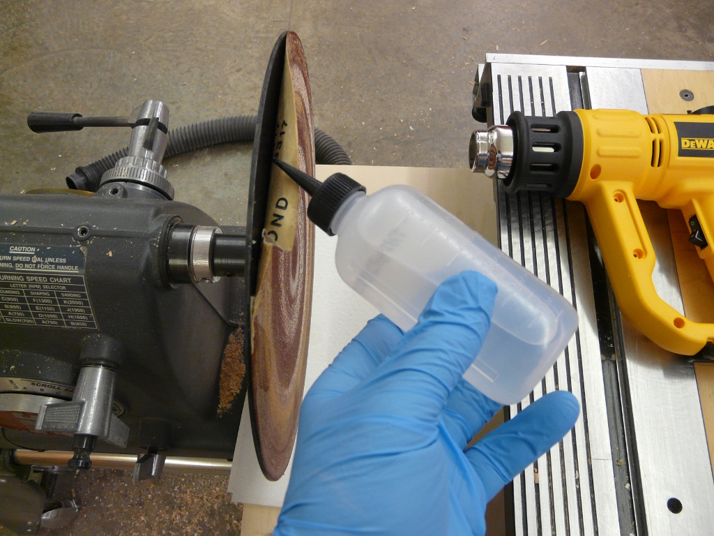

I could tell it was going to be a gooey mess.
P1100982 (1024x768).jpg (458.34 KiB) Viewed 1694 times

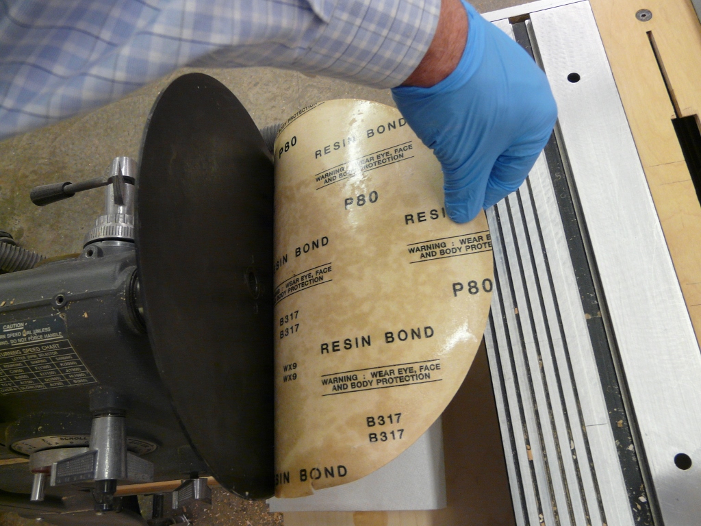

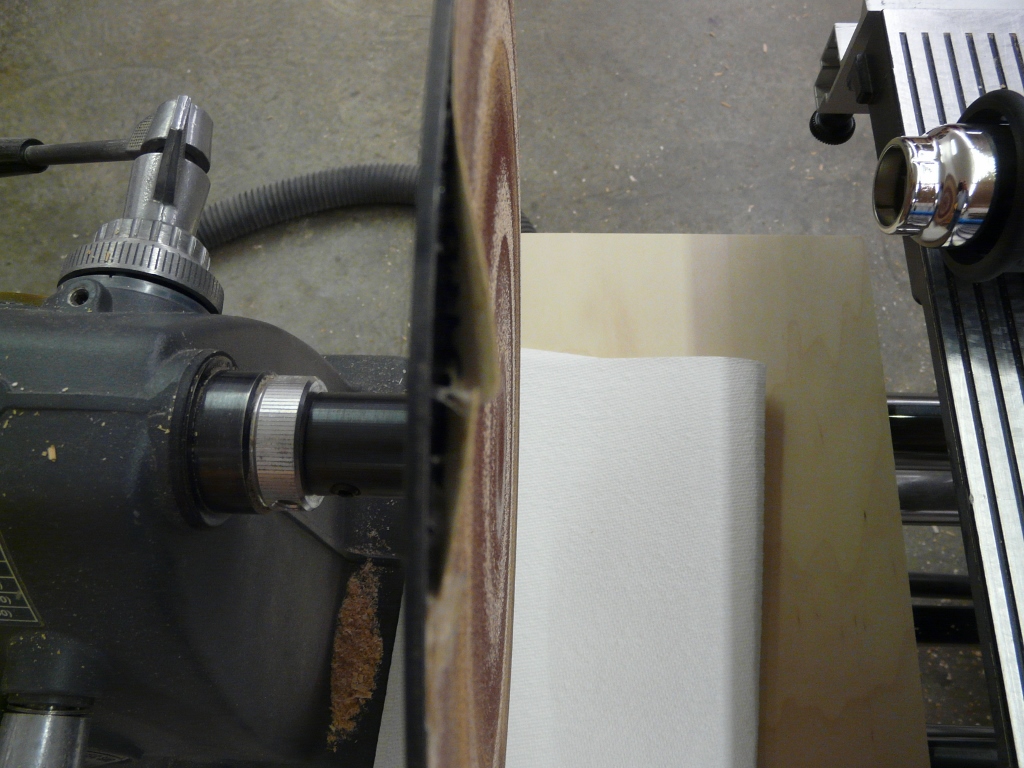

I filled a small bottle with lacquer thinner and placed a board and paper towels to protect the rails. Squeezing a little thinner while pulling at the disc goes a long way. I used less than an ounce of thinner for the entire thing.
P1100983 (1024x768).jpg (418.7 KiB) Viewed 1694 times

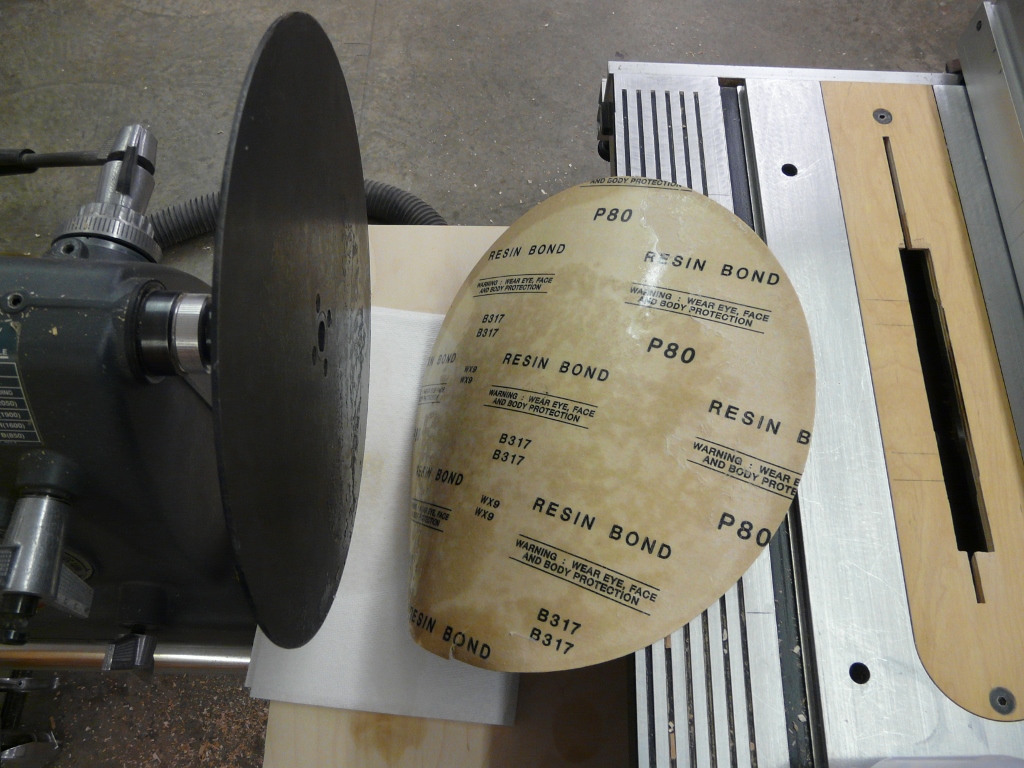

It peeled off pretty quickly with this method.
P1100984 (1024x768).jpg (429.81 KiB) Viewed 1694 times
P1100985 (1024x768).jpg (415.36 KiB) Viewed 1694 times
P1100986 (1024x768).jpg (374.04 KiB) Viewed 1694 times
With the disc removed the residue cleaned off pretty easily because it was already soften by the thinner.

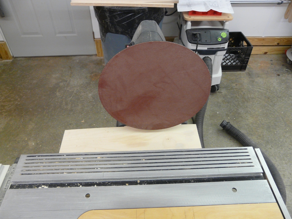

New disc in place in 2 minuets even taking the pictures. A lot easier than last time with the heat gun alone.
