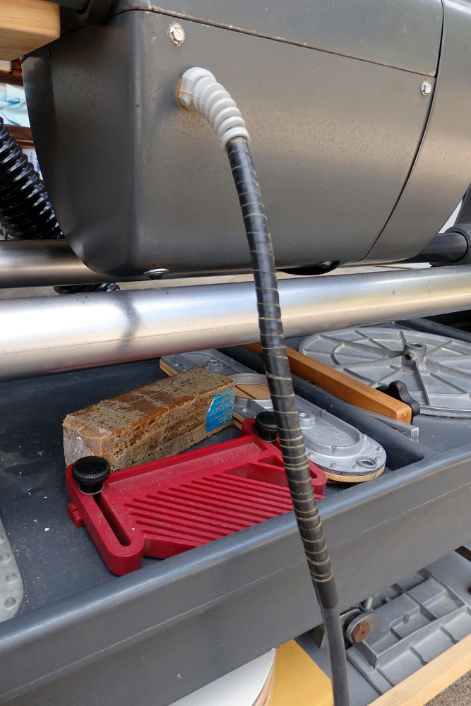

My solution was to just move where power cord exits from bottom to the backside of the motor pan.

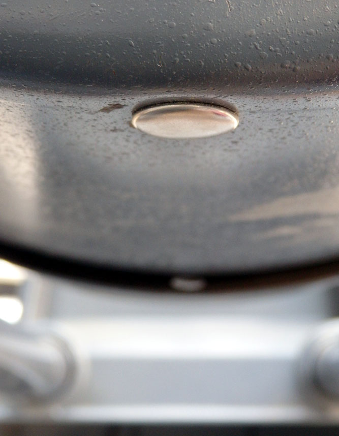

I found the strain relief fitting at Grainger. Replacement rubber boots that commonly come on portable power tools are also available online from eBay and others. For a tighter fit, and to give cord more stiffness, I wrapped the first 18" or so of cord with electrical tape. The old power cord exit hole on bottom was plugged with an electrical knock out filler.

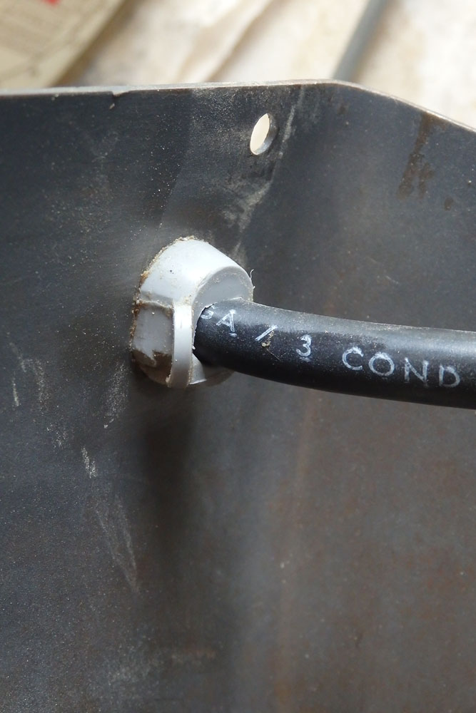

View from inside motor pan
Out the back and out of the way

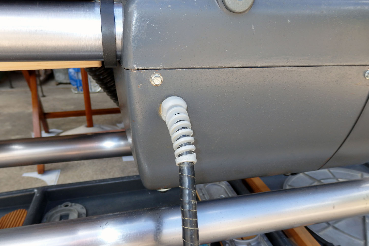

Electrical tape for added stiffness
Chrome KO plug in old hole
