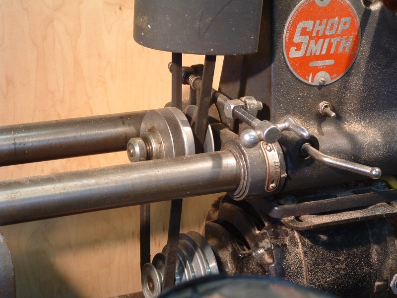

Why not just buy ER speed changer off of EBay, they run about $175 for a rebuilt one. On low setting you have a 425-1500 RPM range. I dont think the Mark V head fits the tube spacing on an ER.

Yes the 10ER and Mark 5 both have a 5/8" plain spindle (not threaded), however the way tubes on a Mk 5 are spaced wider apart than the way tubes on a 10ER, so the headstocks are not interchangeable. In addition the Mark 5 spindle height above the ways is also different so the tailstock wouldn't work either.
One option is the Speed Changer that was sold as an accessory for the 10E/ER. in addition to giving variable speed they also provide a wider range of speeds.
They come up on eBay and usually sell in the $150-200 range, it can be cheaper to watch your local Craigslist and find a 10er that comes with one.
I use one on my 10ER and It works great. Another, more expensive, option is to change to a variable speed DC motor.

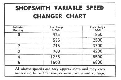

The speed changer has two ranges. Belt changes are only required for changing the RANGE. Spindle speeds available are 425 - 1600 and 1850 - 6800. The Mark 5/V headstocks only range from 700 - 5200.
I agree a used speed changer is the better choice.
A caveat is they are easily broken if used incorrectly. Make sure any that are being considered for purchase have not been broken and 'repaired'.

An error on JPGs part.
The speed changer has two ranges. Belt changes are only required for changing the RANGE. Spindle speeds available are 250 - 1600 and 1850 - 6800.
- Speed chart.JPG (27.26 KiB) Viewed 7970 times

Happy to have made thy day!!!!ERLover wrote:An error on JPGs part.

JPG wrote:Happy to have made thy day!!!!ERLover wrote:An error on JPGs part.
The speed changer has two ranges. Belt changes are only required for changing the RANGE. Spindle speeds available are 250 - 1600 and 1850 - 6800.!!!!!
Not a problem, you would have done the same for me.
Huh?

What am I missing John?jsburger wrote:ERLover wrote:An error on JPGs part.
Huh?![]()
I think you better look again at the chart you posted.

The chart says 425 low speed , you posted 250, Not every one has the larger pulley for the drive sleeve.ERLover wrote:What am I missing John?jsburger wrote:ERLover wrote:An error on JPGs part.
Huh?![]()
