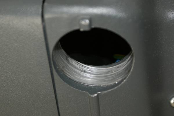

I bought my Power Pro headstock assembled from the factory and yes it is more difficult to move along the way tubes. I commented here that the finish on the inside of the way tube holes on the headstock were much more rough than the the same holes on the original headstock. Just an apparent lack of the same level of fit and finish as on the original. Also the PP headstock is reported to be 21 lbs heavier than the original, however it will slide. Since I have installed the upgraded casters the machine has to be down on the floor in order for me to move the headstock because the unit moves very easily now.
Over the past few years it seems to be more easily moved. Maybe the casting mating surfaces are be getting smoothed out.

Just a quick comment and pic. The photo shows the inside of the way tube bores on my new (at the time) Power Pro headstock
PP Headsstock bore 2.jpg (64.96 KiB) Viewed 9013 times
PP headstock bores.jpg (70.6 KiB) Viewed 9013 times
Could be contributing to the problem.
