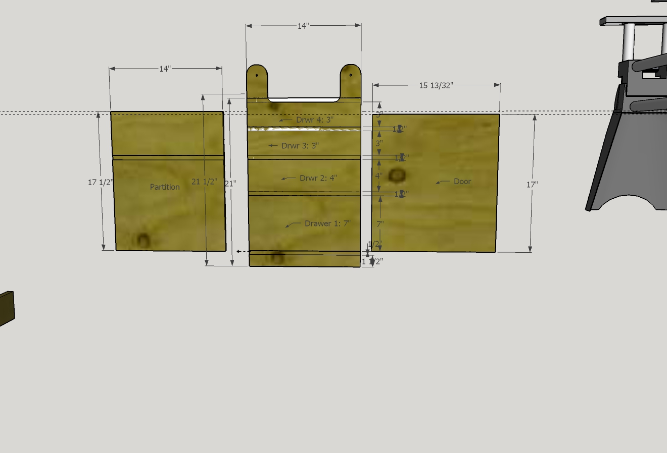

I'm hoping you experienced folks can help me. I'm trying to build an under-shopsmith cabinet for my 510 and I'm having an issue I don't understand. I followed seejay's plans here: http://www.shopsmith.com/ss_forum/viewt ... 448#p21448
but things aren't looking right. I'm about to start cutting my dados for the drawers but I am having a problem when I try to include a 7", 4", 3" and 3" drawer. The dimensions look off from the ORIGINAL cabinet and I didn't see any mention of changes in the revised section.
At first I thought I needed to move the top of the cabinet up and that did seem to let me fit all the drawers but now the partition and doors look too small.
Can you please help me see what I'm missing?

I'd be inclined to agree with you but earlier in that same thread there are pictures with 4 drawers!
In addition, in those pictures he didn't seem to have the top as close to the shopsmith as I do in my picture. (My shopsmith 510 lower tube height is the 21 1/2" in my picture)

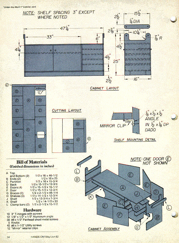

Perhaps I'm confused but when I look at the drawing in the link shown I see more like a 4" drawer, and three 3" drawers. So what am I missing here?
Re: Problem with Revised Under-Shopsmith Cabinet
Are you looking at the drawing for the original? That's included there for reference but the revised measurements are further on in the word doc and mention a 7", 4" and 2 3" drawers.

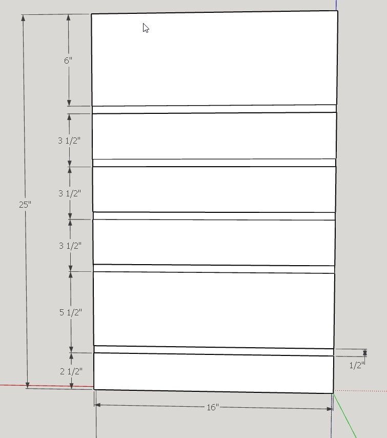

Fired up sketchup and this was an example of what could be. Assuming the 2-1/2" number for the bottom and the 6" number for the top you can end up with this:
Of course the drawer sizes can be changed to fit your needs.
This is also assuming using dividers and one could go to other methods to hang the drawers(slides) and gain a bit more room.
You are adding the 1/2" dadoes between the dimensions for the drawer fronts. ie. 7+1/2+4+1/2...EYoung wrote:I'm hoping you experienced folks can help me. I'm trying to build an under-shopsmith cabinet for my 510 and I'm having an issue I don't understand. I followed seejay's plans here: http://www.shopsmith.com/ss_forum/viewt ... 448#p21448
The dado is to recess the aluminum angle which acts as a runner under the drawer.
The drawer fronts go one on top of the other with minimal clearance between them. 7+4+3+3=17
See the shelf mounting detail in the center on the right side.
