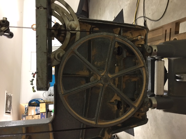

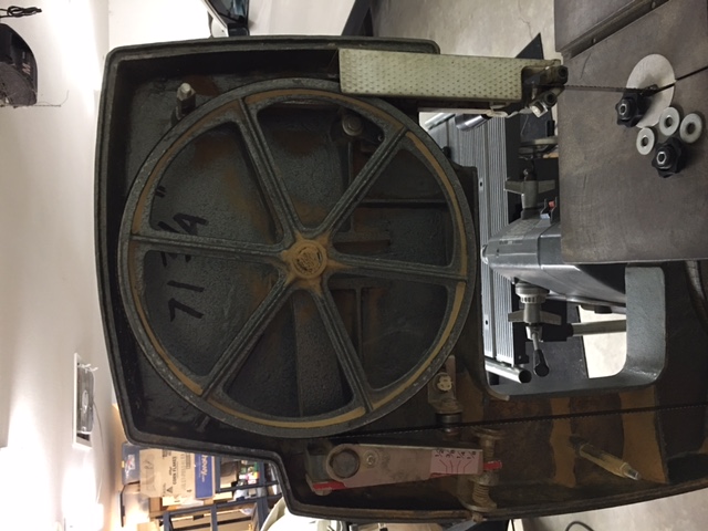

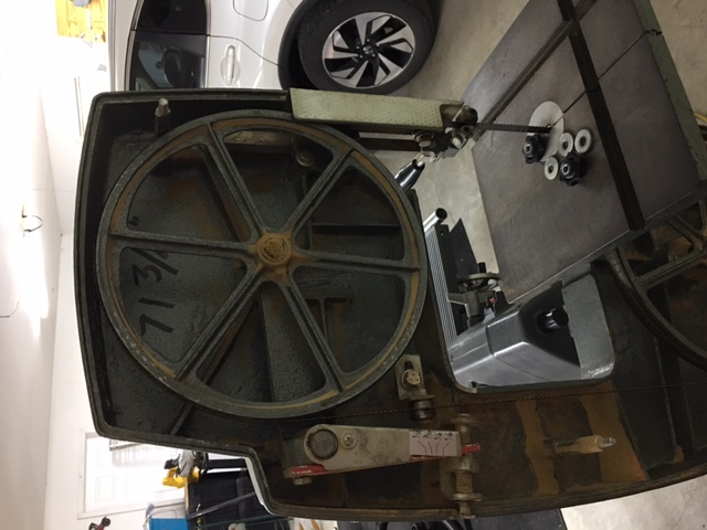

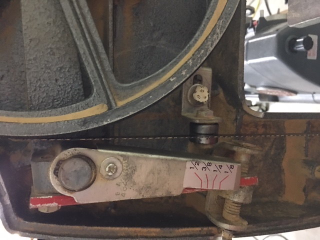

More Pictures.
Thanks for the replies!
- IMG_3725.JPG (101.57 KiB) Viewed 5705 times
- IMG_3726.JPG (96.54 KiB) Viewed 5705 times
- IMG_3727.JPG (104.71 KiB) Viewed 5705 times
- IMG_3728.JPG (103.77 KiB) Viewed 5705 times

Re: Shopsmith Bandsaw
Some difference in construction from my two bandsaws: The ribbing on the casting is different. Mine has much more ribbing making for a stiffer casting. The insert for the blade slot is different,mine is a plate underneath, yours is a wedge inserted into the front of the table. The trunions loof larger, although they may not be. The scale for tension is different. Lastly yours is cleaner than mine!
I am guessing you might have a clone. Since it is "copied" from Shopsmith, it probably works the same, maybe as well. Others will know better than me.
Chris Neilan
- Posts: 35598
Interesting 'details'.
Definitely a clone.
Beefier castings(wheels fer sure).
Parts MAY be interchangeable, but they may have subtle differences.
The trunion etc. is more similar to the early SS version.
At this point I would just use it until a problem actually rears it's head.
Definitely a clone.
