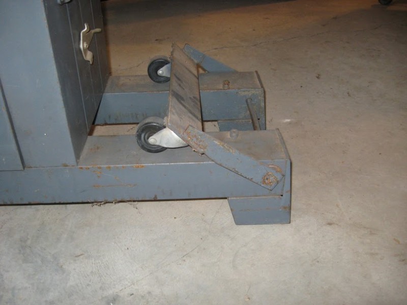

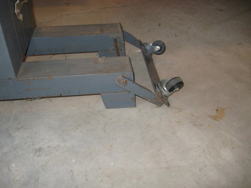

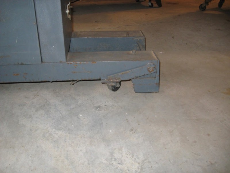

It took me a while to find these pictures of the "odd" casters I mentioned. They are surely home-made but show production quality.
The first picture shows why I call the lower frame supports "sphinx front feet". :)
You have to lift the end to swing the feet under or out on top.
[ATTACH]19194[/ATTACH]
[ATTACH]19195[/ATTACH]
[ATTACH]19196[/ATTACH]
