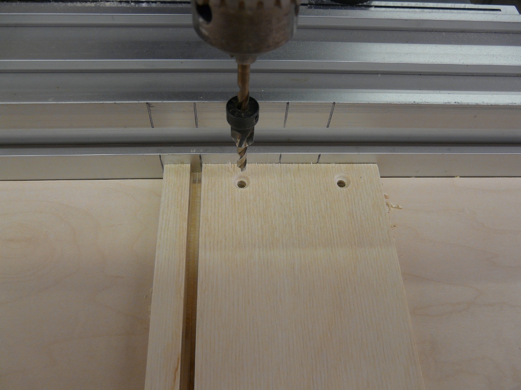

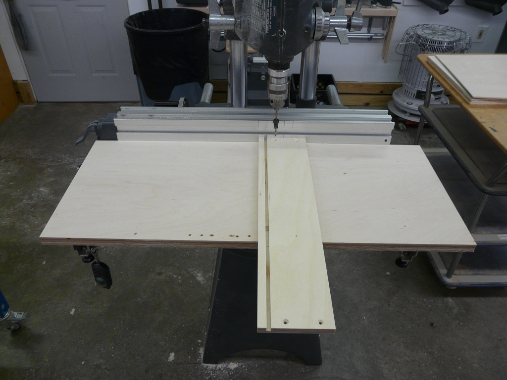

One of the things that I use my 520 for is a lot of drawer building. It is the perfect machine to groove for the drawer bottoms and also drill holes to attach the drawer fronts.

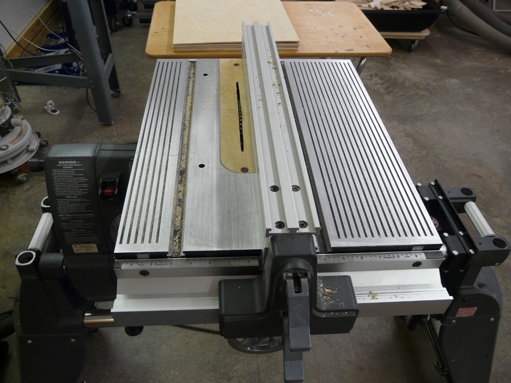

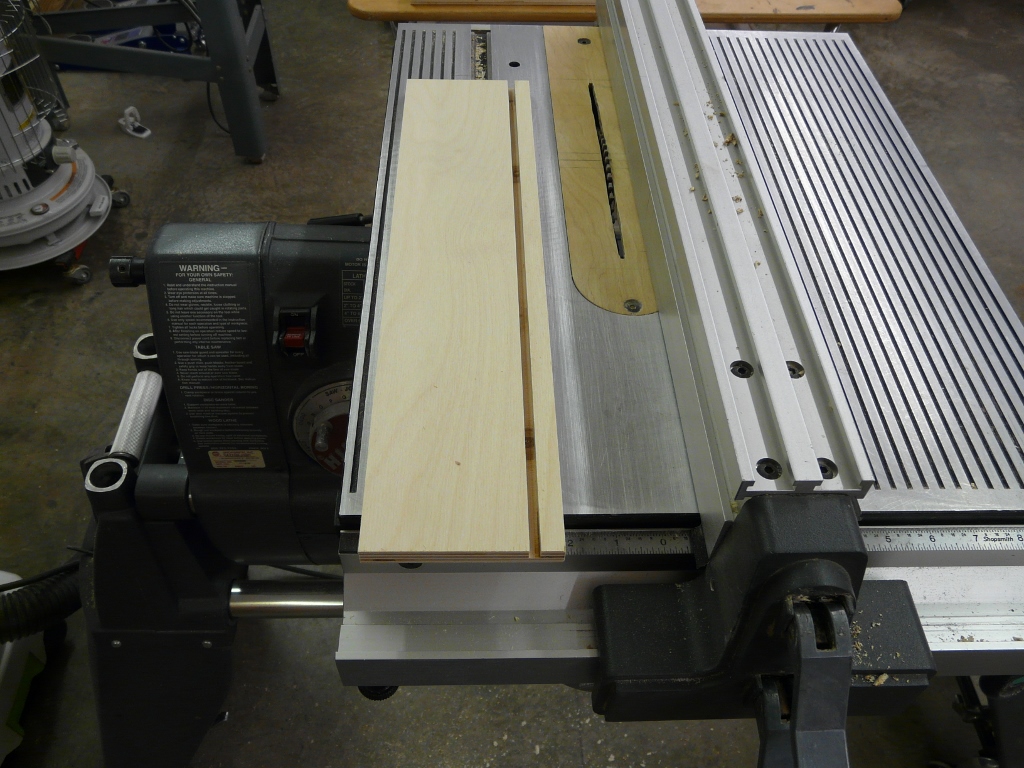

I use the 2 pass method with a standard blade to make a groove to fit the 5MM plywood used for the bottoms.

What is your ZCI made of and by whom?
mbcabinetmaker
Posts: 1627
Location: Greer SC
Re: Building drawers today
Post by mbcabinetmaker »
Ed in Tampa wrote:What is your ZCI made of and by whom?
Made of Baltic birch plywood sanded to correct thickness by yours truly.

I have a question, Why is your countersink hole on the inside of the drawer box? Is that to attach the drawer fonts?
mbcabinetmaker
Posts: 1627
Location: Greer SC
joe_cool wrote:I have a question, Why is your countersink hole on the inside of the drawer box? Is that to attach the drawer fonts?
Yes it is.
