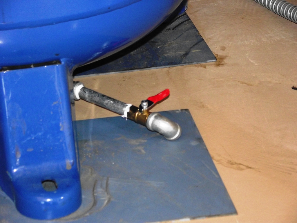

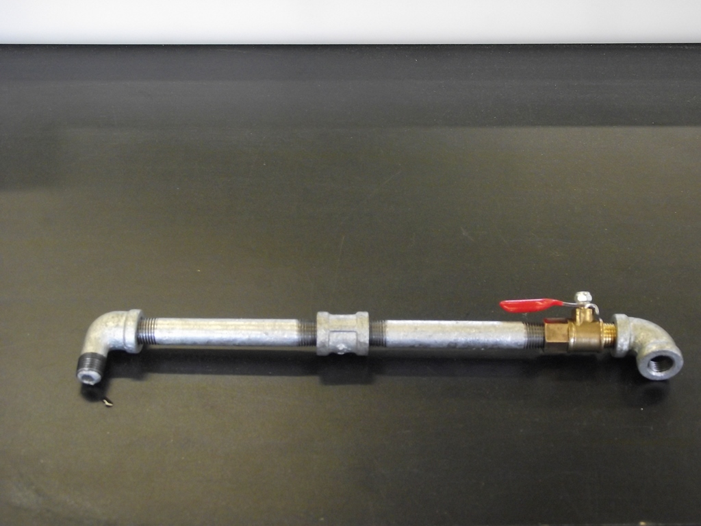

Absolutely! I turn it off and drain it every time I leave the shop. I got tired of reaching under it to turn the petcock so I removed it and replaced it with a valve that is easily accessible.JPG wrote:After each use is good procedure!ERLover wrote:B4 his Highness chimes in, must be taking $ from the natives, and not to insult anyones smarts here, I hope you drain it on a regular bases.
37 Gal Air Compressor
Re: 37 Gal Air Compressor
- DSCF0696.JPG (278.19 KiB) Viewed 10326 times
- DSCF0697.JPG (354.19 KiB) Viewed 10326 times
Yes, you have to bend down to close it but I open it with my foot.reible wrote:Here is my tip of the day, circa 17 March 2009:
http://shopsmith.com/ss_forum/viewtopic ... ain#p33214
I do like the lever valve, might have to make that change. I just move the one from the bottom of my tank to the end of the pipe but I can see the advantage of the lever.
You need more teflon tape on those joints!!!!!
Nah, that was enough. It doesn't leak.JPG wrote:You need more teflon tape on those joints!!!!!
