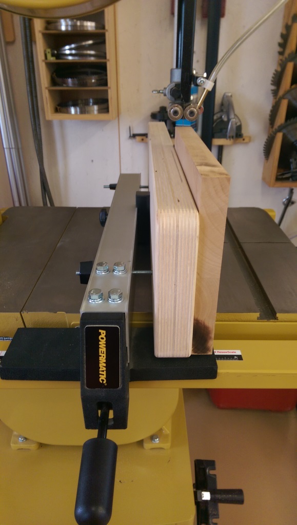

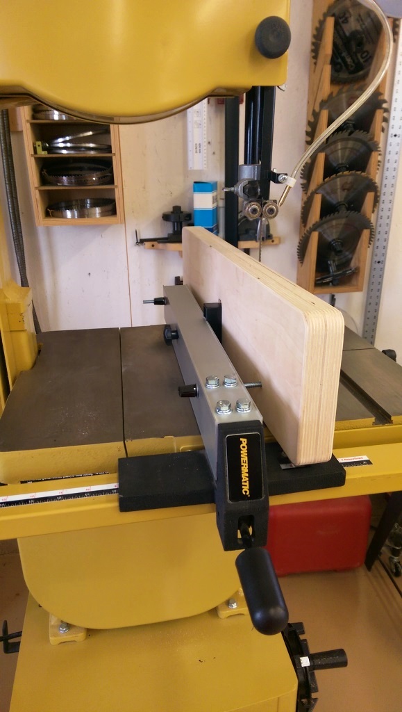

I totally agree Paul. That has been my experience also. The wood does not matter it is the blade. I have used a Timberwolf 5/8" blade on my SS band saw for resawing with no need to change the fence for drift between wood species.
I now have a Powermatic 14" band saw with a 6" riser block. It has a 3/4" Timberwolf blade for resawing. The fence came with a plastic single point to do resawing. I built a full up aux fence for resawing and used the powermatic plastic single point thingy as the pivot point for the fence.
The first picture shows the black plastic thing in the middle of the fence. The second picture shows the angle the fence is adjusted to for the Timberwolf 3/4" blade. It works for all wood I have cut.
