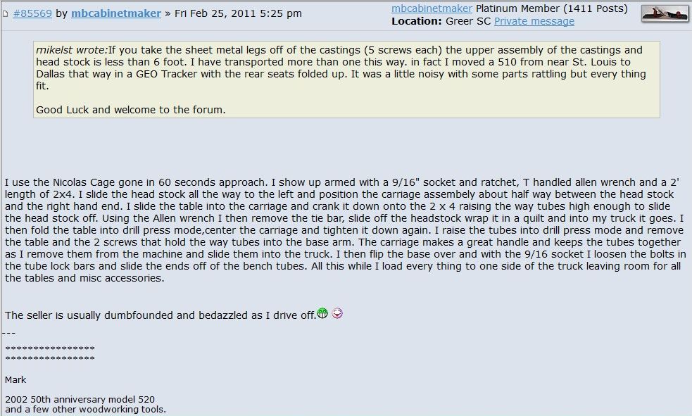

I'm going to pick up a fairly new (2004) Mark V 510. Its been awhile since I transported one in my truck. I have to travel about 300 miles so, I'm looking for good instructions for safely transporting it. There used to be a video available that showed how to unpack and setup a Mark V but I can't find it. Seems there is something about rolling the machine over on its back.
Re: Transporting Mark V
dafixer wrote:I'm going to pick up a fairly new (2004) Mark V 510. Its been awhile since I transported one in my truck. I have to travel about 300 miles so, I'm looking for good instructions for safely transporting it. There used to be a video available that showed how to unpack and setup a Mark V but I can't find it. Seems there is something about rolling the machine over on its back.
gone in 60 nick cage.jpg (122.75 KiB) Viewed 4531 times

Be careful if you have to roll the unit over a rough uneven driveway, etc. They can break at the cast tie bar...learned that the hard way! Good luck on the move and enjoy your new SS!
recurvearcher wrote:Be careful if you have to roll the unit over a rough uneven driveway, etc. They can break at the cast tie bar...learned that the hard way! Good luck on the move and enjoy your new SS!
To say nothing re breaking the plastic wheels.
