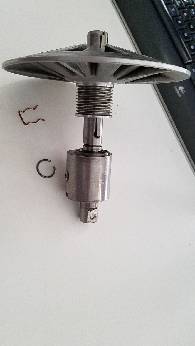

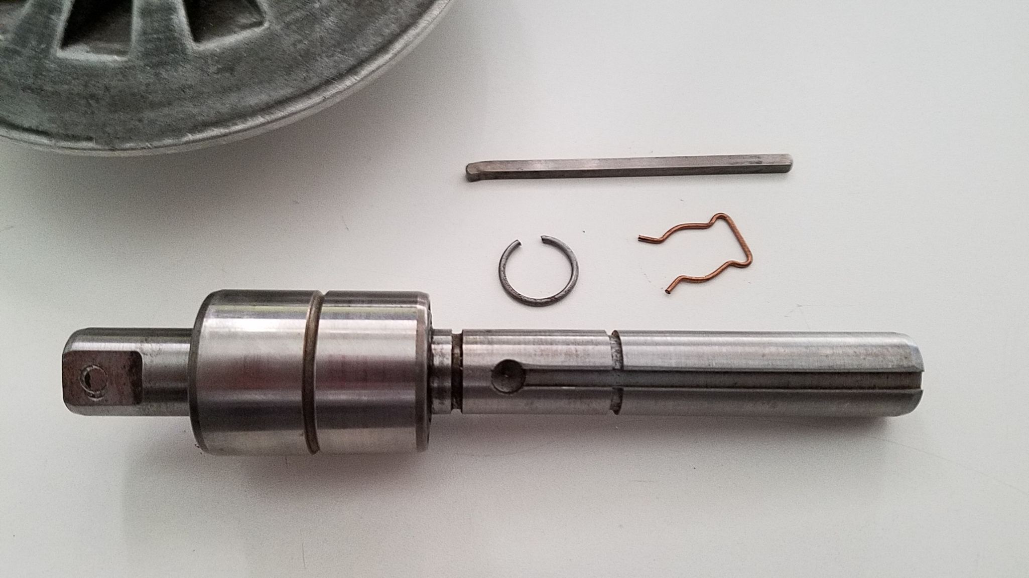

Just making sure. I believe you have said that you have all of these parts:
Idler Shaft Parts 001.jpg (526.87 KiB) Viewed 6281 times
Idler Shaft Parts 002.jpg (1.37 MiB) Viewed 6281 times
