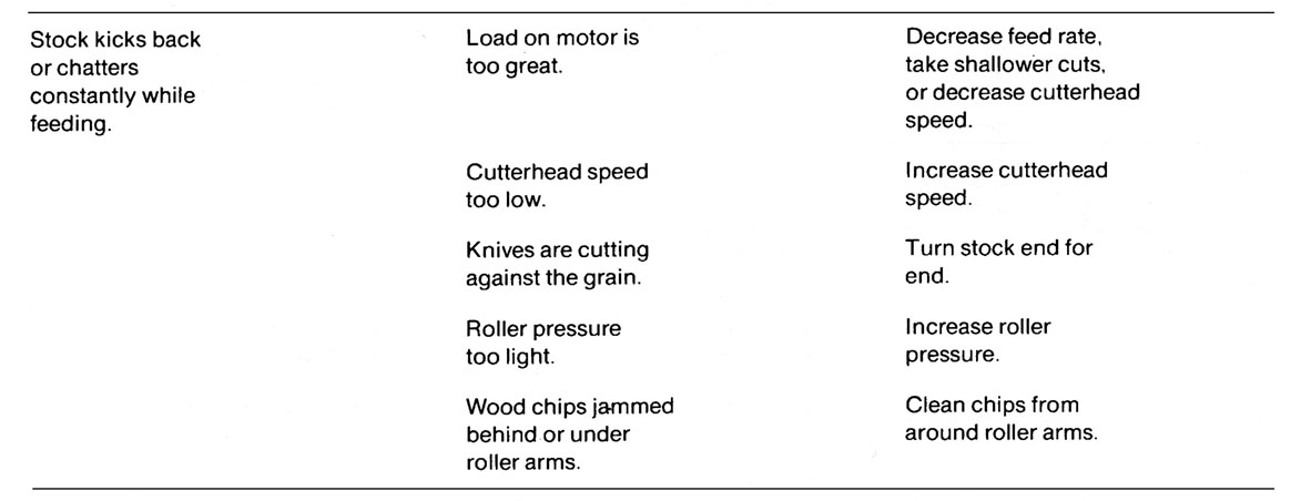

Your post caught my attention, as do all posts that involve equipment I own and problems I have not yet experienced, as I hope to learn from others' solutions. Looking at my Shopsmith Planer Owner's Manual (which is not for a Pro model), the trouble shooting guide if experiencing "chatter" gives these suggestions. If you don't have a manual, I highly recommend getting one, available from Shopsmith for a reasonable fee, considering the number of pages.wilsjay wrote:I have a standalone pro planer which has worked fantastic for years. I am getting chatter marks on the wood. I have tried cleaning everything, replacing the knives, etc. What is causing this and how do I fix it? Thanks!
- ssplaner064-chatter.jpg (64.44 KiB) Viewed 4916 times
