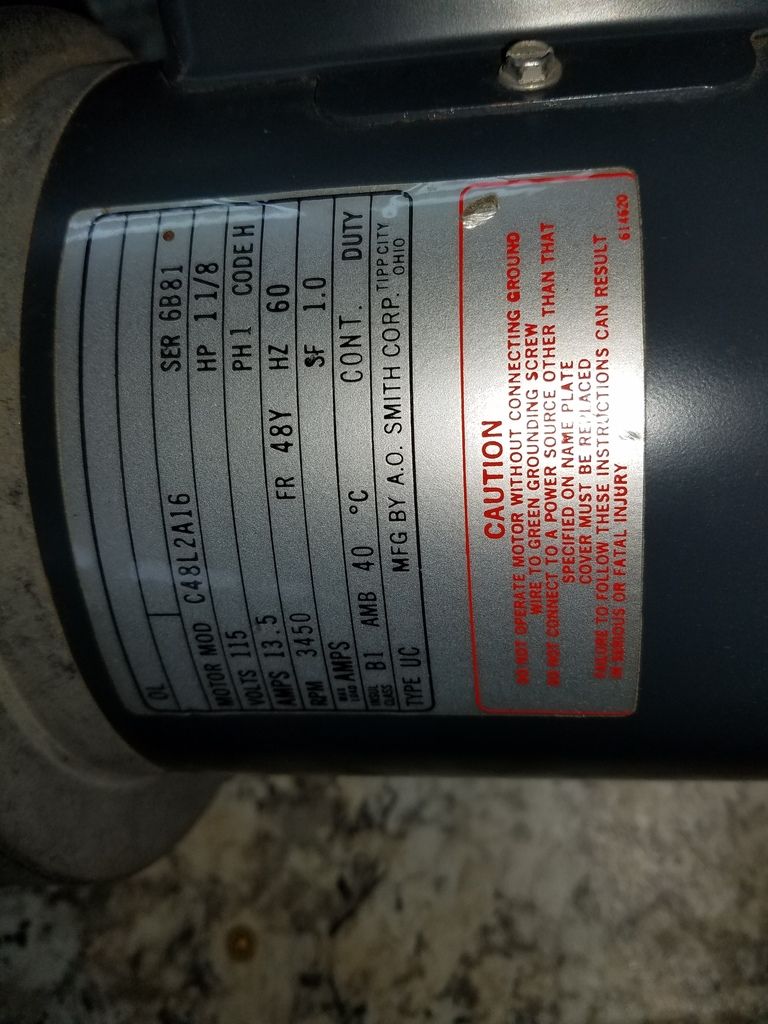

well, I think I may have found the limit of my SS. tried cut some 1"x1/4" strips for trim of some shelves. well, don't know how cold it was in the garage (-3F outside - much warmer inside...probably 30F???), but it would spool up to maybe 500rpm, then pop the breaker. found out it's only a 20AMP - don't know if that matters. I haven't had any problems the other days I was cutting the same strips, but it was much warmer those days. Heck, I didn't even get to cut any wood tonight since it wouldn't stay running nor spool up to tablesaw speeds. if it's the cold causing the problems, then I guess I'll just wait for warmer days. if not, gonna hate ripping it apart. just got it together and running a few weeks ago.

Which motor?
What speed setting?
P.S. The start switch actuator may be sticking(switch not opening).

I think it has the 1 1/8 HP motor. Image
and I had it set on the "R"
It is not a dedicated circuit, but nothing else was turned on. last week when I was cutting, I had the shopvac and SS turned on at the same time with no problems.

Still suspicious of the start switch failing to open.
Does it act the same if set to slow rather than "R"?

I thought we weren't supposed to change speed when off? I can't change speed before it pops the breaker...
