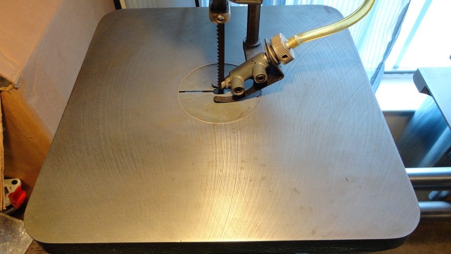

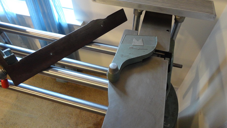

The jigsaw table and Jointer Tables cleaned up nicely, they were as rusty as the jointer fence which I have yet to do.
I hesitate to call this a restoration, it's more a reconditioning because I am only attending to the mechanicals in order to press it into service as soon as possible.

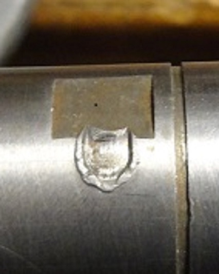

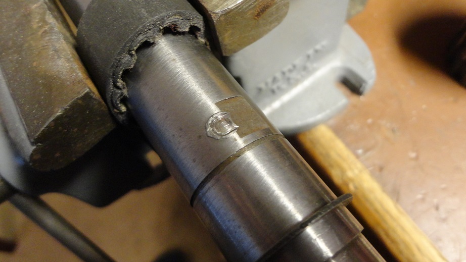

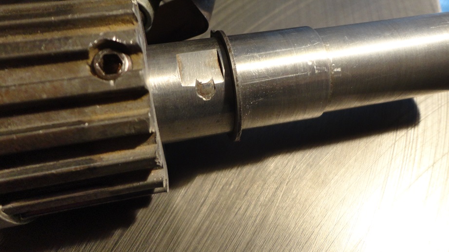

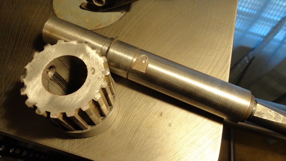

Today I focused on removing the non clutch Gilmer drive which was stuck on the drive sleeve.
It looks like the previous owner crashed the machine causing the drive to turn a little and dig the set screw into the shaft. In hindsight I should have pressed it off in the other direction to minimize the scraping which the burr on the shaft caused.
DSC02634.JPG[/ After cleaning up the shaft with a swiss 00 file and the inside of the Gilmer drive with 220 shop cloth to achieve a slip fit with the hand I think it will be serviceable. [attachment=1]DSC02634.JPG

BTW I do not think the pulley was originally set screwed on the flat, but on the edge of the flat.
I had considered that seeing as how there are no other set screw marks in the flat. It did however slip a bit owing to the shape of the set screw mark, possibly because it did have a good purchase on the flat.

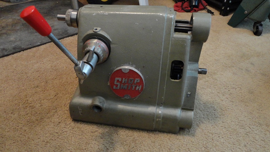

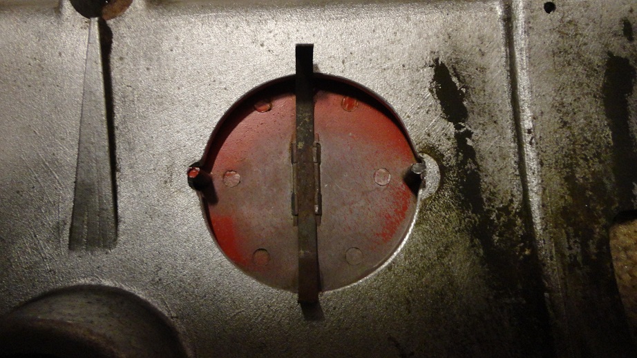

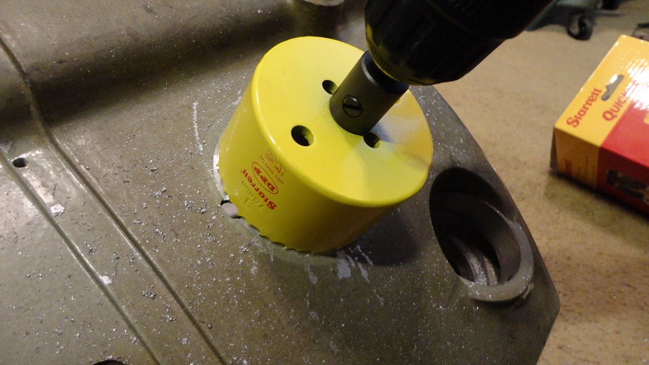

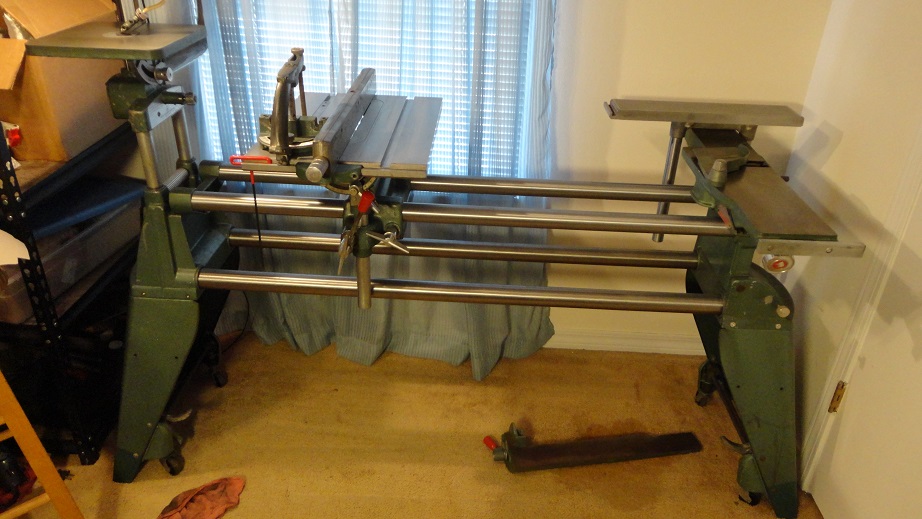

Latest update, turning to the headstock I installed 8 32 Helicoils into the motor pan and belt cover mounting holes as well as cutting a 3 inch access hole behind the logo cover, I had to bend the spring a little to get it to fit properly. Now i can service it easier and have stainless mounting screws to match all the stainless fasteners i used mounting the legs and table insert.
Clean up with mineral spirits followed by Dawn dish washing detergent and a mock build while waiting for the bearings and belts.
