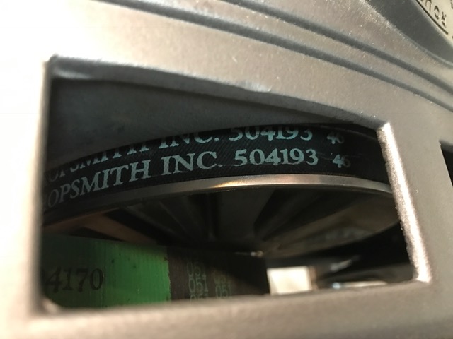

I snapped a quick picture but didnt measure. The belt is a 504193. It's an older belt but looked to be in good shape so I reused it. I believe the current number is different.

Correct belt. Appears 'normal' width.UncleSnick wrote:I snapped a quick picture but didnt measure. The belt is a 504193. It's an older belt but looked to be in good shape so I reused it. I believe the current number is different.
So that path is non-fruitful.
Since the belt positioning on the pulleys is 'normal' I am suspect of the tach. The motor is highly unlikely to be running fast especially 25% so.

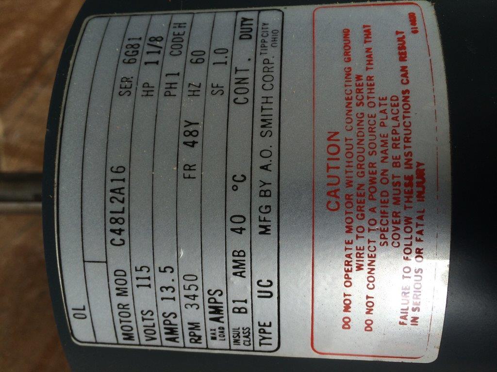

I thought I'd verify the tach against a known entity. So I tach'ed the motor shaft and got 3580 PRM which I thought was fairly close to a 3600 RPM motor. But when i looked at the nameplate, it said the output should be 3450 RPM! So I was getting a reading 104% of nameplate. So the tach might be off but doesn't fully account for the 24% increase in speed I am seeing at the Quill.....

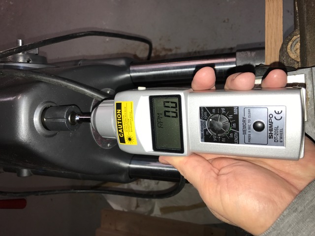

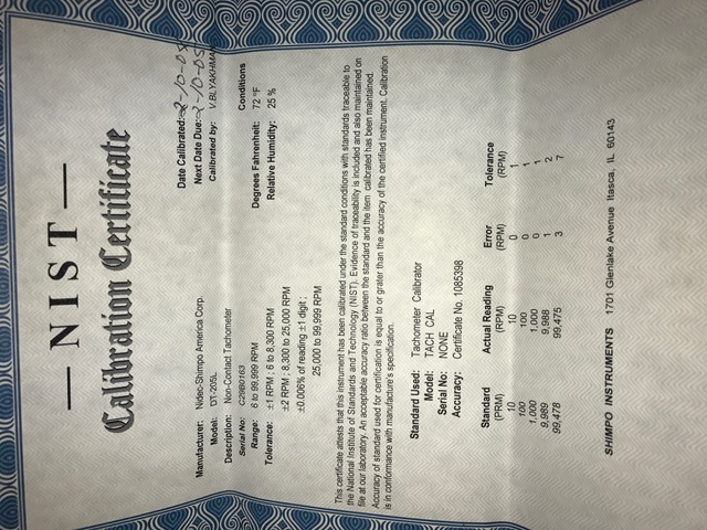

I'm using a Shimpo Tach. I took a picture of how I checked the quill shaft speed. I did the same on the motor shat before I reassembled it. I also shot a picture of the certification. Seems it's almost 12 years overdue for a re-calibration.

Re: Speed adjustment, can't get to low end?? ..
What is the laser detecting/responding to?
Reflective strip, flag, ...?

Look closer JPG. Do you see the shaft touching he coupler? Think mechanical, not digital.

The speed rating listed on an induction motor is the "full-load" speed ... in this case about 96% of the 3600 RPM "synchronous speed". The motor speed decreases with load, fairly linearly, and 4% "slip" is typical at rated continuous output power. If you measure the speed at no load, however, it should be pretty close to the synchronous speed. So there's no reason to suspect gross inaccuracy of your tach.UncleSnick wrote:Thanks for the tip JPG. Now the plot thickens ...
