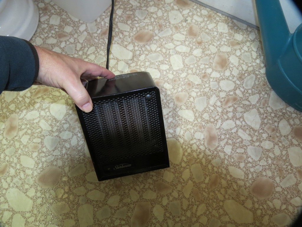

We use two ceramic heaters in our house, one in the upstairs bathroom and one in the downstairs bathroom. The ones we have are a much older design but still the same function. They are not used except for when taking a bath/shower.
They do have fans but they also are heat limited by airflow designs so if the air flow is blocked the heat output drops off, the thermal control works very well. Before we started using them I performed a test by blanketing one with newspaper to see what would happen. They did not catch fire. The worry was what if say your towel dropped off the rack while in the shower and happened to land on the heater......
They are however noisy, and can take up to 1500W. I'm looking for something without a fan and about a third of the power. The ones in the link claim case temperatures of no more then 90 degrees, not even warm to the touch.
As so far as insulation, there are 6" bats covered with a 12" off loose fill above. Two exposed walls with full insulation. One smaller window that is thermal glass and heavy thermal curtains. It is small room and it sets over the garage with 6" of insulation between. I don't see me changing any of those factors.
