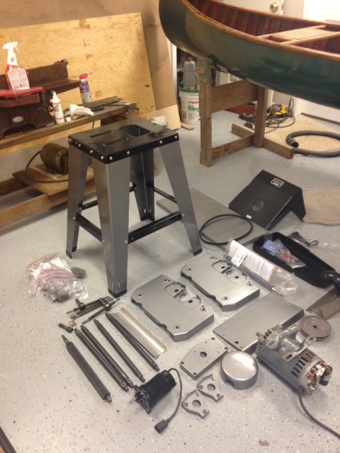

Tabletop update. I decided to use a heat gun to remove the stainless top and was quite surprised that the cast machined tabletop was in very good condition. NASTY glue was a PITA to remove. After many hours of wet sanding, I now have a a very usable tabletop. No need for a stainless steel cap. Both motors are curing with a new brushed on coat of black gloss rustoleum. Reassembly next weekend.
Total cost. $160 CL planer/stand purchase price combined with $200 parts from SS. Plus acetone, mineral spirits, evapo-rust, cider vinegar, Rustoleum paint, gun blue, and a variety pack of metal sanding paper. Total cost $400. It still needs to be determined if new blades are in order.

alphatopher
Silver Member
Posts: 10
Joined: Mon Dec 19, 2016 4:33 pm
Re: Planer tabletop stainless steel gouges
Post by alphatopher »
Ready for reconstruction.

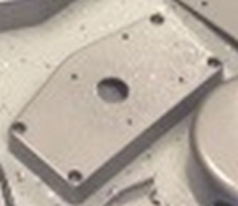

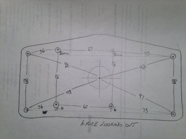

While it is 'separated', could you measure the center locations of the 5 holes in the middle relative to the 4 outer mounting screw holes(Please!!!!!). :)
feed motor mount gear cover.jpg (30.5 KiB) Viewed 5055 times
alphatopher
Silver Member
Posts: 10
I've taken some measurements and will post a photo tomorrow when i can size the image the image within guidelines for posting
alphatopher wrote:I've taken some measurements and will post a photo tomorrow when i can size the image the image within guidelines for posting
TIA
alphatopher
Silver Member
Posts: 10
Measurements are in MM. Inside looking out.
