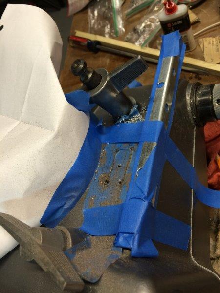

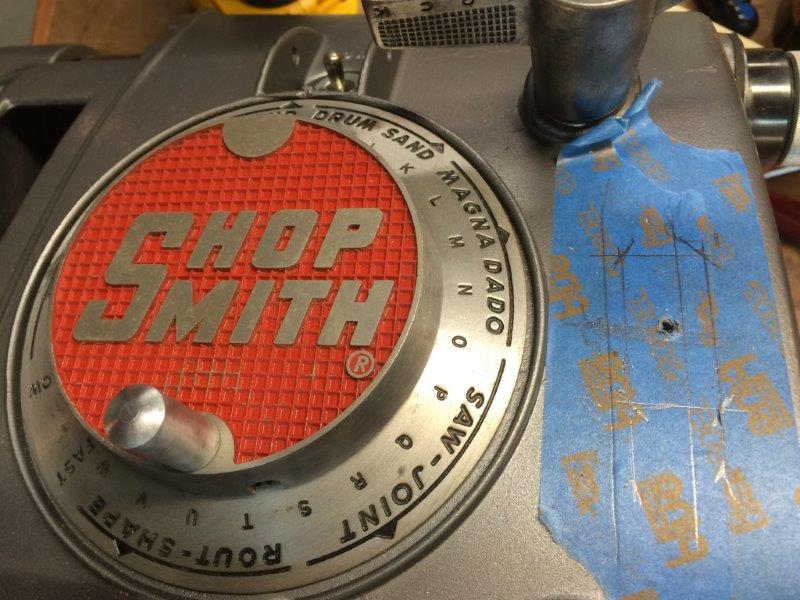

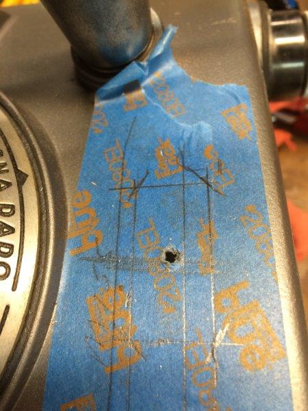

Here are a few pictures of the switch location I selected. It is out of the way and not likely to get bumped inadvertently. The wire routing inside the head is clear of the quill and quadrant movements.
- Hole Layout and start
- IMG_5141.jpg (51.95 KiB) Viewed 8064 times
- Switch is centered with the speed control
- IMG_5142.jpg (87.36 KiB) Viewed 8064 times
- Corner holes drilled. I used protection to keep the grindings out of the speed control and to keep me from scratching the face of the head with the dremel.
- IMG_5145.jpg (42.48 KiB) Viewed 8064 times
- Hole finished, wires pulled trough ready for switch.
- IMG_5147.jpg (77.47 KiB) Viewed 8064 times
- Finished switch install
- IMG_5149.jpg (50.55 KiB) Viewed 8064 times
